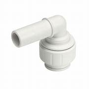

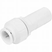

I have bought speed fit couplers (10mm to 15mm) to connect to my new radiator valves. Will these work with compression fittings?
What couplers did you buy? is it these?
or these
If so yes they will work with the compression end on the valve
