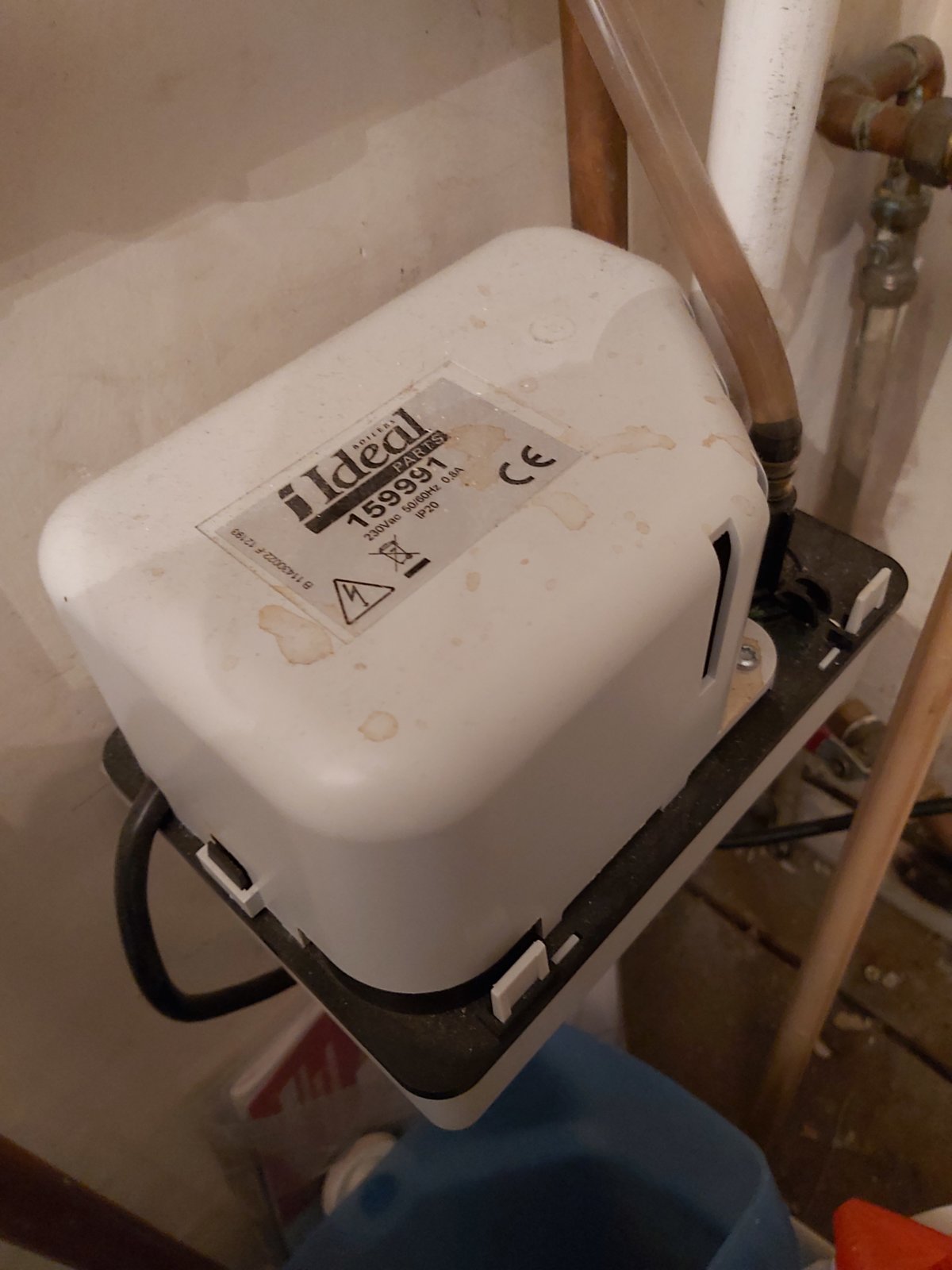

I have bought a HIVE thermostat 'single channel' and I allocated today to change my existing thermostat over. I have taken cover off and I can see that the boiler pump is wired on to it also. Which complicates things a little. Can someone tell me where L1 and LX goes on the HIVE connection plate?
Existing Information:
Thermostat - BOSS THERM BPS242RF
Boiler - Ideal LOGIC COMBI 24
Ideal Pump - 159991
If you just are exchanging the old thermostat for the new one, just move the wires from the old thermostat receiver to the terminals at the Hive Single Channel receiver that have exactly the same function. Leave all the other wires including the condensate pump connected exactly as they are.
Wire now in N to Hive N
Wire now in L to Hive L
Wire now in L1 to Hive 'Heating ON'
Wire now in Lx to Hive 'Common'

Thanks for the clear info Stem. I have brown sleeve in the garage I will swap it over.

All swapped over now and working a treat thank you.
