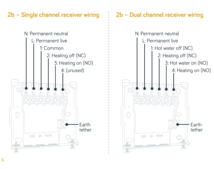

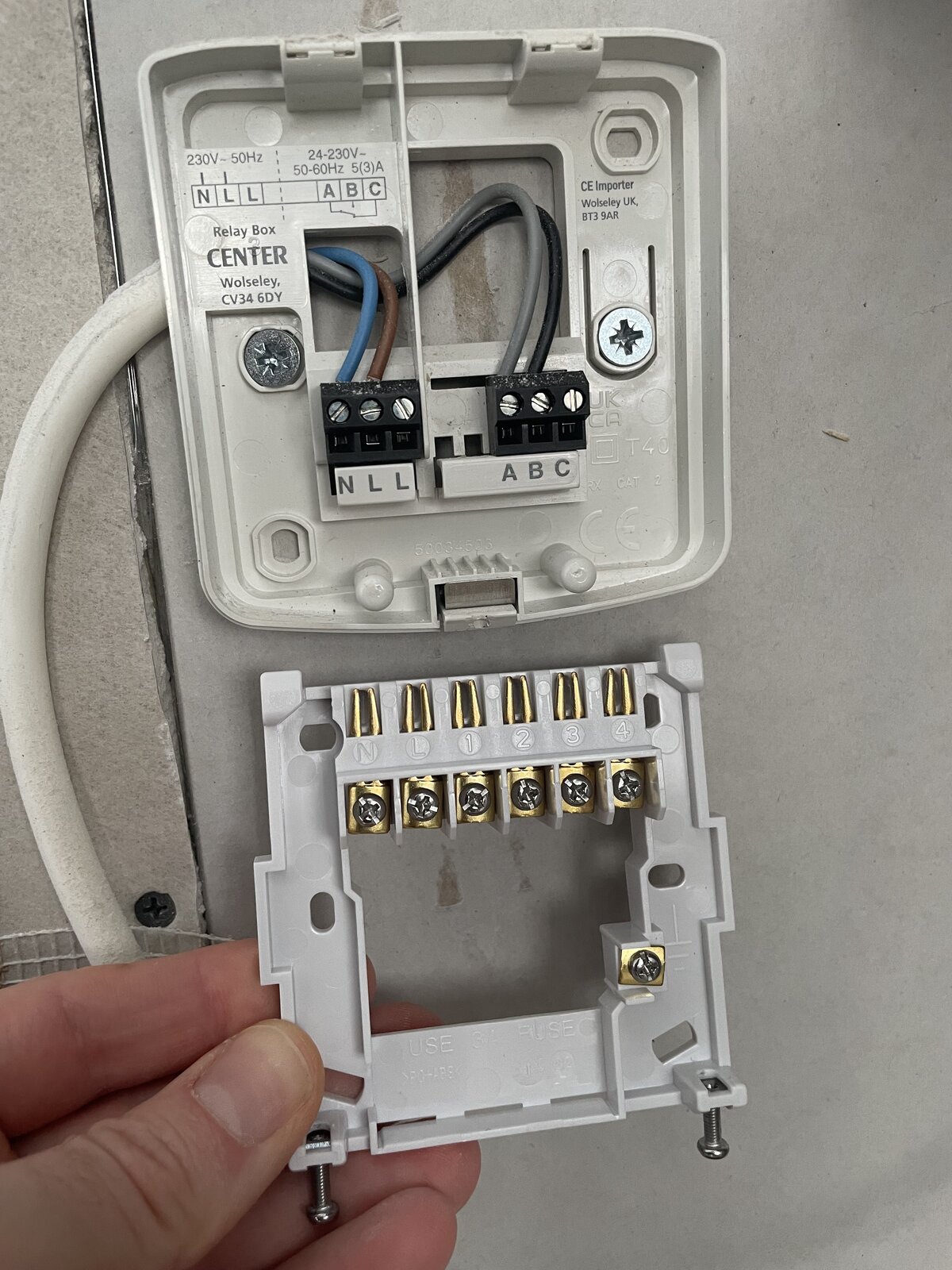

I’ve decided to try a Hive thermostat due to getting frustrated with how basic my old one was. Could anyone advise on connecting this using the same wires as the previous receiver. I don’t really want to mess around with the inside of the boiler.
I found another thread on here which puts grey into 1 and black into 4.

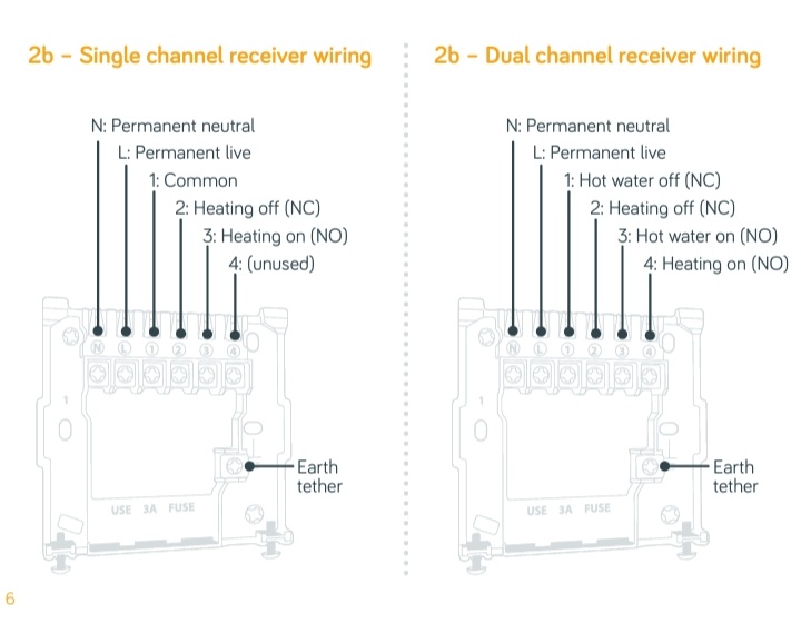

Assuming you have a single channel Hive - not quite, grey into 1 and black into 3! :)
Just wanted to say thanks for the help. Only got round to it today as I didn’t want to mess around with things while we had a cold snap. The Hive thermostat definitely seems to think it’s a degree warmer than it actually is. The decision now is whether I tell the missus that ;)
