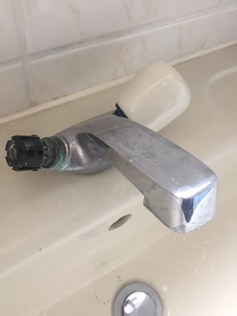

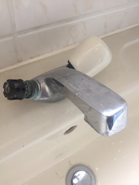

Hi
can i change the washers without turning the water off on this tap
I have no isolating valves in the bathroom and i didnt want to mess with my new combi boiler
thanks
Not hard on a combi. Set hot water to OFF on the boiler. Turn main water stoptap off. Run the taps til they go dry. Do the job. Turn water on. Run both taps til all air is out. Set hot water to ON.
