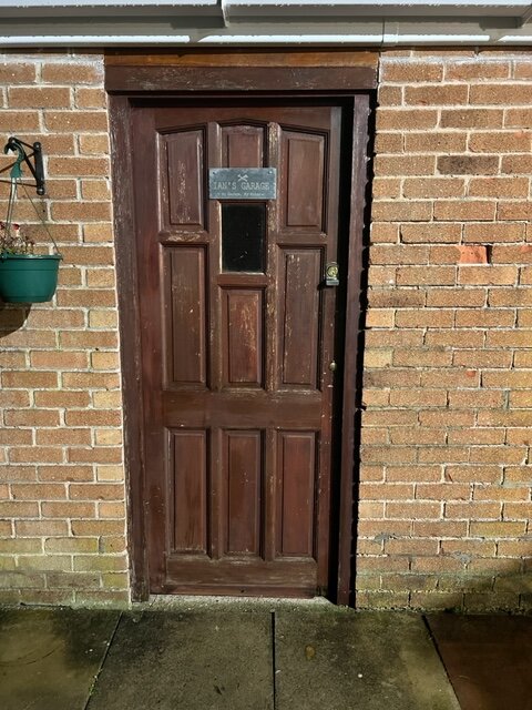

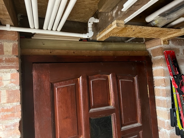

The wooden side door in our garage is disintegrating - i've already replaced the windows, but the door frame is supporting one of the roof joists in the centre of it. The door frame is 940mm wide; if i where to replace with a UPVC door will i need a lintel above it or will the frame be strong enough to support the weight? it's a 6.5x4.5m garage, with an OSB and fibreglass coated roof. there are actually two wooden beams across the top of the existing door frame to raise to the right height to support the joist at the moment, so i would probably leave those in place and screw the frame into them - it should be noted through that these wooden supports are not secured to anything except the door frame atm.
