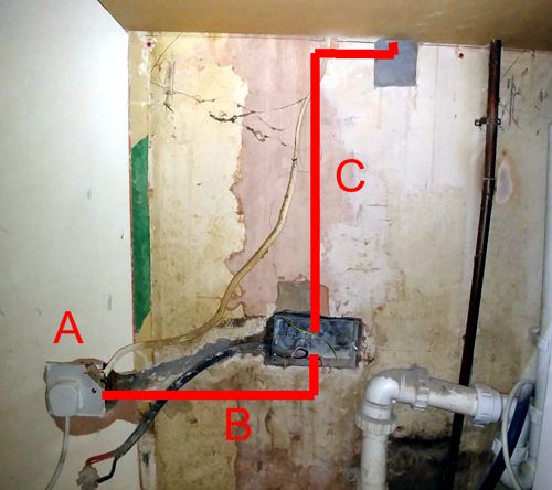

So I'm chasing out for a rewire. Reusing existing fittings where feasible, but cannot decide about this one.
New chase down to work surface done. Note the old cable going off diagonally at 7 o clock....
White socket bottom left i have reinstated as I found the ring main there hidden behind plaster with tape and choc blocks !!! and it is the easiest way of reusing the conduit which is in the wall.
Diagonal cables to back box....
Back box aligns with a cut out in the back of the cupboard which has been temporarily removed.
Diagonal dangling cable up to work surface...
Note the chase top right isnt going to align with the back box beneath and the washing machine pipe work is quite close.
So my question here is what would you do to tidy this lot up? I already know what the regs say.

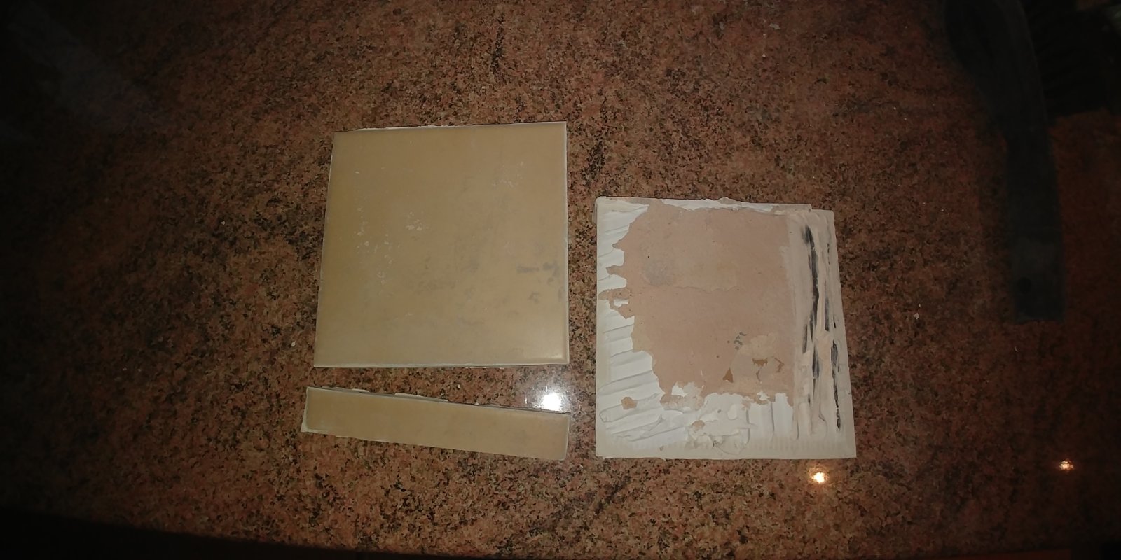

Ive so far managed to remove the tiles without breaking them and have no spares...!

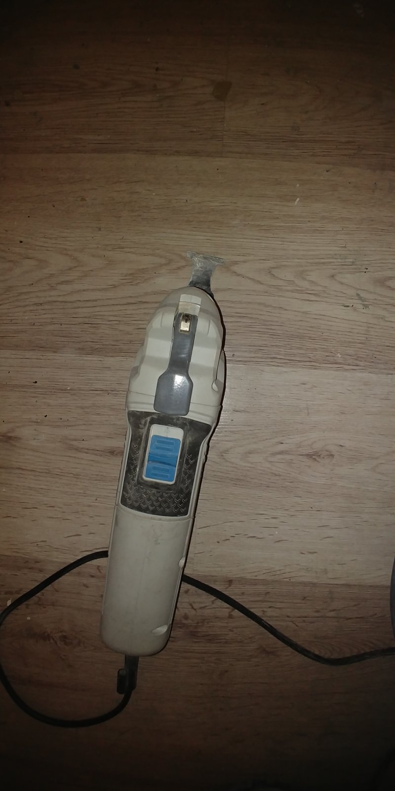

Nah they were stuck on quite well. Plaster is weaker than the tile glue stuff though. My tool of choice is a mac oscillating cutter which meant i could cut clean through the grouting and then cut down the back of the tile until i ran out of depth. After that a pallette knife and a hammer took them off.

I'm not sure what you really want us to say. As you presumably know, those diagonal cables are a definite no-no as far as regs are concerned (relatively sensible regs in this case!) but, if you know that, but don't want to address it, I'm not quite sure what else you would like us to talk about. Do you have any other specific questions?

I just cant decided on the neatest solution.
so do i:
Move the white socket up a few inches and line it up with the dual gang socket?
move the dual gang socket right a few inches to align with the socket above but then adjust the plastic waste pipe (not difficult to move right)
Move the dual gang socket down a few inches to line up with the white socket
Leave all of the fittings where they are and wire in straight lines recessed in the walls in conduit (I prefer straight runs personally...)
Dont bother and clip direct since it is all (except white socket) behind a cupboard anyway.
Or another idea perhaps?
I just cant decided on the neatest solution. so do i:
[with my added numbering!]
1...Move the white socket up a few inches and line it up with the dual gang socket?
2...move the dual gang socket right a few inches to align with the socket above but then adjust the plastic waste pipe (not difficult to move right)
3...Move the dual gang socket down a few inches to line up with the white socket
4...Leave all of the fittings where they are and wire in straight lines recessed in the walls in conduit (I prefer straight runs personally...)
5...Dont bother and clip direct since it is all (except white socket) behind a cupboard anyway.
Well, if it were me, and I was wanting to minimise the amount of work, I'd probably certainly do (5) and then, if I wanted to be decent, also (1) ... whereupon, if I understand correctly, everything should be regs-compliant and it would all 'look neat' .... or am I missing something?

A could be changed to a double to provide more space behind for wiring.
Cable B recessed so it doesn't show. 2 cables if it's a ring.
Cable C surface clipped, as it's in/behind a cupboard so not much point in it being recessed.

I think i will do 1 and 5. Move the socket up a bit, align it with the 2g back box. Clip direct upto where i stopped chasing, continue upwards in conduit.

You're welcome. As I implied, in your situation that's almost certainly what I would do.
