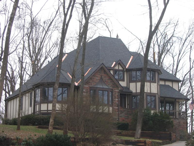

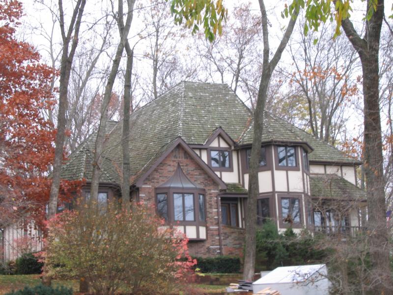

As you are well aware of roofer tales are a dime a dozen and always thrown out for free too.But I have been known to shovel a roof not exceeding 7/12 of snow so we could work. The max I have cleared was 43sq. and it was a 5/12 and had about 8" of snow. It was the only house in the whole area (obviously) with no snow on the roof..It was quite comical.This roof is my pride and joy and it was finished after
a massive ice storm.,alot of my equipment was smashed and destroyed by trees,but luckily the roof was sparred.
