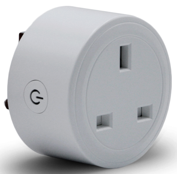

Even some rather simple looking devices, cause one to ask questions, for example socket-adaptor.jpg this may be safe used to switch on an outside light, but connected to a fire, so it can be switched on remotely, that is very different, and I would not want to put my name down to have tested it, as it could be very dangerous if used for wrong equipment.

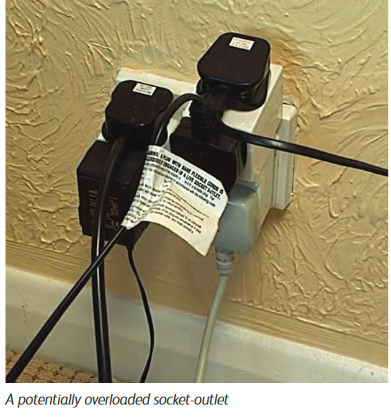

However can't see any landlord paying to have tenants stuff PAT tested. I have questioned thinks like this socket.jpg in the past, the electrical safety council say its a fail, but to me nothing to do with inspection and testing when sockets are overloaded, this SocketProtectors_large.jpg is the other one, I would unplug them all and then give them back to client, for them to bin, as to Europe adaptors this one upload_2021-7-14_0-9-22.jpeg seems about the best, fuse, and earth connection plus hold the plug firm, but I hated inspection and testing, my PAT testing machine would test the socket outlet first, and it had set times for all the tests, so it was really slow, but at time top of range Robin, trying to explain why it took so long was hard, when with a little cheating one could show 200 items a day, my tester lucky to get 50 items following the rules.
