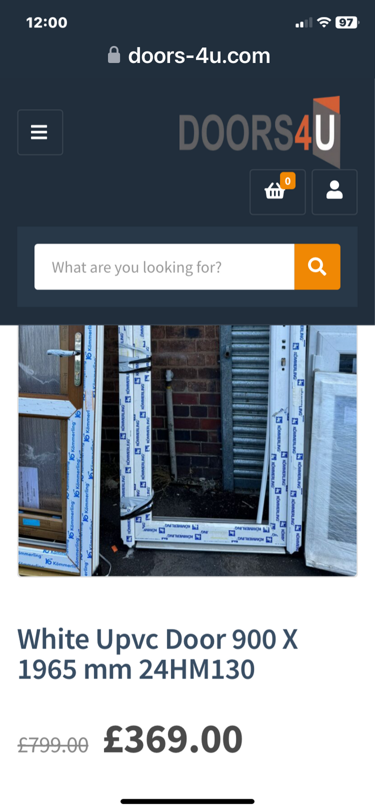

Found lots on line to fit here’s one.
Thanks. I wonder why I didn't find any? Also I should have said, mine needs to be outward opening and ideally not have any glass panels, or at least any glass panel big enough for a human to fit through after they've smashed it!
