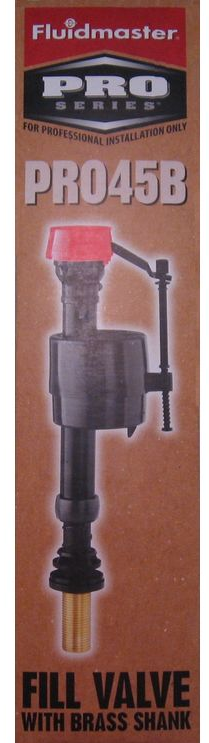

The Fluidmaster Pro45B brass shank fill valve has an anti-siphon / backflow design which prevents contamination (according to adverts).
Is this sufficient, or does a double check valve additionally have to be added to the 15mm supply pipe? Thanks.
No check valve is required when the fill valve is fitted correctly :idea: or on domestic installations.
Why would consider a check valve ?
