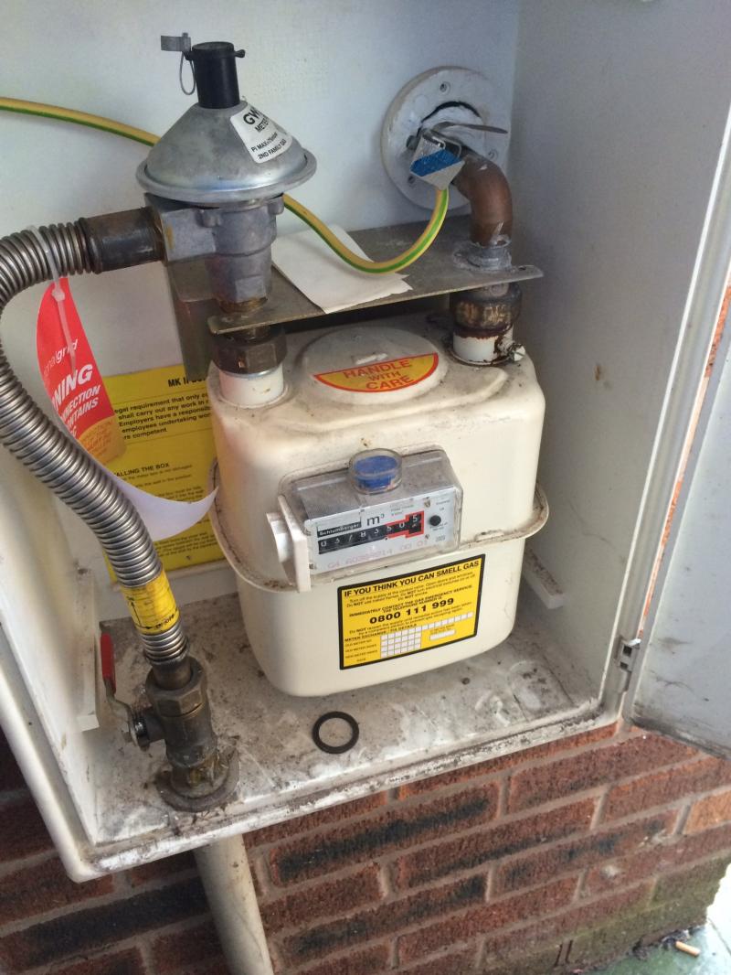

Is it possible to check the gas supply capacity in advance of fitting a boiler?
A site currently runs electric storage heaters from a 100A 3ph supply. (70KVA)
The site has a U6 gas meter (6 m^3/hr nominally; previously only used for gas tumble dryers) and we'd like to convert to gas.
Maybe the supply from the main can flow enough gas to deliver 6 m^3 @ 21 mbar after the regulator. Maybe the supply from the main can't.
-How is this checked prior to deciding to install boilers?
-Who checks it?
-Is there a service level guarantee on a gas supply? (are the distributors obliged to deliver 6m^3/hr; who pays if not?)
Thanks,
