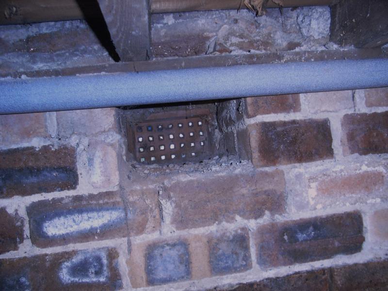

We recently bought a house which had had a survey carried out by timber restoration company ( The experts)
They condemned three of the room floor as having wet rot, plaster was to be removed and replaced to a height of 4 feet and a chemical DPC was to be fitted. Cost £5000.
In one room it was perfectly obvious to anyone that a number of joist ends were rotten as the floor had dropped 1/2 inch below the skirting board. I measured the moisture in the plaster ( lathe and plaster) and found this to be high.
Checking around the house I found that the lawn level had been raised against the back wall. This should be 150 below the vent. Apart from the splash the long grass in summertime would inhibit passage of air into the vents. Checking under the floor ( 3 feet clearance) I found that the vents were totally blocked. Also the passage of air from the solum up the cavity behind the lathe and plaster.
Also I admit I have been sceptical about the phenomenom of moisture rising up through brick walls but I think this photo shows the DPC working effectively. The brickwork below is damp but the bricks above are clearly dry.
I have now cleared all the vents, lowered the lawn back 300 from the wall and replaced the joist ends in one room together with the infected floor boards. Cost £65 . The walls are now showing normal moisture content.
NO IT DOES NOT!!
I have just answered my own question.
The problem I had was at the back of the house. This photo from inside the solum is of the front wall where there is no problem.
Since there was no problem I did not bother to check any further. Now I have just noticed that the ground is level with the DPC. Therefore it stands to reason that the bricks below that level would be damp but it does not prove that if the DPC wasn't there the courses above would be dry anyway!
