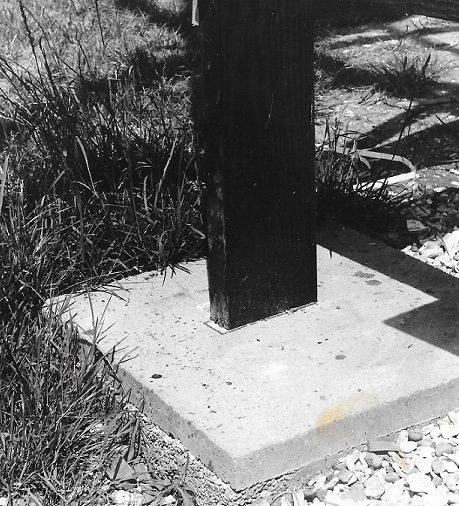

Free standing on 4mm lead sheet, this photo was taken in 1980 and the timber is still in perfect condition 39 years later. ( the lead was trimmed to the exact size of the post afte the phot was taken.

Bernard, was it black and white in 1980?
The picture was taken by a photographer who was taking photos for one of the suppliers we used. ( The house was a full DIY self build )
