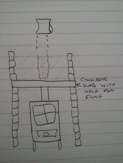

I moved into a house a couple of years ago that had a wood burner in the living room. A new header was installed in the breast with just a hole in the middle for the flue, and then the piping/lining all the way up to the top (at least, that's what the previous owner told us, and that "...it would never need swept.").
Anyway, we recently removed the stove as it was dangerous, and we have got a case iron open fireplace as a replacement. However, when we lit it, there was a pretty poor draw, and some smoke coming back into the room.
What I want to know is, could this be because of the stove header/lining having an insufficient hole for this type of fire? If so, is there anything short of replacing the header and removing the lining, or installing a chimney fan, that we could do that would help the draw? Also, the chimney isn't capped (which is something I will be doing to all of them in time), and we may have a birds nest, but I just want to ascertain that the header isn't a problem before tackling this as the sole problem.

@geraldthehamster: We don't have a register plate, it is a concrete slab with a hole in it for the flue, that was sealed with fire cement. This slab seems to support the chimney also. I have attached a (rather crude) drawing of what it looks like.

Is the concrete slab part of the original fireplace construction? What sort of fire was it built for?

From the sound of it the fireplace is currently unsuitable for an open fire.
First of all is the flue big enough? Extract from the BFCMA guide
"it is recommended to have a minimum internal flue size of 185mm square of 200mm round, as this size is suitable for most solid fuel burning appliances and also gas fires.
These are the minimum sizes for a flue above a fireplace recess or for an open fire with an opening up to 500mm wide by 550mm high. For large open fires, such as inglenooks. dog grate installations or special appliances I stoves designed to operate with a fire opening greater than 500mm x 550mm. the flue size should be between 14% and 16% of the free unobstructed area of the fire opening"
Next is the opening itself suitable? Again an extract from the BFCMA guide
"For open fires a suitable throated front lintel and gather must be provided above the fire opening, so that the front, back and sides slope up smoothly into the flue opening in the chimney at an angle no greater than 30 degrees from the vertical. Avoid flat surfaces or shelves which can cause turbulence"
Obviously the flue needs to be free of obstructions as well.
Finally check that there is an adequate supply of air
"As a guideline a permanent air vent with an opening or openings giving a total free area of at least 550mm2 per kW of rated output above 5 kW must be provided for open fires. Generally the same size of ventilation is used for room heaters or stoves, but always refer to the appliance manufacturers recommendations and Building Regulations.
This is important as air starvation will cause poor combustion and create problems similar to down draught and spillage of smoke and fumes back into the room, which can be unpleasant and dangerous. "
You have a concrete raft lintel, which is not suitable for an open fire as it stands.
However you can adapt the opening with precast pieces.

@Richard: The house was built in the 1890's, but with the current concrete raft lintel it has been altered for a stove. I have seen the original metal headers that the fire places originally had, as our dining room one is still present (since been blocked up, but we got it replastered so had it back to the brick).
@Stuart: Yeah I was worried that the current setup was unsuitable. I didn't realise that you could buy precast pieces. I always thought that there needed to be some sort of funneling type of adaptation to angle any smoke to the hole. Would you have any links to products, or names of parts that I could search for?
@Architexeter: The actual grate of the fireplace is quite small so the majority of the fireplace is decorative rather than functional, if you know what I mean. We have quite high chimneys with no trees nearby. I'll get researching ways to play with it.

You need to buy a precast concrete throat unit with a removable front, and a fireback.
Build a couple of brick piers to hold the throat unit. Fill in behind the fireback with vermiculite/cement mix.
