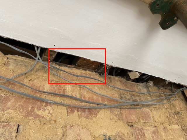

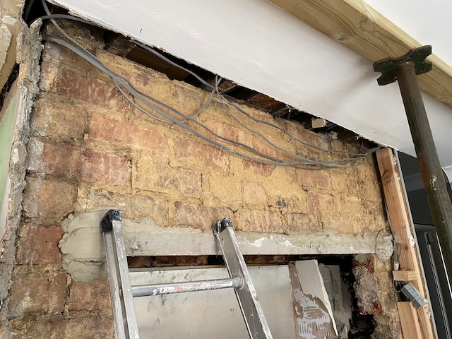

Hi,
I'm looking to remove a downstairs chimney breast and a little bit concerned if the chimney breast itself is supporting the floor joists. It's in the kitchen (Victorian house) and used to contain the kitchen range so is fairly substantial. Hopefully the photo shows the position of the joists "sat" on the brick work (ignore the wiring - this will be tidied up!). All apart from one of the joists are are fixed into the wall as well as supported by the chimney breast.
All the chimney beast above this had previously been removed.
There is also one joist that is positioned on its side (marked in red on the photo) - this is sat on an old floorboard on the chimney breast but is not attached to any floor boards as it's not high enough. Not sure what the purpose of this is and don't understanding why it's supported by the chimney breasts.
Had a structural engineer take a quick look (he was looking at another project at the time) and he only mentioned about the short joist.
Ceiling is currently propped up with one acrow prop.
Most of the similar houses on the street have also had their kitchen chimney breast removed but now sure what additional support (if any) they put in place.
So, my questions is - am I safe to remove the chimney breast?
Many thanks!
