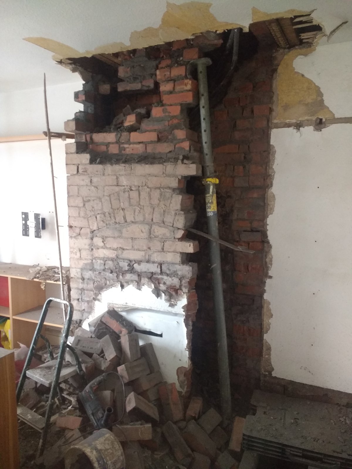

I've just done one of mine, generally most of it can be dismantled by hand without touching the party wall (I just use a masonry drill to clear the mortar out of the joints)- leaving the bricks that tie the breast to the party wall sticking out. In my case there was about 40 toothed in bricks (you can see them snapped off in the picture) - mine are rock hard Accrington's and I drilled 3 holes through the middle of each brick with the SDS then I gently chiseled them with the SDS and they snapped off. Any bits sticking out I remove with a diamond blade in the grinder.
Once it's out make sure it's cleaned up and sealed/rendered with SBR or something or the soot will come through forever, also make sure they maintain/reinstate whatever dpc is on the ground floor.

Hi, SDS is just a big hammer drill with a chiseling function. SBR is a tanking/water proofer - your builder should have his own preference but just make sure he uses something, I try and get a couple of coats of slurry on. Personally I don't like dry lining but a lot seem to prefer it these days - if your chosen builder wants to dry line it I believe it should be foil backed plasterboard screwed to battens fixed to the wall - if it's dabbed on the soot will come through. It will take someone cleverer than me to explain how the soot comes through!
