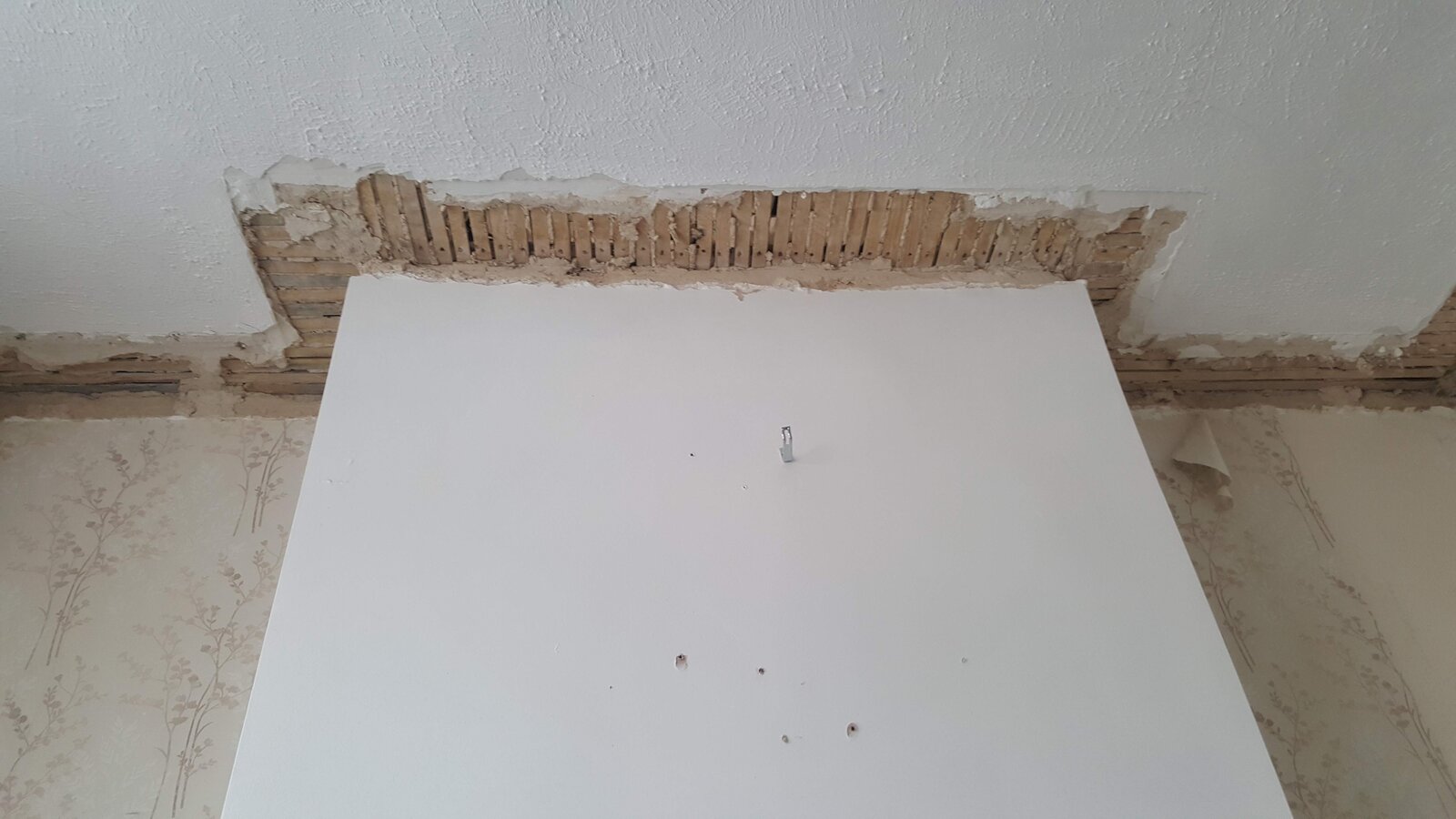

I will see what I find when I start digging :sneaky::), currently is all covered on first floor and cannot see from below due to the laths

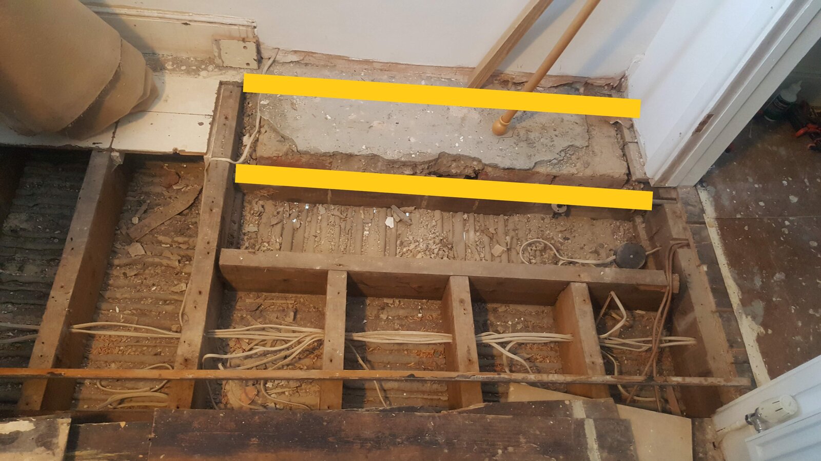

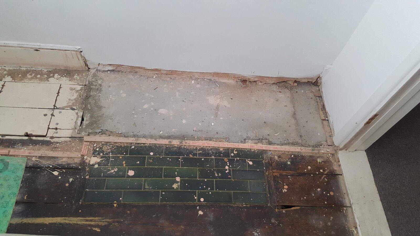

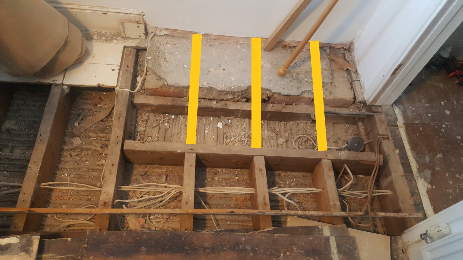

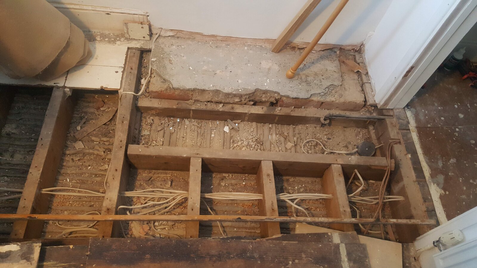

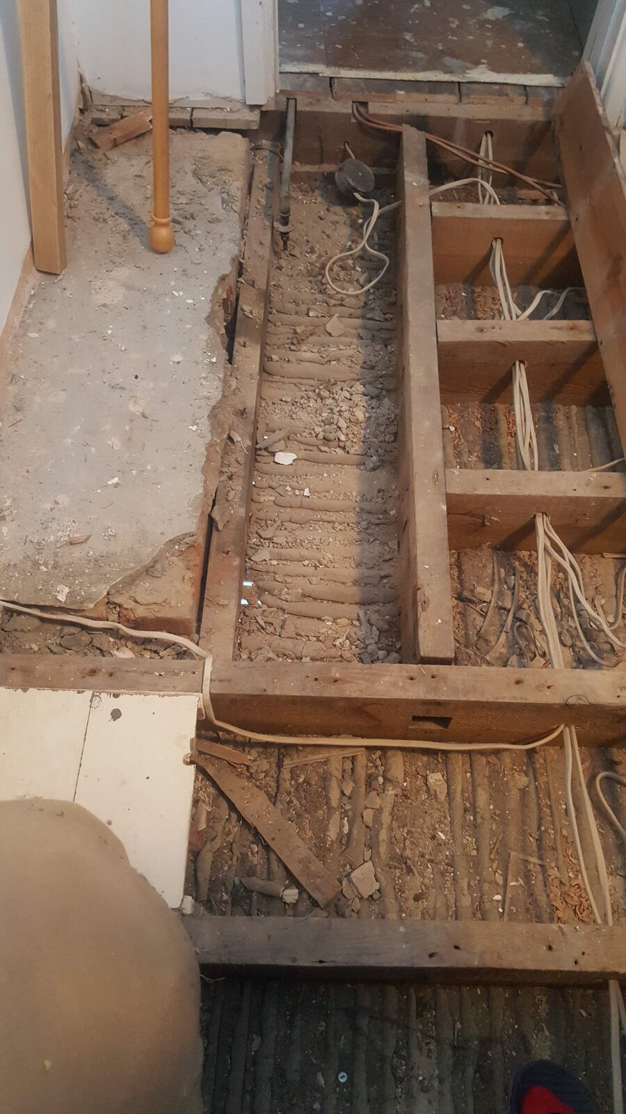

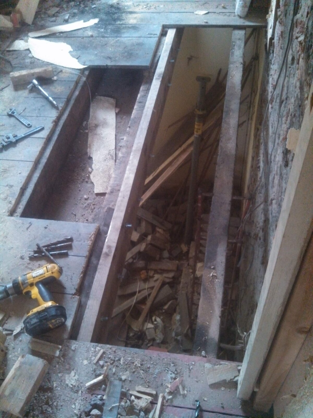

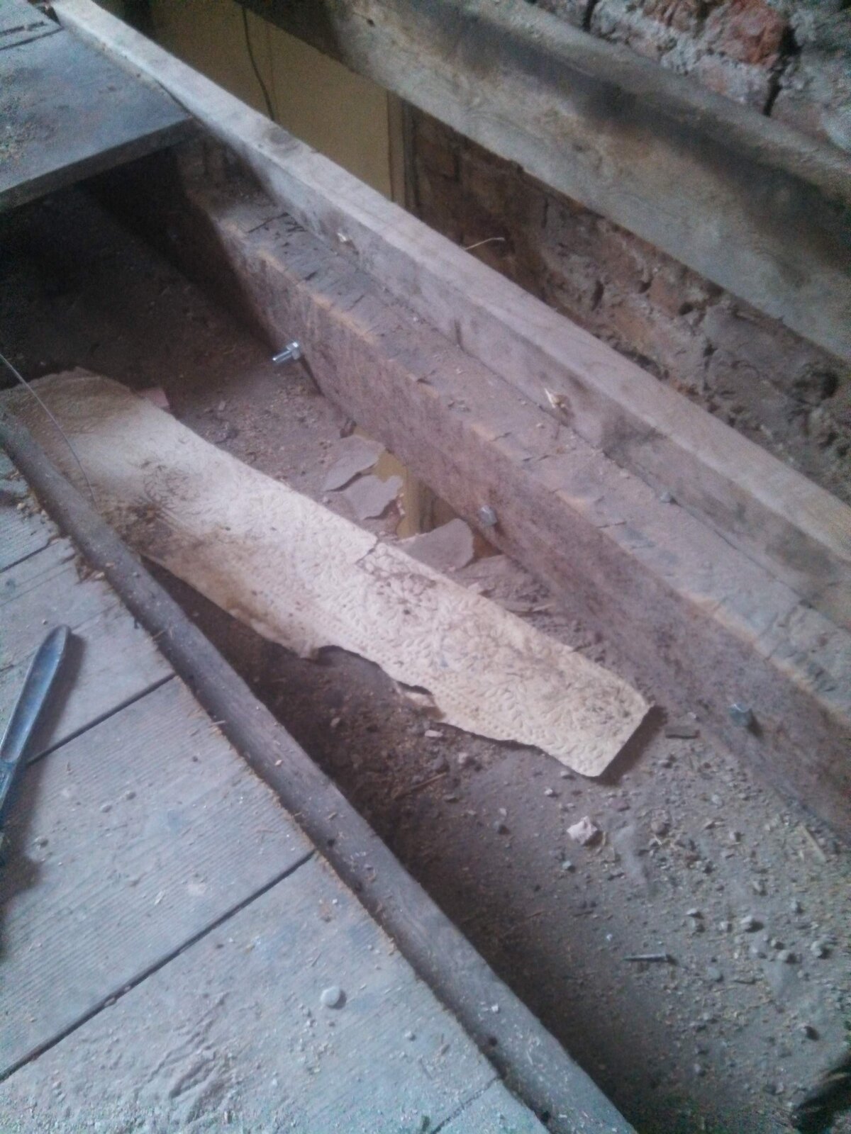

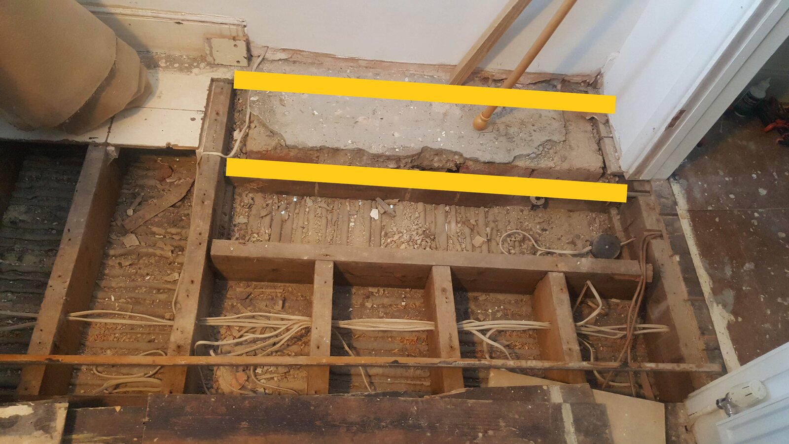

Hi All. Finally managed to get around and remove the floorboards and break down the tiles that were in front of the old first floor chimney.
Seems that my initial plan with overlapping joists is very unlikely due to the amount of electric cables that go through the joists (n):(.... so I am back to joist hangers.
The distance from the party wall to the trimming joist is 700mm (27 1/2") and as in the pics goes across 3 joists with 30mm (12") between them.
Would you:
- extend the joists between the trimmer and the party wall x3
- make 2 trimming joist parallel with the party wall
Notes: the pipe is redundant and will be removed. On the right side there are 2 joists next to each other under the timber wall that goes to the loft, nothing underneath(on ground floor)
Just one new joist against the wall, hung off the trimmers, build up the shallow one to take the new flooring, it's adequate for that short span.
