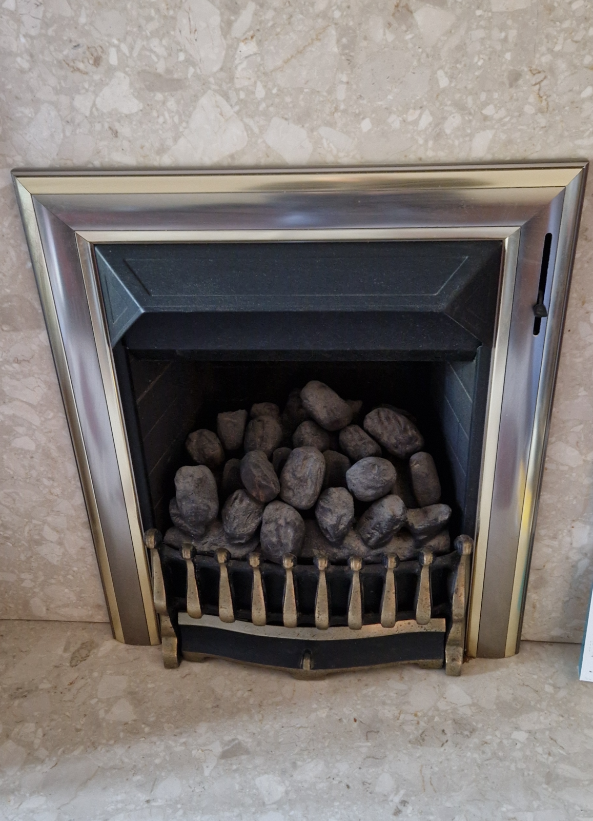

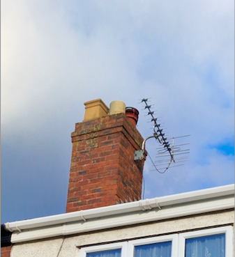

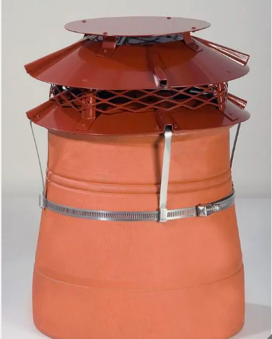

Hi, I have a Valor Visage Gas fire and looking to replace the chimney cowl due it being corroded and rain coming down the chimney washing the soot down. I'm confused about the UFO cowl if it can be used with Gas, i've been told it can't be used by one supplier but have seen it advertised on the web usable with gas. can anyone clear this confusion up for me.
Have attached the following photos if it helps.
Valor Visage Gas fire.
Chimney pot to be fitted to.
UFO Cowl.

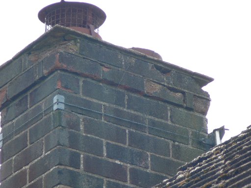

I have a low power (7Kw) Airflame gas fire. It has no liner and it was fitted with a cowl very similar to what you are suggesting although seemingly with more exhaust area. It has been inspected by a gas safe engineer and no adverse comments. Ask your supplier what's supposed to be wrong with that cowl and ask for documentation that says it cannot be used.

How certain can you be that the only cause of water entering the flue, or the stack brickwork, is a failing metal cowl?
Water staining is showing on the outside of the stack which suggests that the flaunching has perished as well as the in-place cowl?
Your other chimney pot is open. Is the fireplace & flue to that pot still in use?
Have you been in the loft & examined the loft chimney breast for water stains?

OP, your best bet would be to post some Pics showing the pot & flaunching on the top of the stack?
It would be in your neighbour's shared stack interest as well.
Says its suitable here.
What actual pot on the chimney is your fires ?

The issue with soot washing down suggests to me that degraded flaunching is more likely to be the cause - you'll probably need a roofer to get up there and inspect. (Drone pics might be an alternative)
