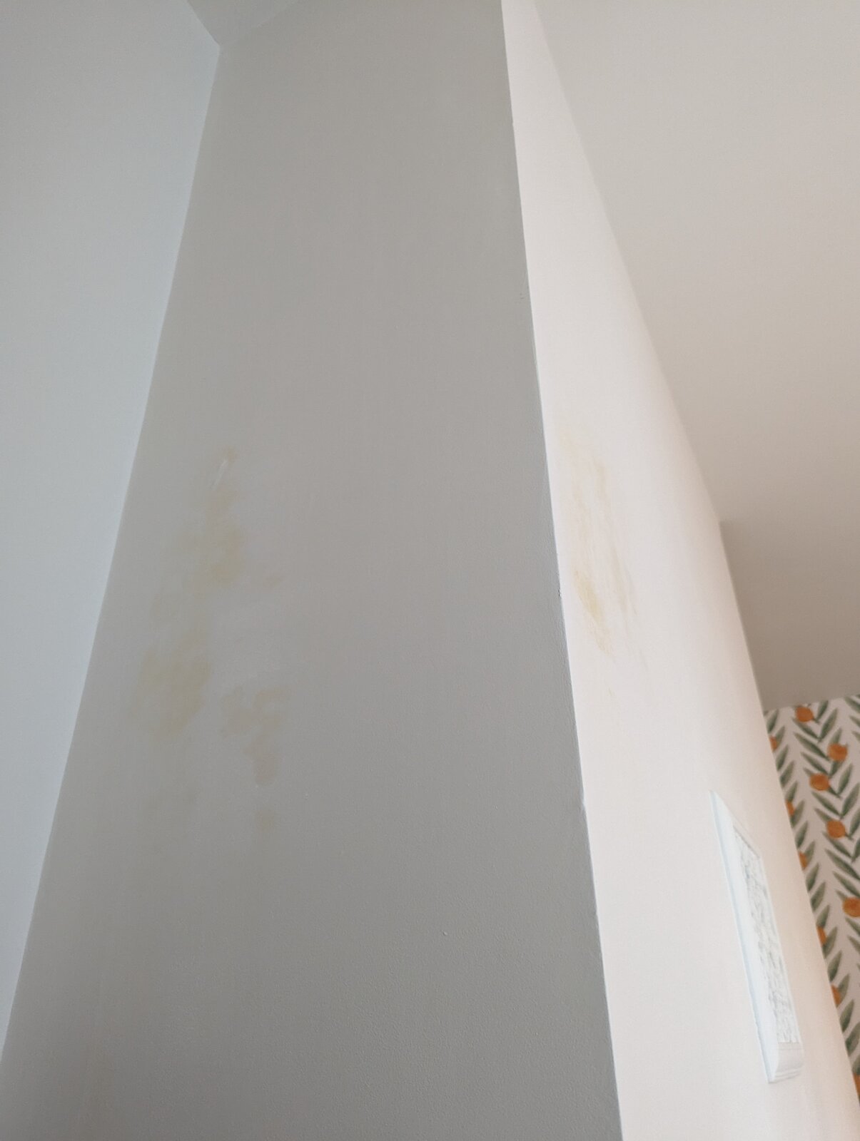

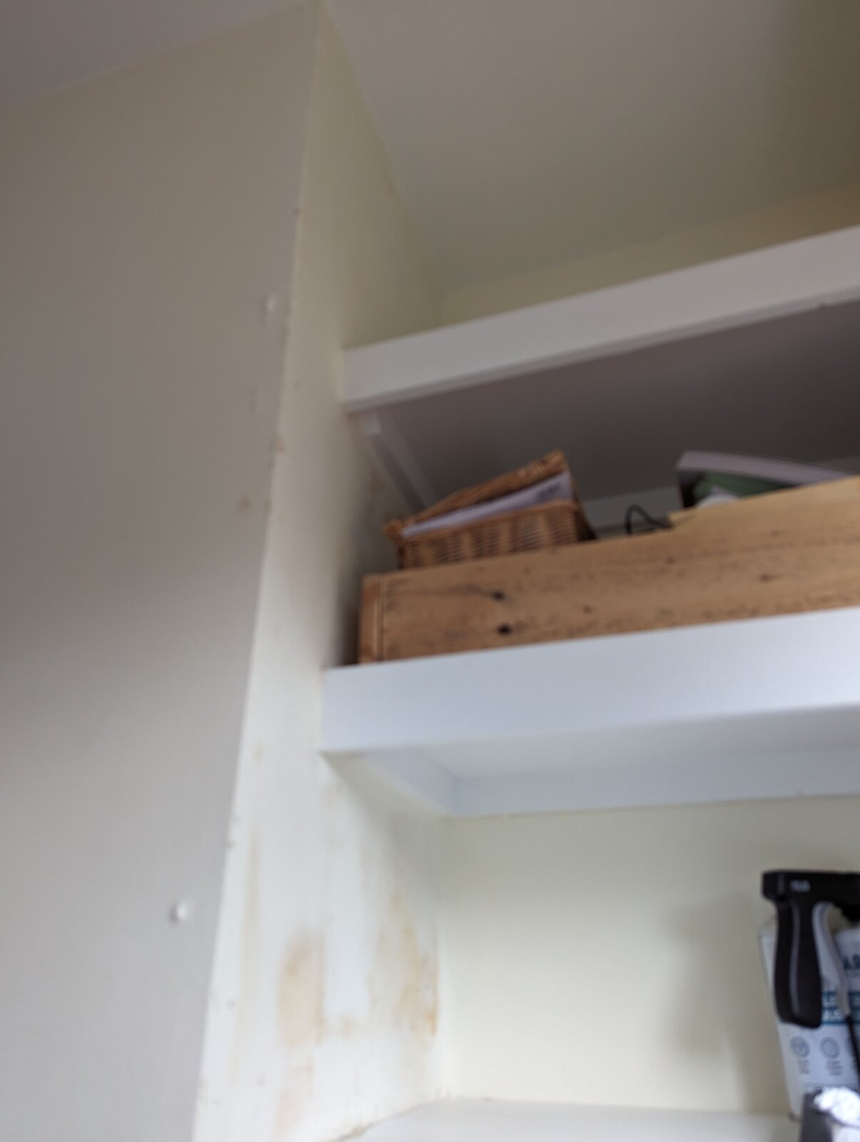

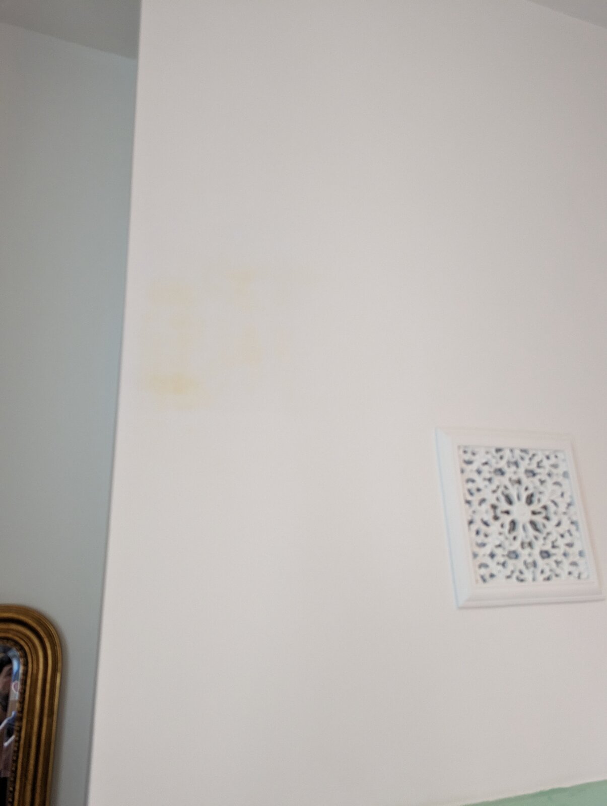

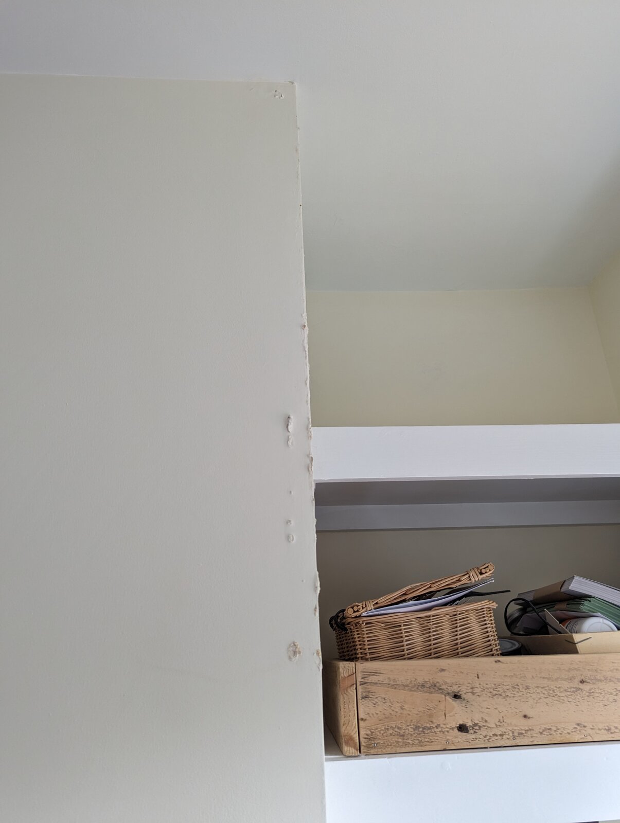

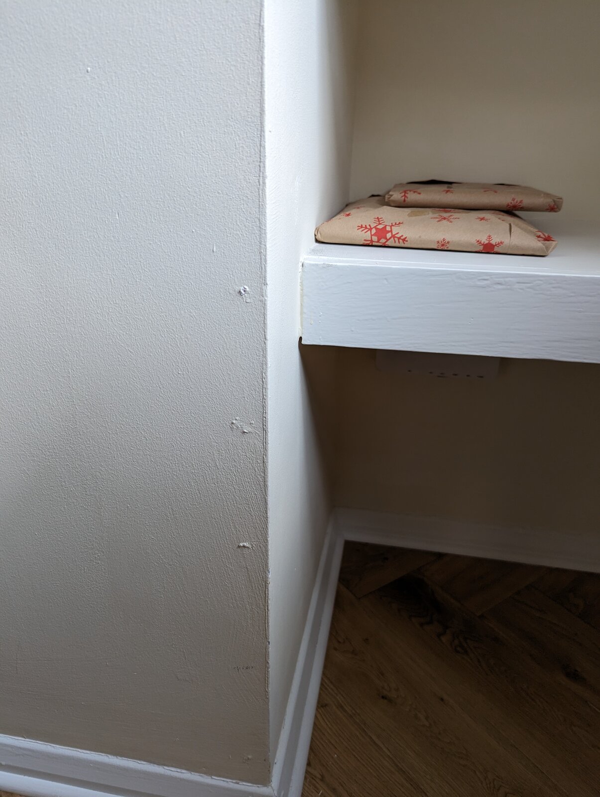

Thanks in advance for helping. Basically, as can see from photos, we have damp patches on our chimney stack. It's out of use and tops have been capped few years back (before our time).
You'll see from photos damp is in 2 rooms, that are back to back, and share the chimney stack. 1 of the rooms is an extension (room with shelves) to main building and we're not sure if the damp is caused by stack condensation in both rooms or possible the flashing that connects the annexe to main building has issues and water getting in. The damp is at the same height and place on opposite sides of stack. In 1 of the rooms you'll see a vent, we had this previously core drilled as we had a damp issue collecting in cupboard built-in to the old fireplace, and were told ventilating would solve that.
Cheers for your help.
J

Thanks both for replying @opps @mcprinter ! Along time, but an update that it turns out we had a leak, which could have been for a year or so, on the channel which sits above and between the 2 rooms in the photos (one is an annexe to main building). We also vented both chimney at the bottom.
Water was seemingly coming in to the chimney stack and progressing down the shoulder of chimney flue that (we believe) each room shared.
The stain and blistering became a lot worse than in the photos. Now it's fixed, we waited about 6 weeks to dry out before redecorating but some stains and blistering coming through again (albeit much less), and worse on the thicker/bigger chimney.
Could this be because the salts are still doing their thing and sucking the dirty chimney moisture through? Or does it just take a very long time for old chimney bricks to dry out, potentially months?
