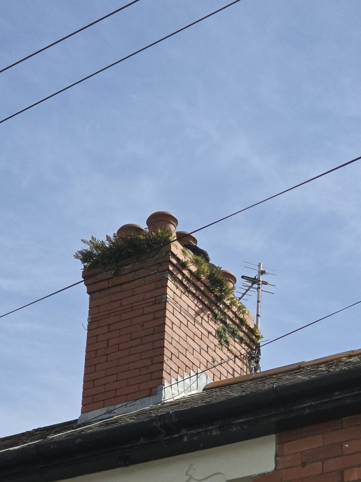

Discovered this in attic.
I'm assuming flash around chimney?
It's between me and next door as house is a semi. Next door said his attic is fine.
This tends to be bad during certain weather so I'd imagine it's a wind direction rain thing. Sometimes hardly anything during rain. A few house I've seen around here have the chimney removed replaced with pipes.
Obviously I need some quotes would this require scaffolding (some regulation?) Or will someone to go up on roof ladders.
Just speculating, thanks for any help

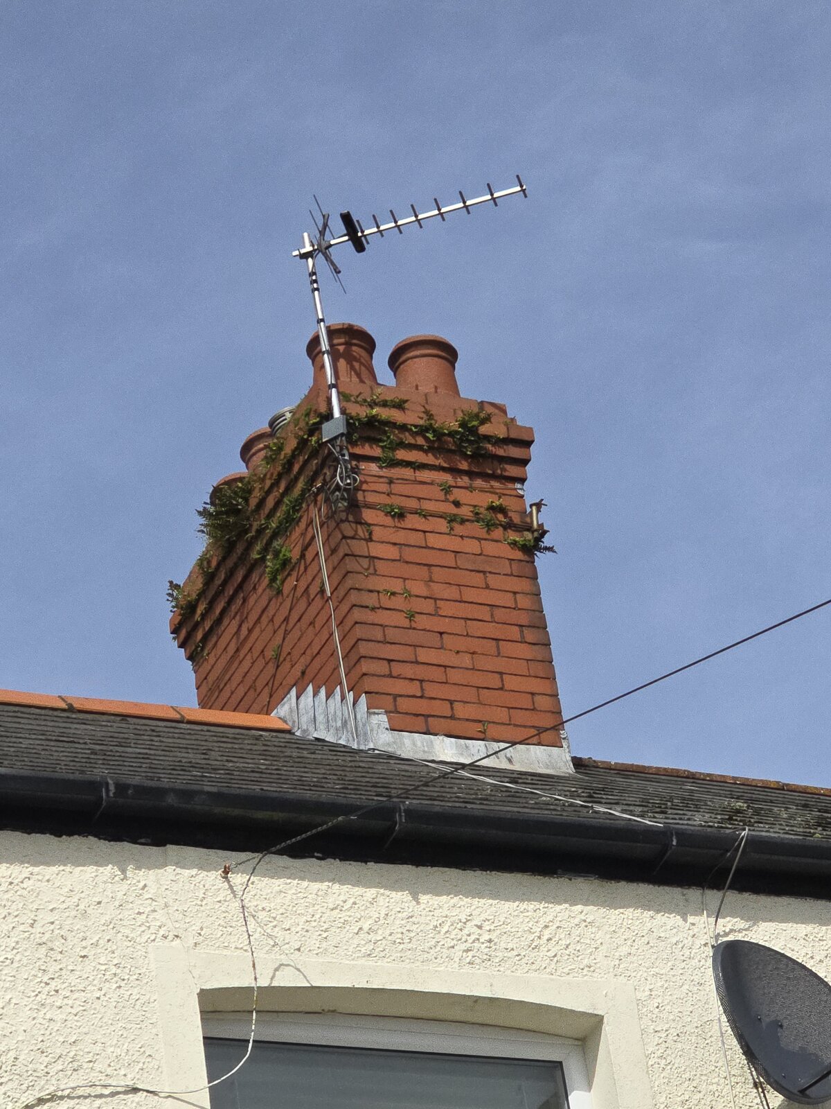

Few of back and 1 front. Not done neighbours side. To me look lifted bit lifted off slate at back and not pressed tight on chimney bricks. Prob hard to say without a good look?
Can't do flaunching really

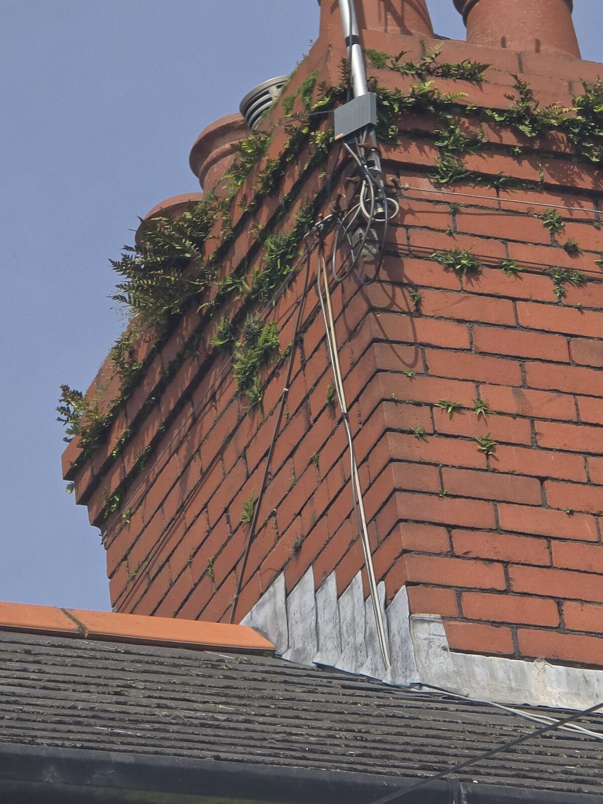

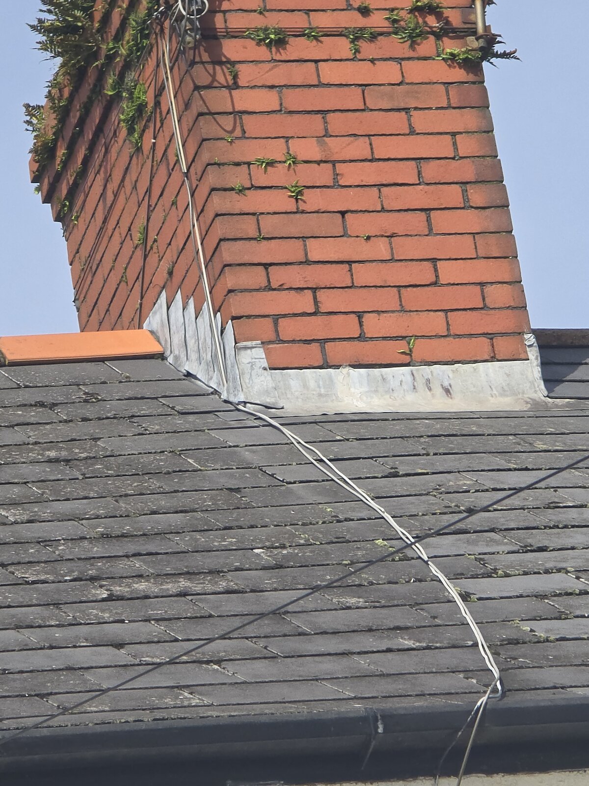

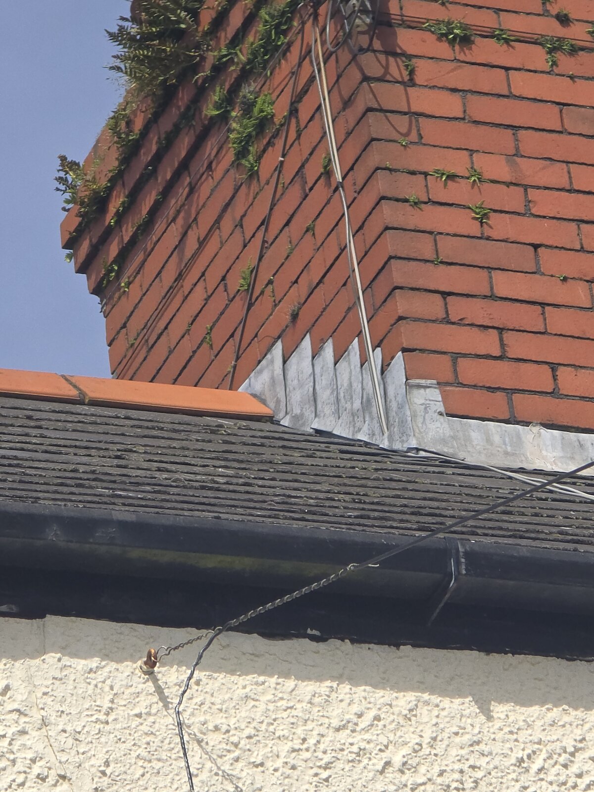

Thanks for the pics.The flashing looks to be in good order except that the stepped cover flashing comes down too far.
The flashing would need close examination from a position on the roof.
Look for individual soakers under each slate.
The pointing on the stack is very poor, and needs raking out to 25mm and repointing.
Lifting & re-setting the last ridge tile might help? Does the lead saddle go under the ridge tile?
The top of the stack is failing and allowing foliage growth - foliage will loosen brickwork. Its very probable that the flaunching needs re-doing.
FWIW: Your single skin, loft party wall doesn't need reinforcing - it needs building up to the underside of the roof.
Looks in reasonable condition, repoint the brick, the waters probably getting in through the stack, or maybe the back gutter.
What looks "in reasonable condition"?
"getting in through the stack" means what?
There is no "back gutter".
