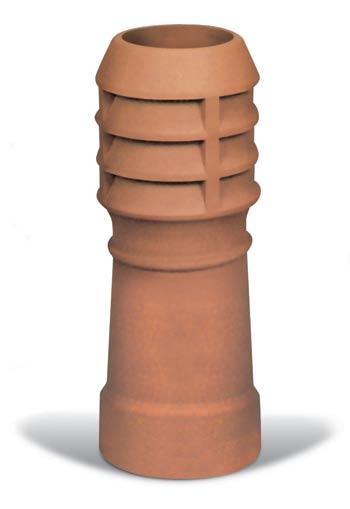

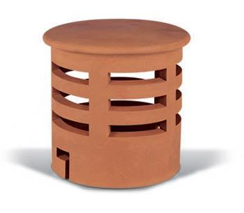

sorry went and looked and there is one there not sure what kind it is tho but it looks like it has slatts in it (if that makes sense?)
