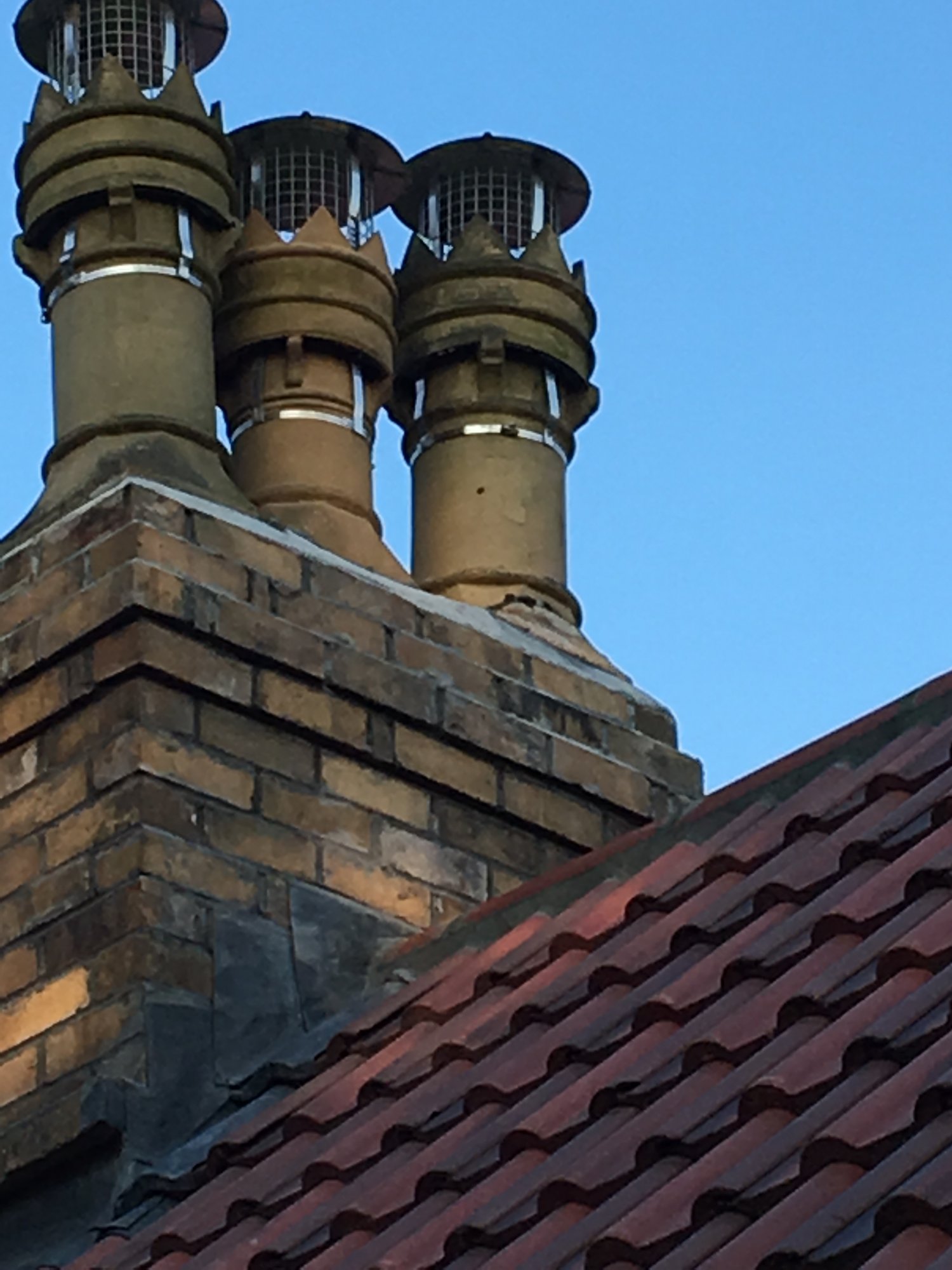

I live in an old house, mid 19th Century. Last summer, as part of roofing work, I had the two chimneys rebuilt (one was leaning, and in the other the pointing had failed so badly that a rebuild was advised). One chimney is in use with a wood-burning stove, and we had it lined. The other chimney, which has 3 flues, is not in use at all.
The builder said he would use a 4:1 sand/cement mix. I suggested a 3:1 mix to deal with weathering, and he agreed.
I have recently been told that given the age of the building he should have used a lime based mortar mix, with no cement. Is that right?
I can see that this matters with repointing; is the issue better or worse given it was a rebuild?

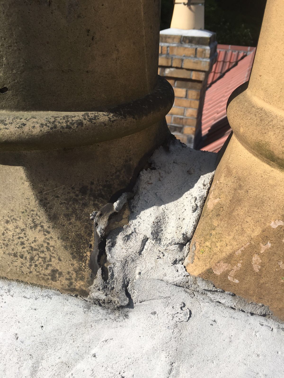

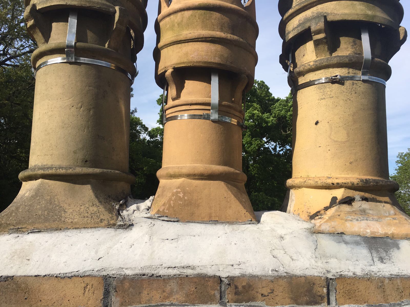

I've also been told his work on the flaunching on the 3-flue chimney leaves a lot to be desired. Here's some photos.
I am not sure whether any of this is a cause for concern (and I'm more concerned about the mortar mix than the flaunching) and if so, what I should do to remedy the problems.

Your chimney is now built using sand and cement.. Strong mix! What do you want to remedy? The untidy flauncing?

The untidy flaunching bothers me only if it could undermine the watertightness or could cause any other problem. Another roofer (a member of my family, not looking for work) said it could be an issue

If it is was part of a lime mortar wall then maybe. But the stack is distinct and has no relation to any other wall. Stacks can be built with cement mortar.
i think you instructed the 3-1 mix.. that is strong for the brickwork.
looking again , it looks like you have had some work done to the head of the chimney but doesn't look rebuilt?
one pot looks like its in trouble.

The whole chimney was taken down and rebuilt, for sure. Admittedly I wasn't around when it was done but I can tell, having seen how it was before.
The pot on the right of the photo isn't doing brilliantly, you are right; it probably should have been replaced as part of the rebuild, and I regret not saying something at the time. but I've gotten up close and it is not as bad as it looks, it has some old sealant on it and seems sound for now.
Ok yes I can see on my big screen the pot has sealant on it. Phone screen made it look cracked.
Well going back to the mortar mix etc, The roof has been re tiled using concrete interlocking tiles possibly Redland 50s. The original roof would not have been those.
So, where the original stack was likely to have been built lime mortar it is now built in S & C.
the flaunching is untidy. If its not causing an issue then what is there to claim for under the guarantee? But it might be good just to check thats not a hole next to the pot.

It all looks fine, the flaunching is a bit untidy and the pots could probably have been set a bit better, but otherwise it looks weathertight.

I might be concerned about the concrete roof tiles if the original was slate...there may be quite a weight issue on your rafters
Thanks for this. I appreciate the advice. Thankfully, we were advised of this at the time and we had the purlins reinforced as part of the work, so that shouldn’t be an issue.
Looks a poor job to me. The top course of bricks should house the pots. Here, they've clearly sat the pots on the top course of bricks and housed them with the flaunching. If they'd done work to that standard for me, they would not get paid. Needs re-doing.
