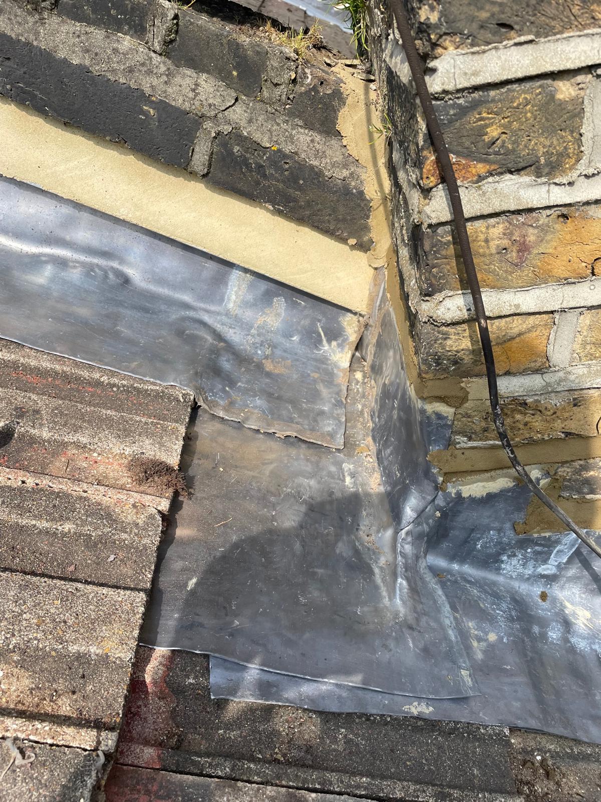

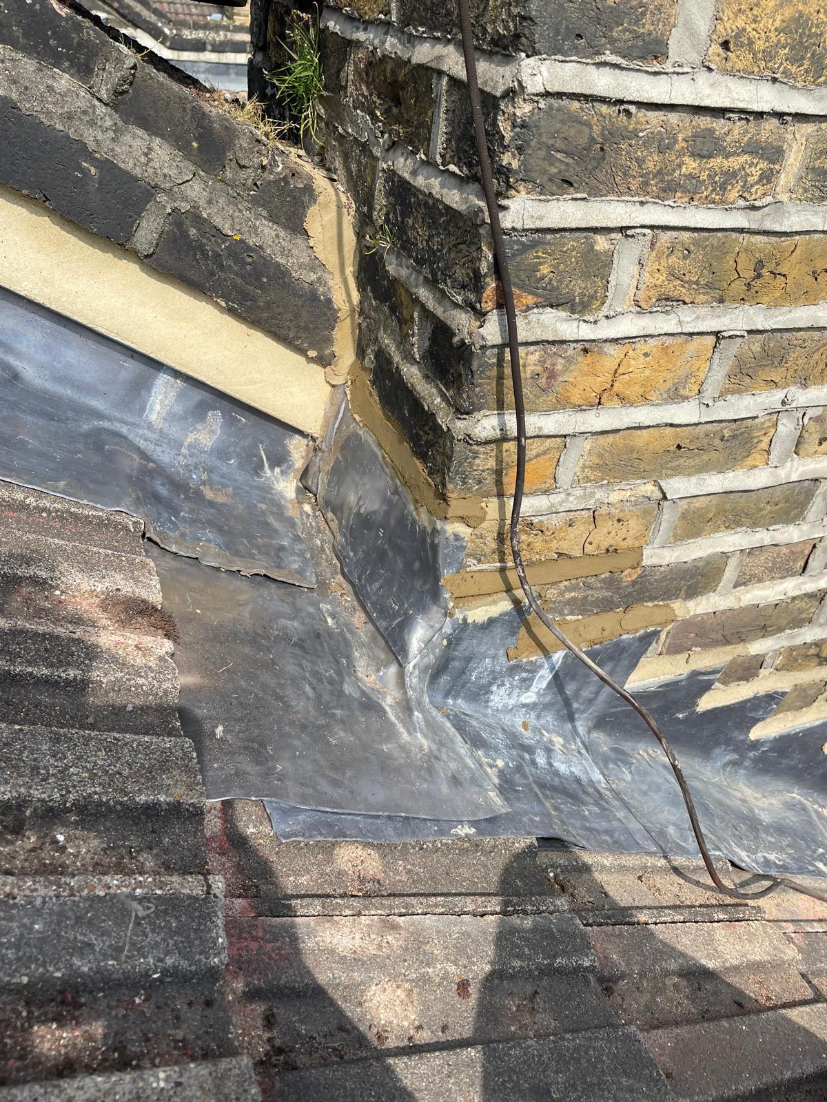

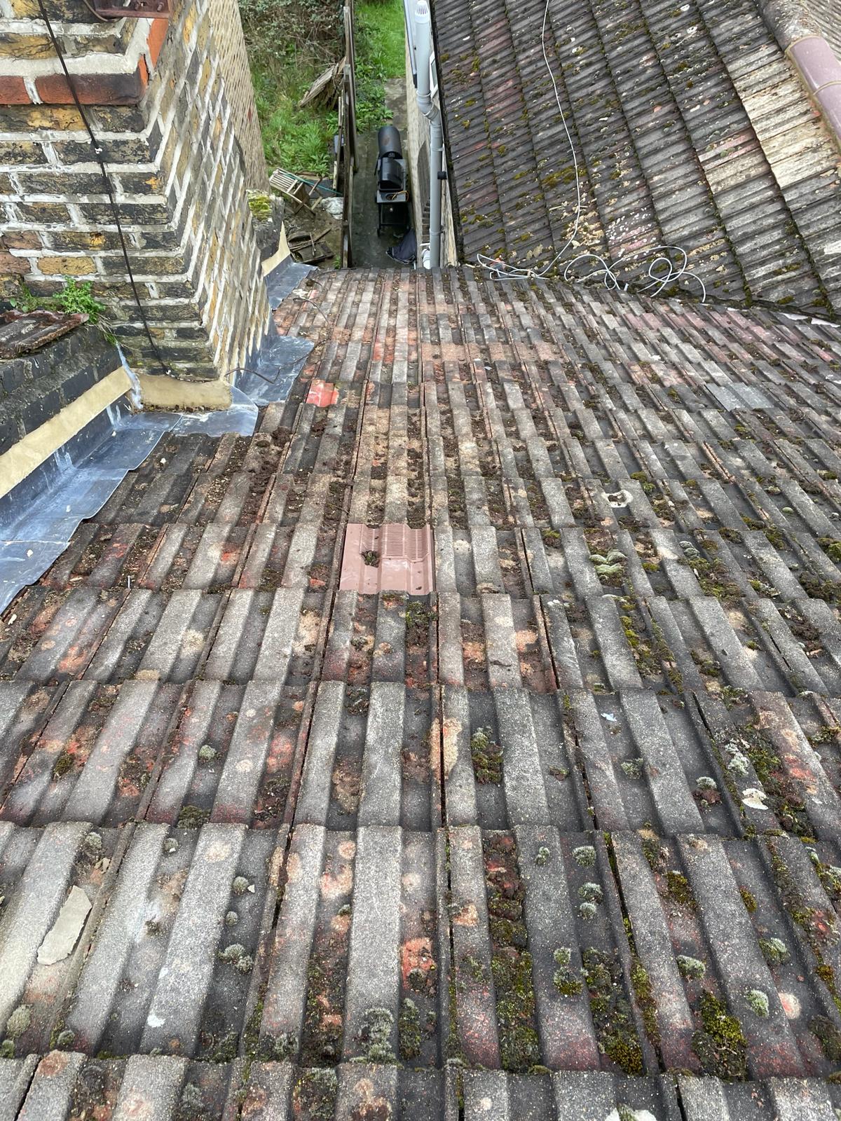

Hello,

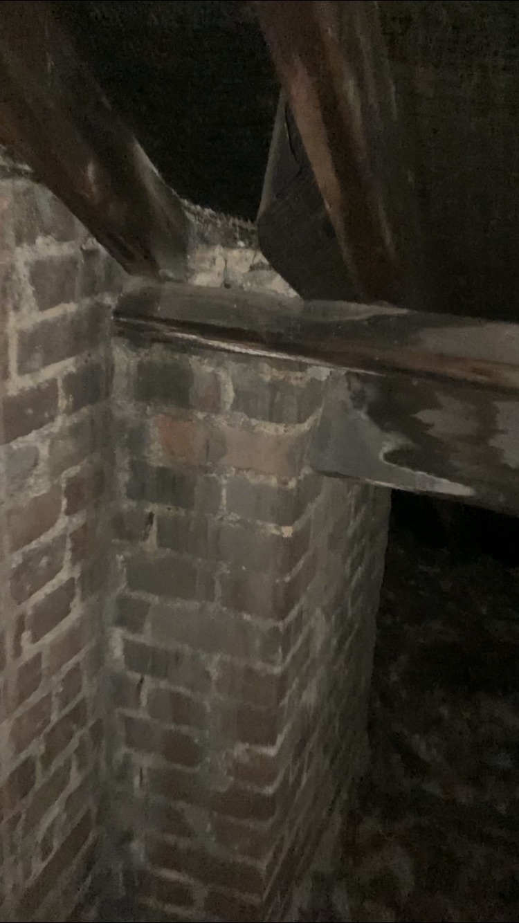

We had new led flashings fitted. We seem to still have leaks coming through around the chimney- the roofer has returned 4 times to try to remediate but it's still leaking somewhere and we're not sure where/what to do. Please see pics. We're also not sure if those wet patches on the timber are drying out or still getting wet.

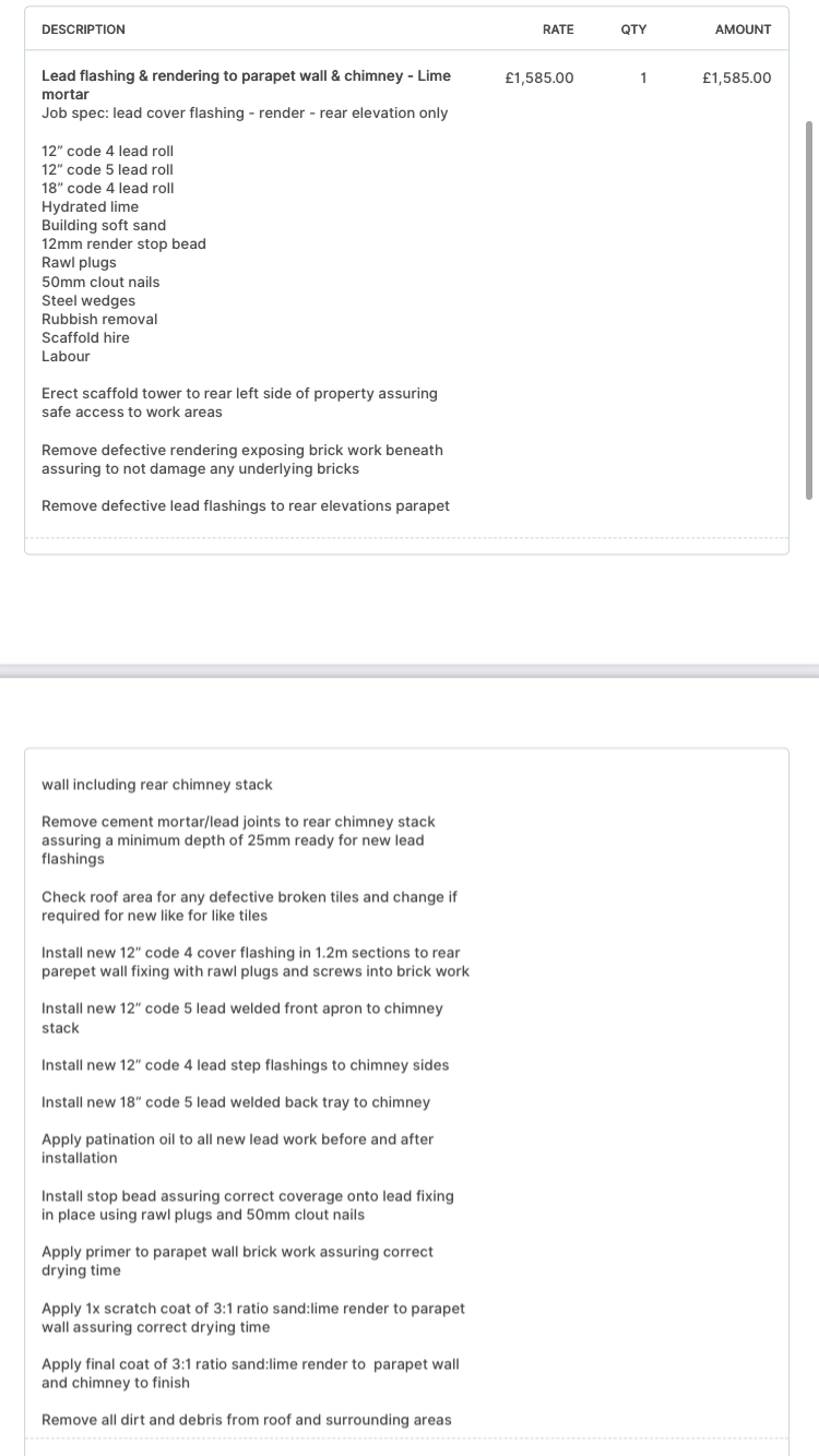

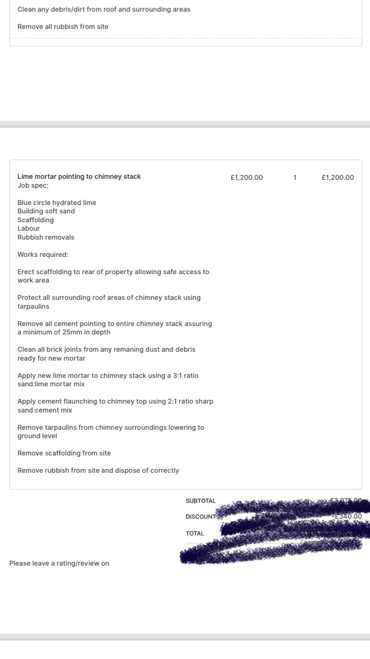

We had the following quotes to help the issue. The 1st quote/roofer wants to completely remove the entire back flashings (he said they're not great) and start from scratch, so he can give us a guarantee, and re-point the chimney/flaunching. Obviously re-doing them all feels expensive and we're unsure it's fully necessary as it's only leaking around the chimney, but keen to hear your thoughts.
I've attached a picture of the quote.
