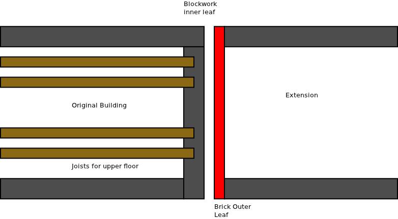

I plan to remove a 1.3m gap between a room in my house and an existing extension. The wall in question is the old outside cavity wall. I know that the "inner"part of the wall supports the upstairs floor joists. I have no idea (yet) how the extension joists are supported.
There is no wall above (it was removed when the extension was built)
My tame builder suggests using two cheap concrete lintels, one on each leaf. The opening is floor to ceiling, so the joists will sit directly on the lintel.
I think I need to check the extension joist situation before making any holes.
Does this sound like the beginnings of a plan? I was wondering if a Catnic style lintel that does both leafs at once might work better, for example?
In fairness, i find it difficult to advise you when i can't get a clear mental picture of whats existing and whats proposed. i only speak for myself,of course. Why not post a few pics of both floor/wall areas in question and from outside, and a diagram with joist directions.
The notion of a piggy-back, double knock-thro sends alarm bells ringing - perhaps it'sonly me.
I am increasingly aware that I need to find out some stuff about the extension construction but...
I want to take out a section of the old external cavity wall. I know the joists are hung on the inner leaf for the upper floors of the original building but I have no idea how the extension was constructed. I need to lift the upstairs floor to move some electrical stuff about anyway - so I should see then.
The wall above all this was removed when the extension was added (there's a lintel upstairs holding the roof up). I have some of the plans and that implies a single, concrete lintel across both leaves.

With respect i still cant advise you on the strength of the posted diagram. Perhaps others can, but i'd prefer that you posted pics as asked previously.
For a little over a £100 quid you can have a structural engineer come out and design a suitable lintel. Surely that's worth it?.....
I'm not sure how a picture of a gyproc wall (choice of two) is going to help.
Yeh - I think that's the point. I'd rather have something in writing from a structural engineer as it doesn't seem entirely straightforward.
A 1.3m opening is not a lot, and a couple of concrete lintels will do
