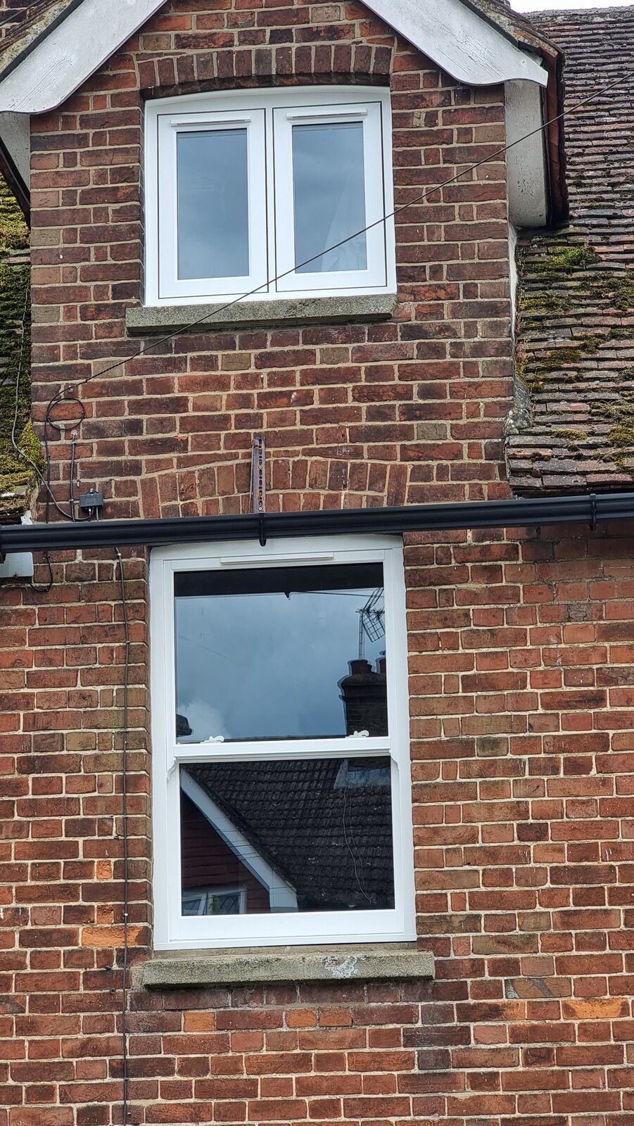

Rehau heritage with mechanical joints are pretty decent.
Have to say, they do look good. I've fitted Rehau windows recently (not sashes) in another project and they're decent.

We installed these rehau vs. Top window is a r7.
