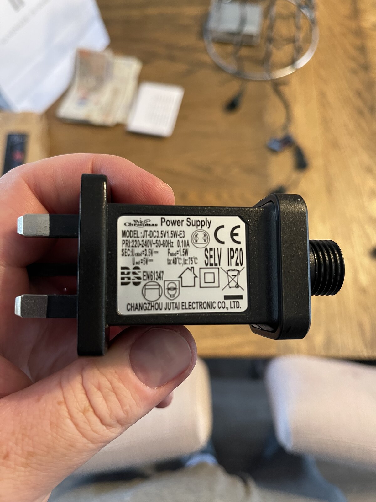

Early I know, but I got some new lights ages ago in advance of Christmas this year and I finally got round to testing them.

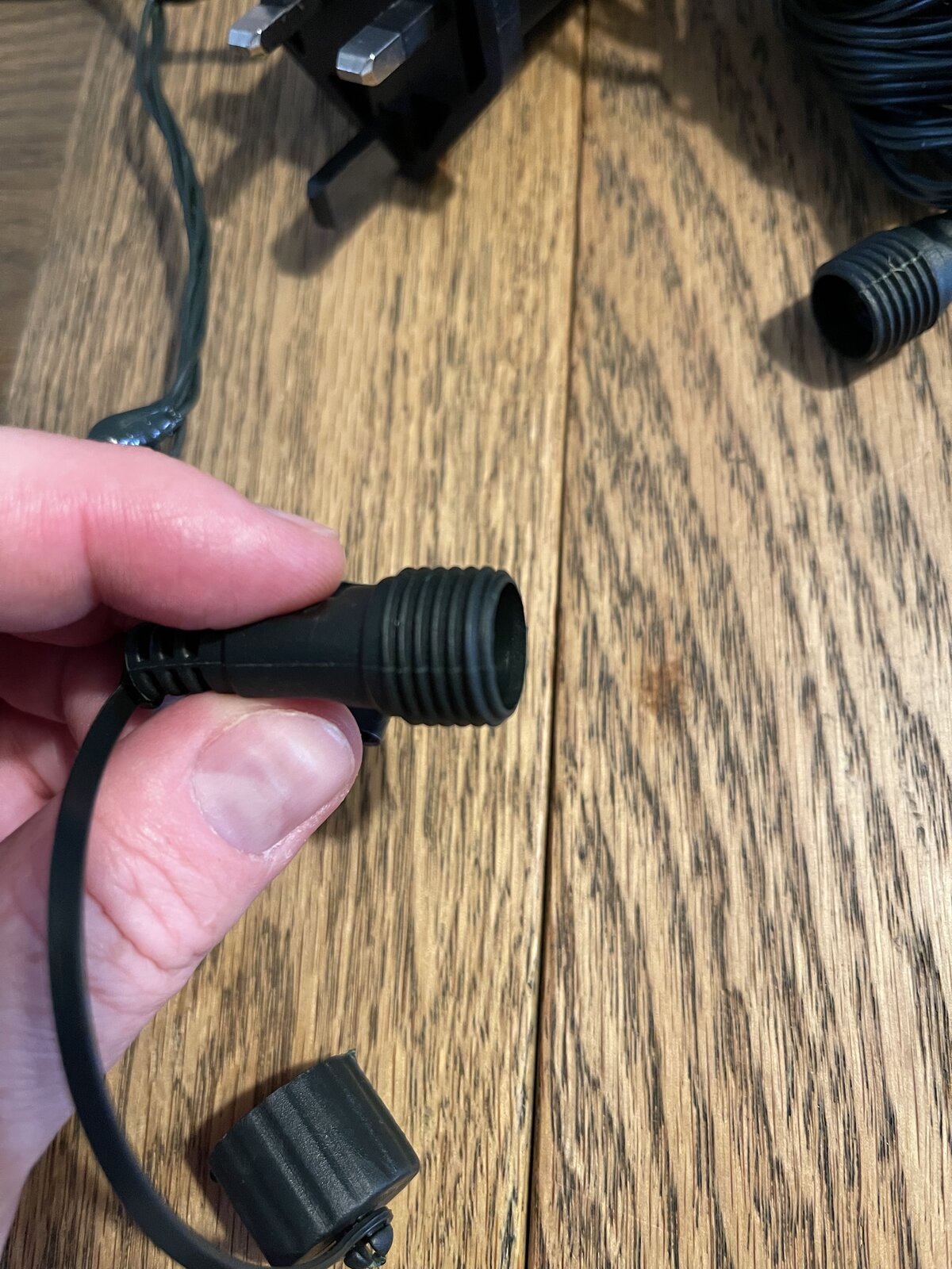

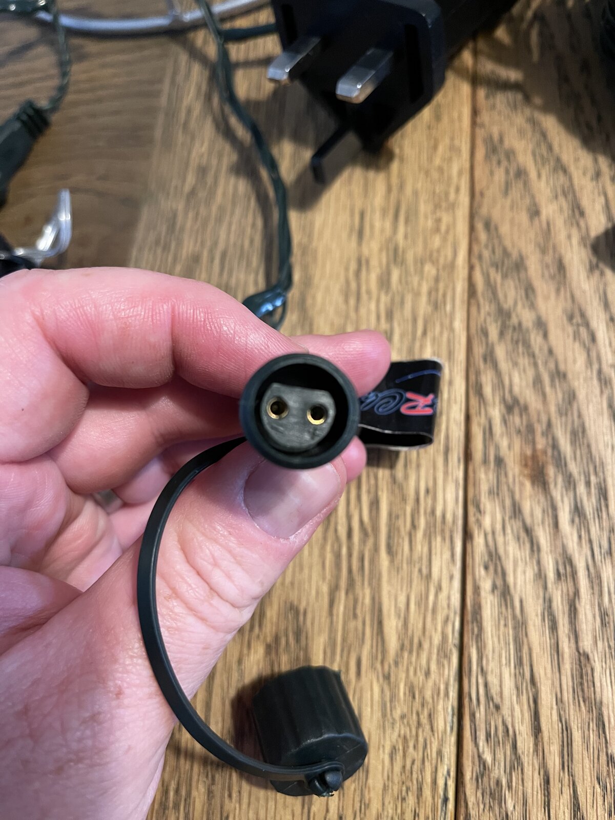

to cut a very long story short, these are interconnecting fairy lights (image of the connection terminals attached) and I have a transformer to plug into the string of lights. The idea is they daisy chain.
For some reason, the lights are not working! I know the transformer is working and I’ve tried 2x these sets of lights which are not.
can anyone help me please? The lights and transformer are from the same manufacturer.

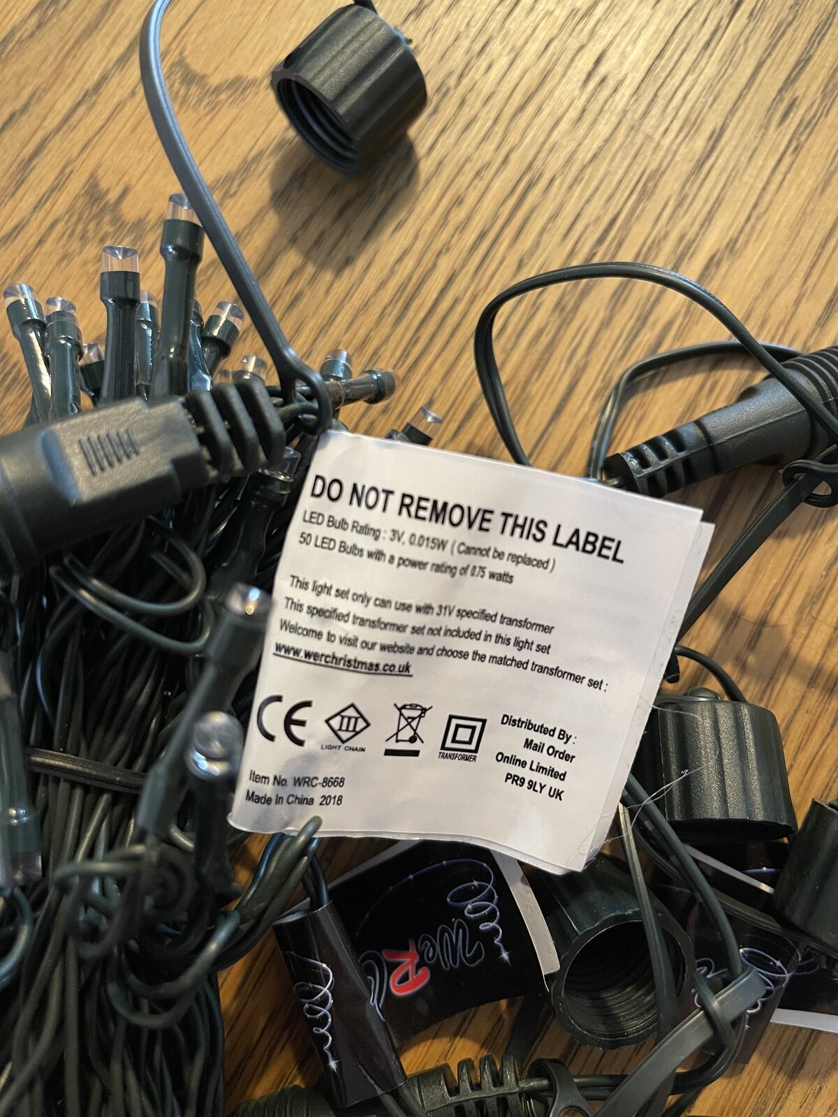

It would seem all lights in parallel, not sure about
I have some Lidi smart lights, they have a link which seems to show you can add a second set, but the controller is only large enough for one set, the link is so you can cut the set into two, not so you can add more.
are you pushing the connecter in the right way round, even with the flat edge they can sometimes go in wrong way.
Start by testing each run on its own, from the transformer
Thanks. Yeh they’re definitely in correctly. I can screw the cap.

As I said it is a power supply not a transformer. Why would you think they would supply one not powerful enough?
The ‘power supply’ is from a different set of lights. They weren’t supplied together.
Amazing. Thank you. My knowledge of electrics is zero (hence you having to correct my language) so at least I know now that I need a more powerful supply!
Not actually more powerful but the correct voltage. The label on the lights give a web address where you can order one from.

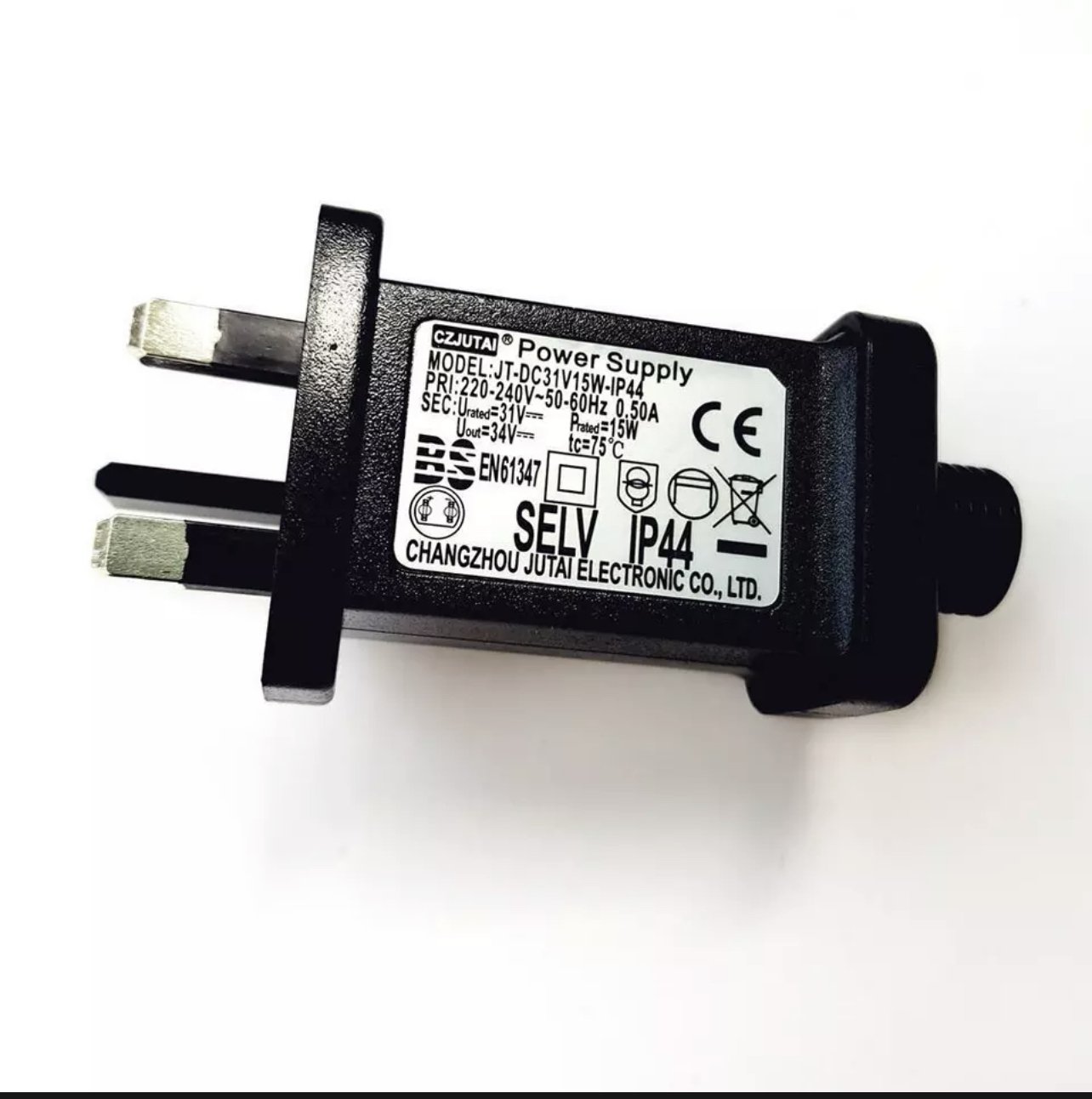

Thank you. could I check please, would this work?
(the website i got the lights from is out of stock so this is an eBay special)
