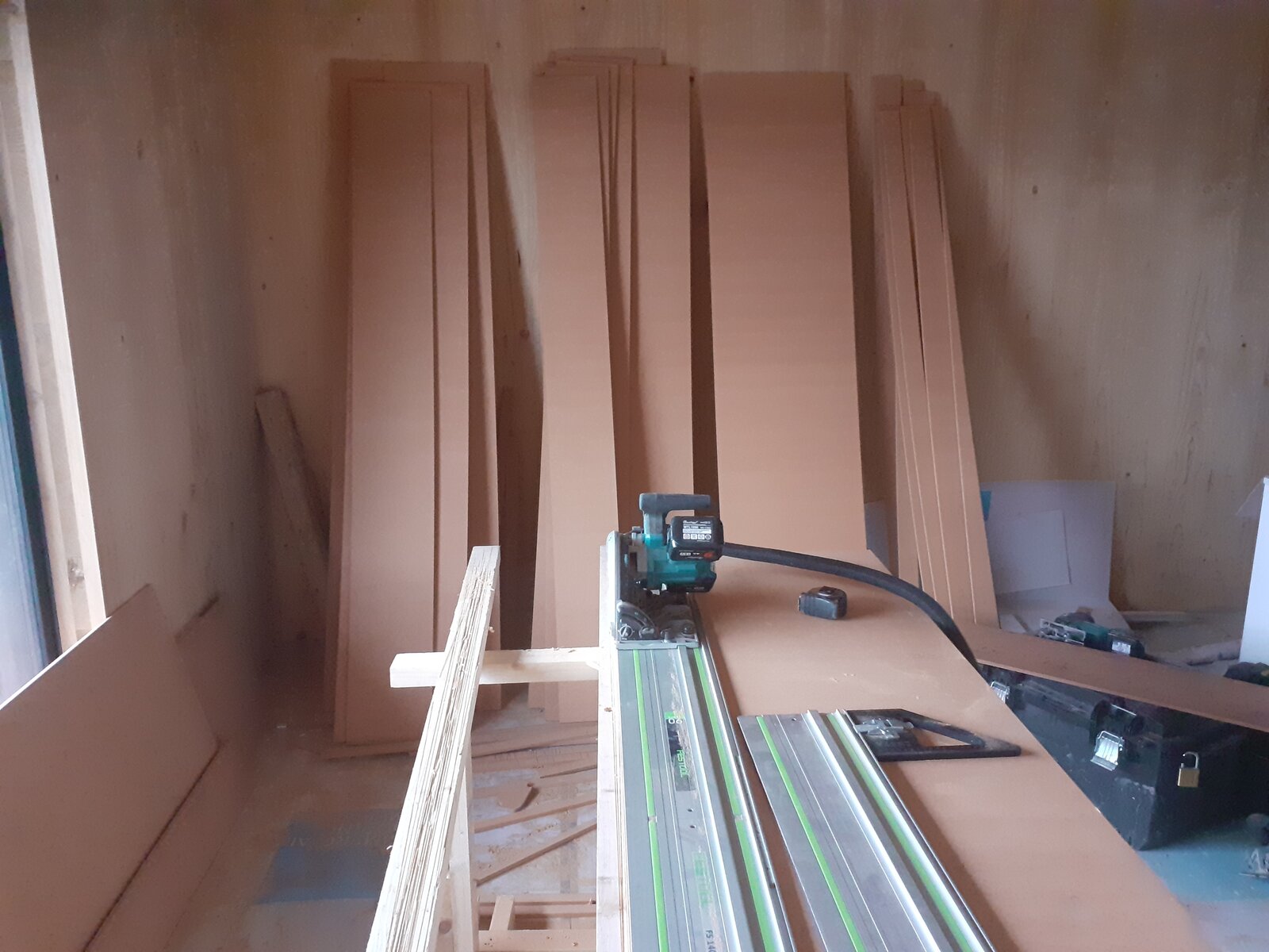

If you want some indication of how much a track saw can speed things up for a tradesman:
That's my waste trims from installing 33 MDF straight edge panels, all cut to different sizes, today. In the past couple of weeks me and my partner have cut and installed pushing 200 panels, many of which also needed cut outs for single or multiple electrical sockets. The saw is a Makita cordless (DSP600), the rails are my old Festool rails, and this is the sort of work a track saw excels at. And BTW a track saw is generally used single handed when on the track, not two handed - it's when you try to use them as a conventional saw that you need both hands to manage them, partly because there is a constant need to fight the plunge return spring. My go to saw for site work, a cordless 165mm Makita, is most often also used single handed when doing crosscuts (because my left hand needs to hold onto the speed square) whilst for ripping timbers a two handed grip is almost always necessary and larger sasw, such as the 230mm Hilti I have almost always needs a 2 handed grip, due to the size, weight and torque of the saw
I'd say that in the days when we did panel cutting with a batten and rip (circular) saw there was a lot of clean up, there were a lot of holes to fill and sand and the edges were never truly straight off the saw. So for that class of work a track saw excels
As others have said, though, they aren't good with narrow stock (unless you invest the time to make jigs which sort of negates part of the reason for having one in the first place) and they are aren't good on narrow material crosscuts unless you build a sort of crosscut table (look at the Festool MFT/3) to see the sort of thing I'm talking about (it should be possible to make one of these at home. They are also poor at narrow rips or working over rough sawn timber because there is insufficient area forvthe rubber strips on the underside to work
