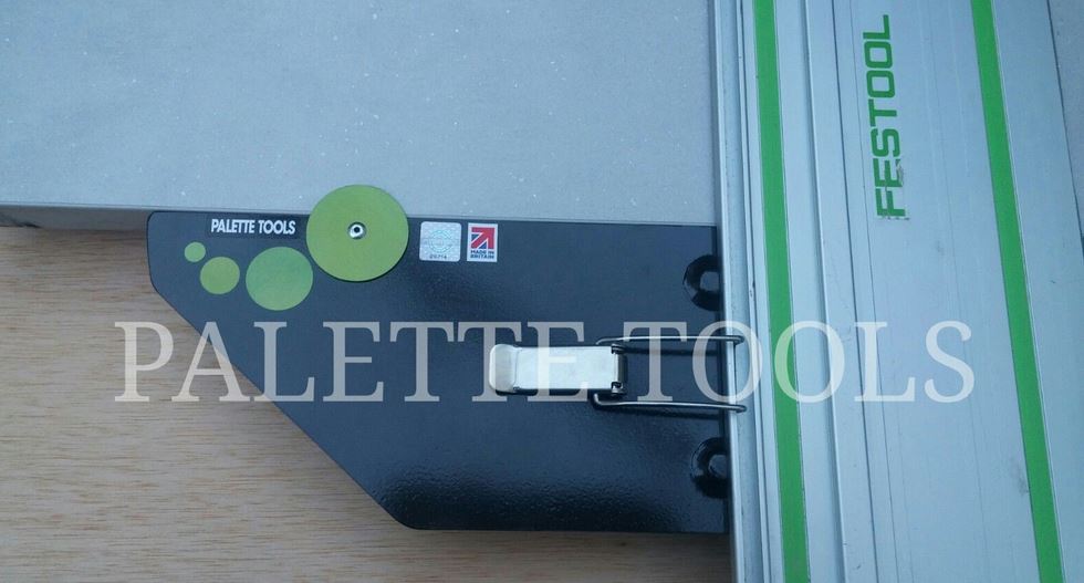

In general, and assuming that your original sheet material was cut dead square at the mill (it isn't always!), then measuring-in the same distance from each end and aligning the track to two "ticks" will give you a square cut. If you want a truly square cut with only one measure then there are attachments you can add to a Festool/Makita compatible track:

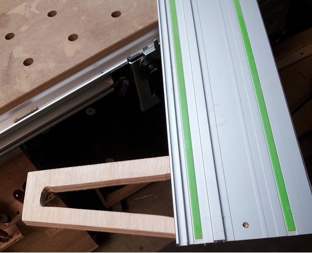

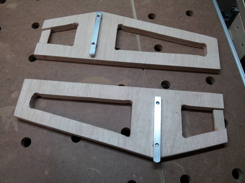

or you could just make your own:
These devices effectively turn a rail into a large T-square and are accurate enough to cut-up plywood for sub-flooring. I use the Insta from time to time and the squareness of the cuts is more than acceptable on plywood sub-flooring (full width cross cuts of 8 x 4ft sheets)

The Pallette is a much more "pallettable" £50 on eBay (when it can be found)..... The Insta can be had from FFX for £125. I know these prices seem high, but to someone who makes a living at it they can repay their original cost pretty quickly in saved time
