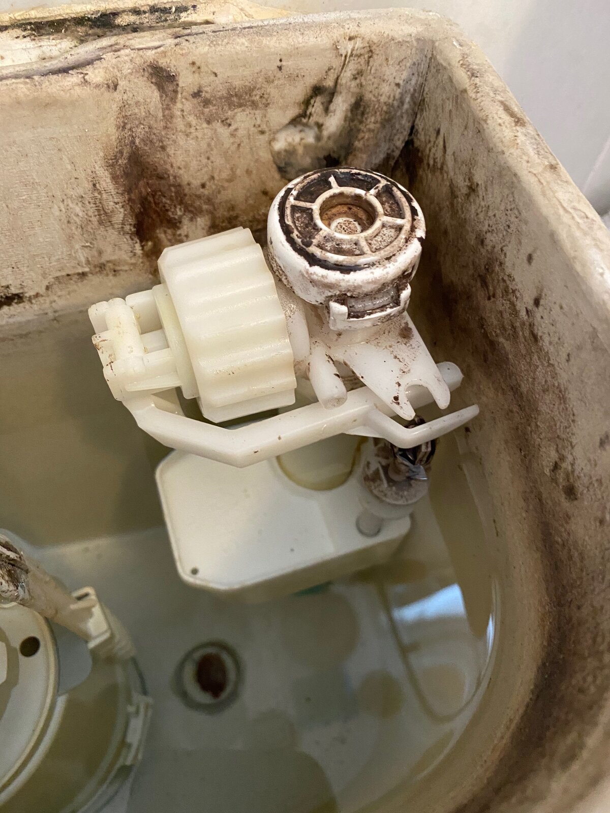

Hi all,
Our toilet cistern fill valve won't cut off when the level reaches where it should. I replaced the diaphragm a couple of months ago due to very slow filling and now this issue started today.
So, I guess there is something not right with the valve - is this a suitable replacement ?
https://www.screwfix.com/p/fluidmaster-bottom-entry-fill-valve/84007?_requestid=220029
My next challenge is the houses previous owners decided to box in the isolation valve just beneath the cistern so I have to try and remove some tiles to gain access! :(
Thanks.

Yes the fluidmaster will do, others may tell you to get the one with the brass shank.
