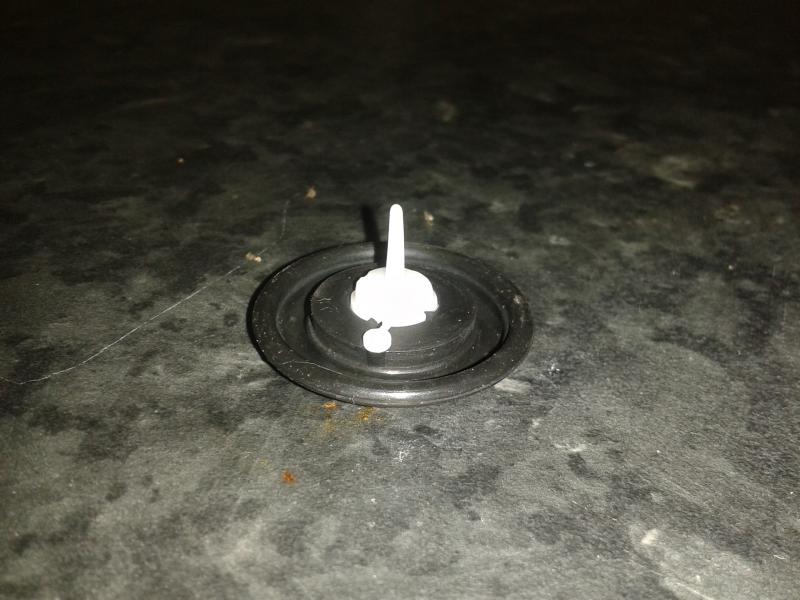

hi all hopefully the pic of my problem has uploaded. when i flush the loo it doesnt shut off, i gguess it must be a washer of some sort, i have taken the large nut off on the left and i can feel something rubber in there, is this what i need to replace?

There is something a bit weird about that lay out can't quite get my head around it.
Anyway the rubber thing under the nut will be a diaphragm washer most are a plain one like this
http://www.wickes.co.uk/Ball-valve-Diaphragm-Washer-PK2/p/421629
But as your valve looks a bit odd getting a kit with some of the more obscure ones might be the best bet
http://www.screwfix.com/p/ball-valve-spares-107pcs/98525#
Note which way round the old one is when you remove it, there is a small lip around the edge it must face the same way as the old one.

It looks like a WC cistern frame, did you gain access via the flush plate at the front?
It could be your flush valve washer that's faulty or damaged & not the inlet valve.

Yes reading it again, I got a bit side tracked by the nut/washer reference it could well be a fault with the flush unit :oops:
The problem is with the washer under the nut on the left I think as this is where the water comes in and it won't stop. Are all diaphragm washers the same size?

Ive taken a pic of both halves of the valve I think the diaphragm must have fallen out as I cant find it. Can anyone tell me how the valve works and if possible what type of diaphragm I need
Bill
The most common one is the wickes one in my first link, or just take the valve into a plumbers merchant an show it to them they can sort you out in no time :D
