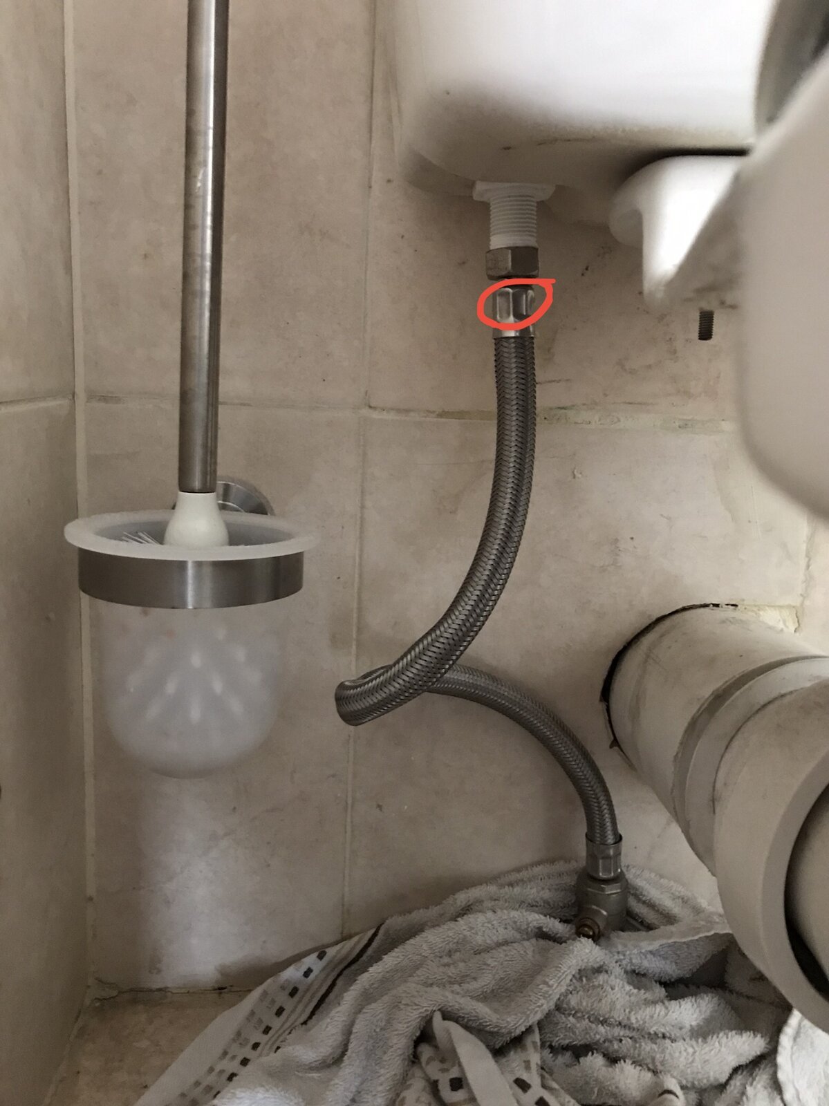

Hi all
The water pipe that feeds the toilet cistern leaked a few years back. I popped a flexible pipe on it, it came with a shut off valve and simple for me to fit.
However, it’s started to leak again. The washer is worn and I swapped it out ( with a fibre washer that I had). Still leaking at the red circle.
So - will I go for another flexible valve (are there better quality ones)?
Or maybe this is the time to tackle pipe work, as I feel more confident to do it now.
Appreciate the benefit of your experience. Thank you.

Looks like it's cross threaded ,the nut seems to be askew .Could be the camera angle though. Try a rubber washer instead of fibre.

Well spotted. Your head gets in all sorts of angles.
Will try rubber washer also.

If you fit the item listed above, you do not need any extra parts, except for perhaps a new fibre washer.
Your present problem is the plastic spout you are connecting to, is not as robust as a brass version would be - so you cannot tighten up enough to get a seal. Swap the plastic part for brass - problem solved.
