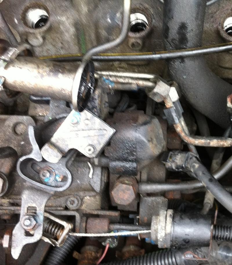

I have a 2000 Citroën Dispatch 1.9 disel non turbo van that has a problem!! For no reason and at very spaced intervals it will just cut out! I have changed fuel filter,air filter and removed the injectors and had them professionally tested ( they are fine) i am out of idears! it does smoke (white) on start up from cold and runs slightly rough on tick over but once warm all is well! You can be driving at say 50 on a straight road in 5 th gear it will just pause then stop!? once at a halt it will start fine it is a worry as i am going on holiday in it with the family soon!! Any help would be great! Thanks Jason

Give us a pic of the injector pump if you're not sure.
John :)
I can't see a fuel shut off solenoid there - it must be the internal type.
If it was mine, I'd still replace the crank sensor.
John :)
Check there's no crimps in the fuel supply line also.

Has this one got the electric pump in the fuel tank? Not sure at that age, some of the other guys might know?
Hi don't know if it has a plumb in tank? Getting the injectors put back in tomorrow so will try it from there! It's very annoying!! :(
