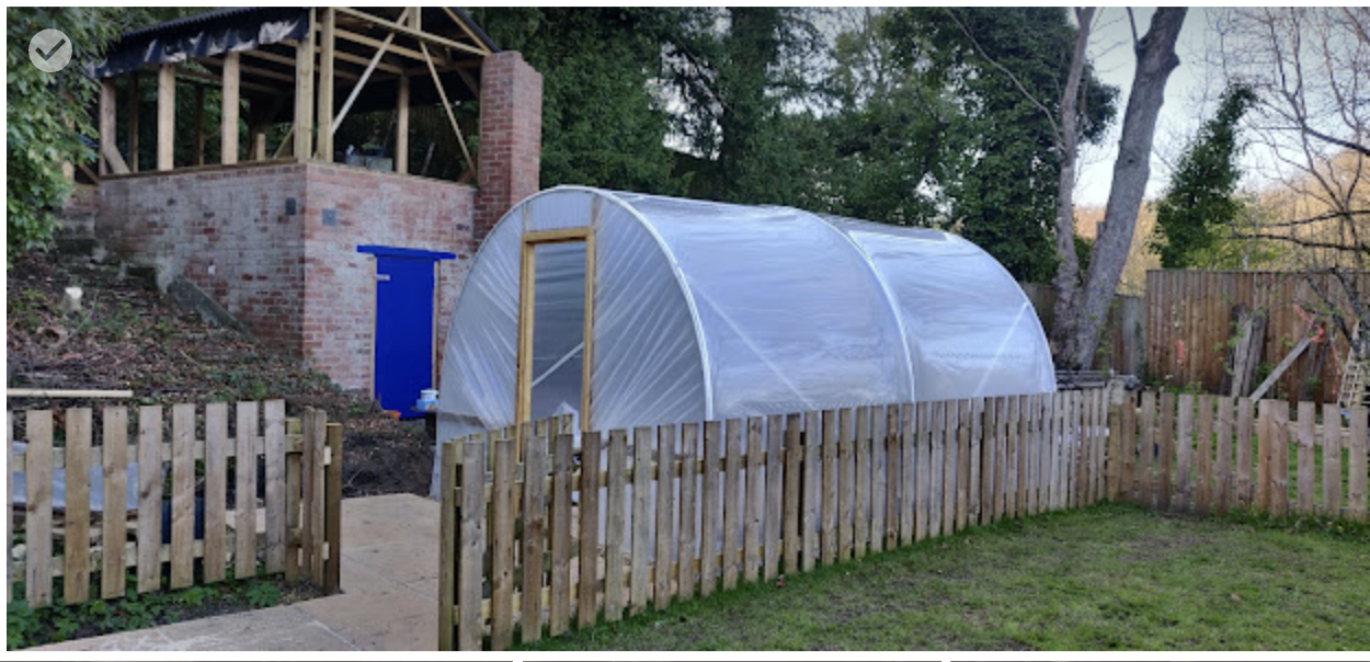

From my project thread I want to part-clad this 5x3m wooden superstructure as a sort of garden room. Lots of windows on the visible sides, mostly cladding on the north side and one end.
The idea is the cladded sections would be insulated effectively stud-walls, with exterior cladding. Initially I thought I'd just put decent cladding boards directly on the outside of the structure, but I'm wondering if it might be better and/or cheaper to clad the exterior with ply/OSB boards first and then put the cladding on more as a decorative/rainproofing layer. Made me think I could use thinner cladding boards and it would be less drafty, as well as providing more rigidity and maybe not needing to put as many additional studs (the main structure is 6x3" timber essentially 1.5x1.5m squares with corner bracings).
Is an initial cheap cladding layer a good idea and if so any advice on materials/process? BTW that chimney will be removed :)

you could cover the timber work with a breathable membrane like tyvek housewrap
then fit softwood battens like 50 x 25 vertically
that creates a wind tight structure, with a cavity so any water getting through will run out without penetrating.
then fit timber cladding
I presume you you mean battens to stud out the spacings between the main uprights, wrap with membrane (staples?) then the cladding nails straight through the membrane into the timber?
And then internal foam insulation inside the studs between membrane and internal wall?
you will of course need studwork between the main uprights
then membrane
then 50 x 25 battens then cladding
if using tyvek housewrap then you can use staples and they have a special tape to go over all joints -to form a full seal
internally use insulation in between the studwork
if your structure is a bit wobbly then you should clad in sheathing ply, then membrane, then battens, then cladding
