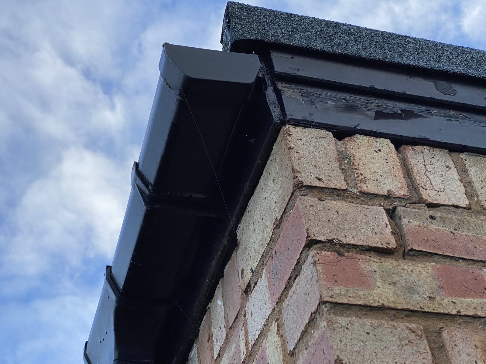

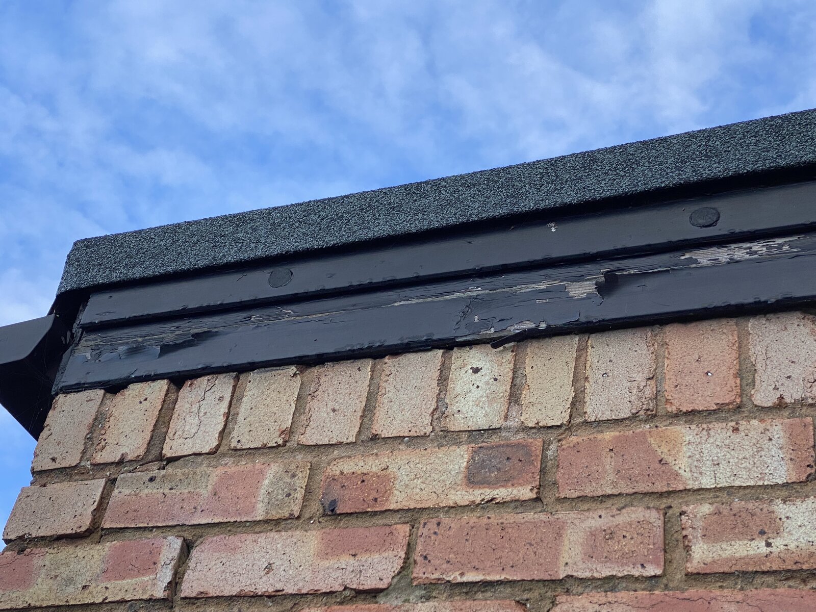

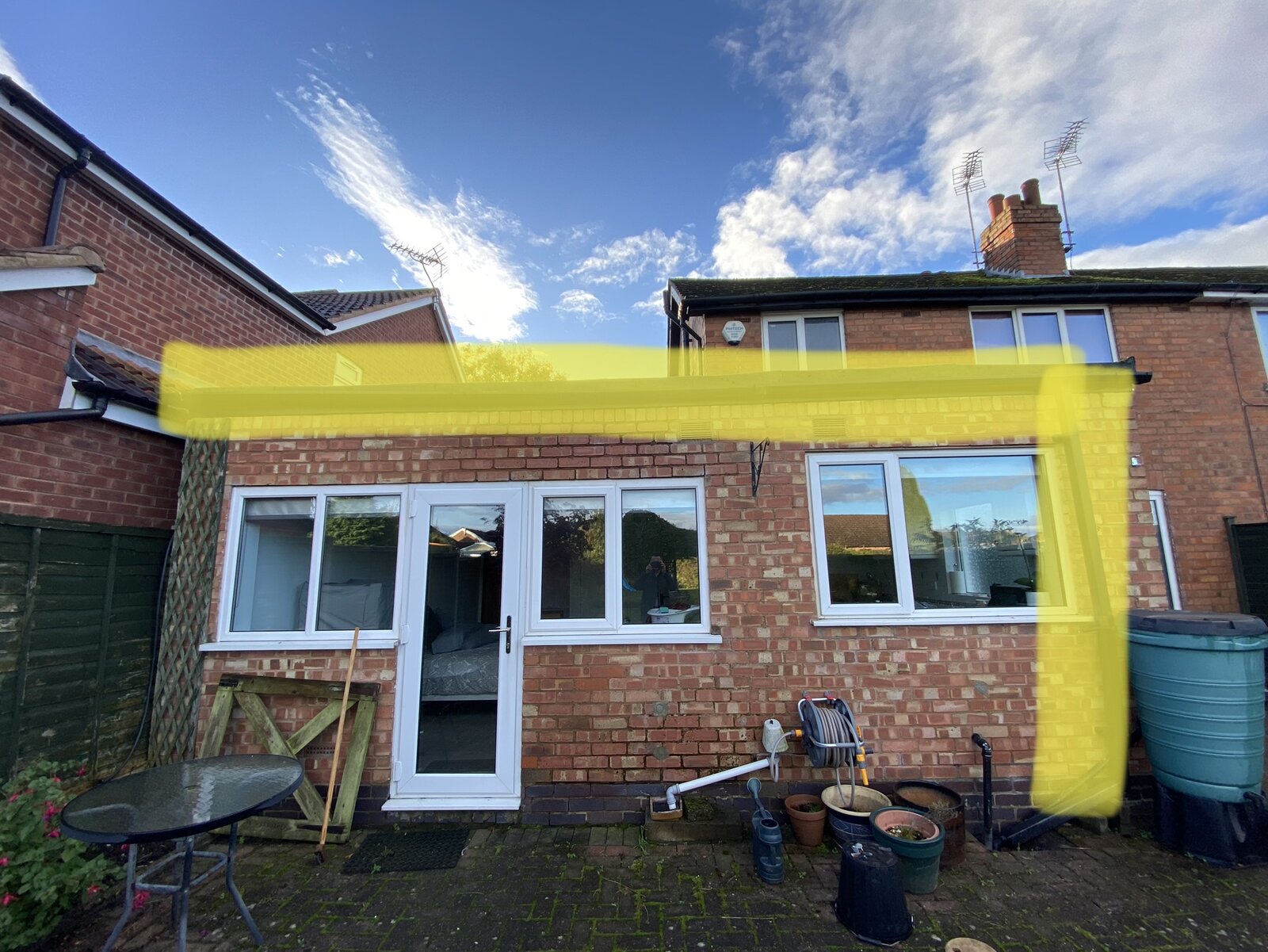

Hi all,
After some advice.
I have a leaking gutter along single story extension. Gutter looks bowed and waters is spilling over. Thinking of replacing guttering and cladding over wooden Fascias with PVC at the same time.
Is cladding over wooden boards recommending and how difficult will this be?
Is there anything to be mindful of and can anyone recommend any products?
Perfectly fine to cap over wooden fascias if there not totally rotten, you'll want upvc capping as opposed to fascia board, capping is only 9mm thick and designed to go over old fascias, fascia board is 18mm thick and designed to completely replace the wood.
