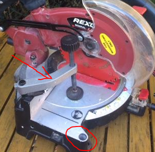

What type of clamp could I use to fix wooden picture moulding to my mitre saw? I use moulding from about an inch up to 4 inches. Holding by hand is causing slight movement and an inaccurate cut. My saw is old and basic, it doesn't have any fixtures for an integral clamp. So I'm stuck with using a separate clamp.

some pictures of the mitre saw, typical moulding may help, as would make and model.
Some Fence, you can clamp to, my dewalt you cant as its curved - but depends on moulding, and fence etc
So pictures may help come up with a solution
Thanks - here's the saw

Use a sacrificial fence slightly higher and wider than the one with the saw, bolting or screwing through the holes at the top. Clamp the moulding vertically. Use the best quality fine toothed blade you can get.
Blup
Normally, there is a a thumbscrew to tighten, but generally the metal peg will hold in by friction once you tighten the piece down.
Thanks. I should have asked, do the clamps fit universally - Can I buy any make?
You'll need to check. A lot of saws are just re branded so may share parts. The ones I've see all seem to be about 12/13mm bar, but you may need to do a bit of research - try parts catalogues
