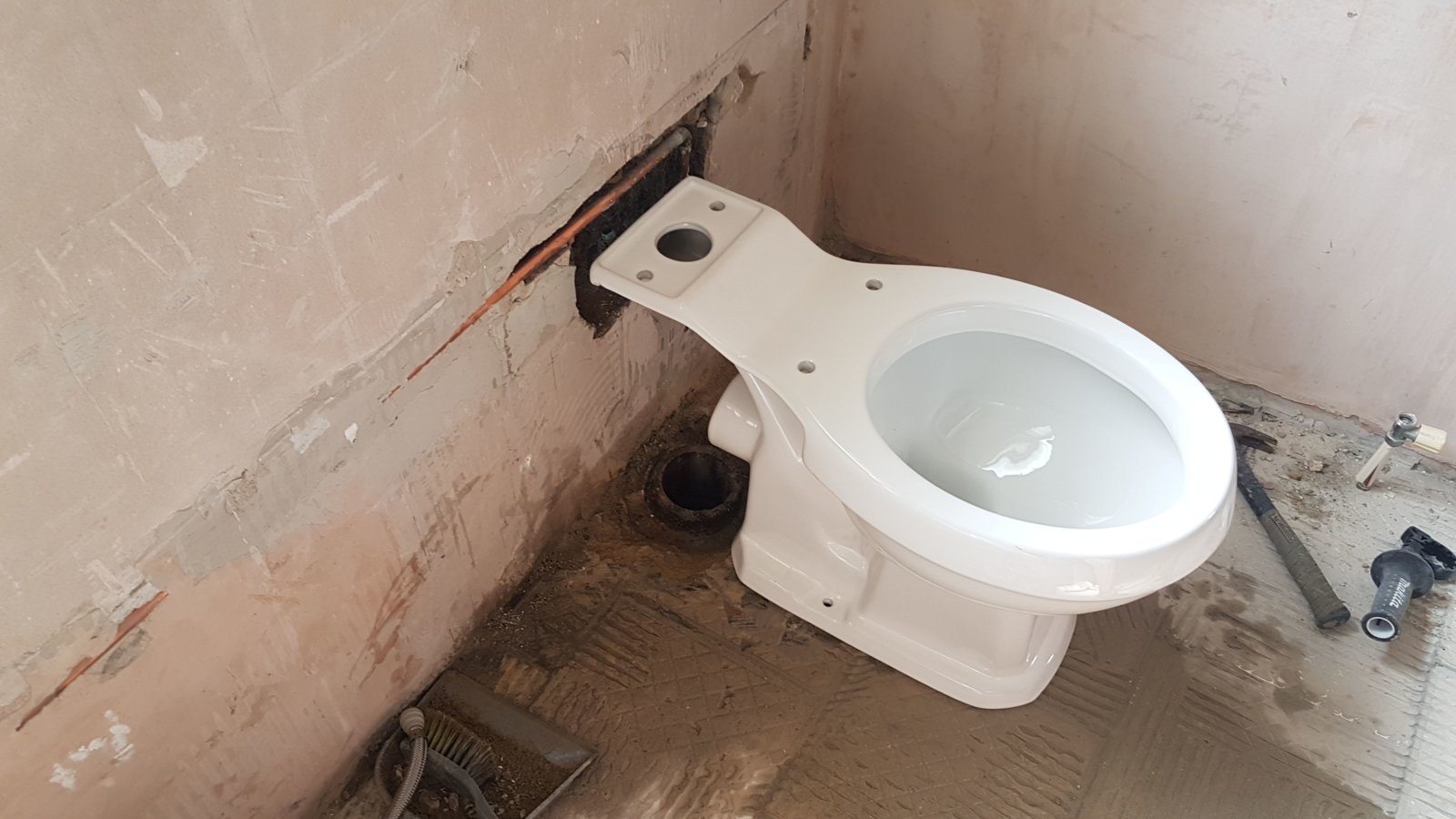

So i dug up round the clay pipe and removed a black (HepSleve) coupling that sat over the clay pipe.
As you can see the new toilet has the pipe exposed so needs to be white and tidy as possible going into the floor.
Can someone recommend the right connection here please as of course i want white fittings. TIA
Long bent adjustable pan connector or short bent pan connector and extension piece.
Thank You very much exactly what I was wanting. That extra talon cover too cheers (y)
OK bought this one but it doesn't fit :(
https://www.screwfix.com/p/mcalpine-wc-con8-90-wc-pan-connector-white-110mm/7102p
I didn't realise but the outlet is 110mm The clay pipe internal diameter is 100mm.
Any ideas i need something to sit over the clay pipe maybe like this but it needs to be white as it's exposed on the floor to the toilet.
https://www.screwfix.com/p/floplast...fC67yEVq3_0btoflV0BoCgcQQAvD_BwE&gclsrc=aw.ds
Try one of these maybe? https://www.hunterplastics.co.uk/products/plumbing/multikwik-wc-connectors/
You will notice that the soil is between 99mm and 105mm.
