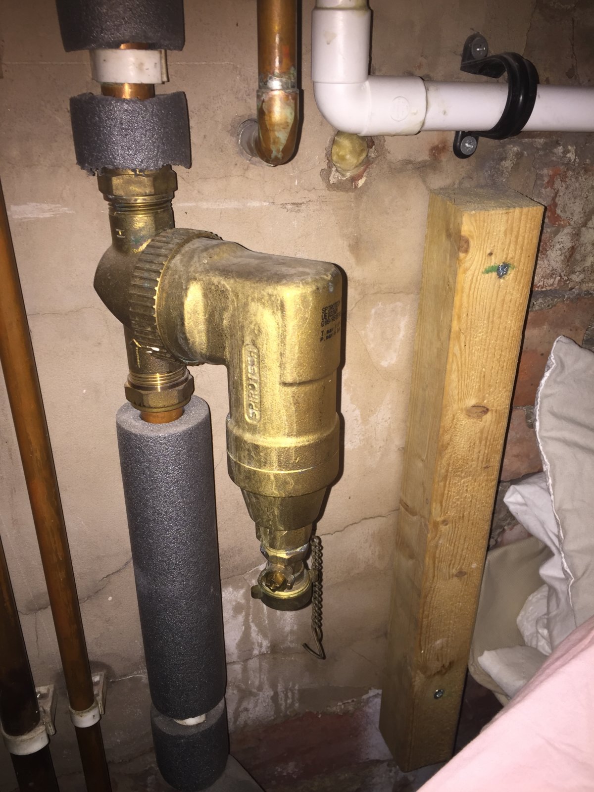

show us a pic of your filter.
I have an older Spiro and it is not much good at collecting the black particles. I would swap it for a Magnaclean but there isn't room.
I have fitted 5 Spirotecs and have never got anything but water out of them when I go to service them.
Mine has Really done a job on this flush it seems, as it trapped a lot of crud.
This must be a sign it has been doing its job.
It’s an older one pre magnet. I will do a pic in a bit
This is the beast

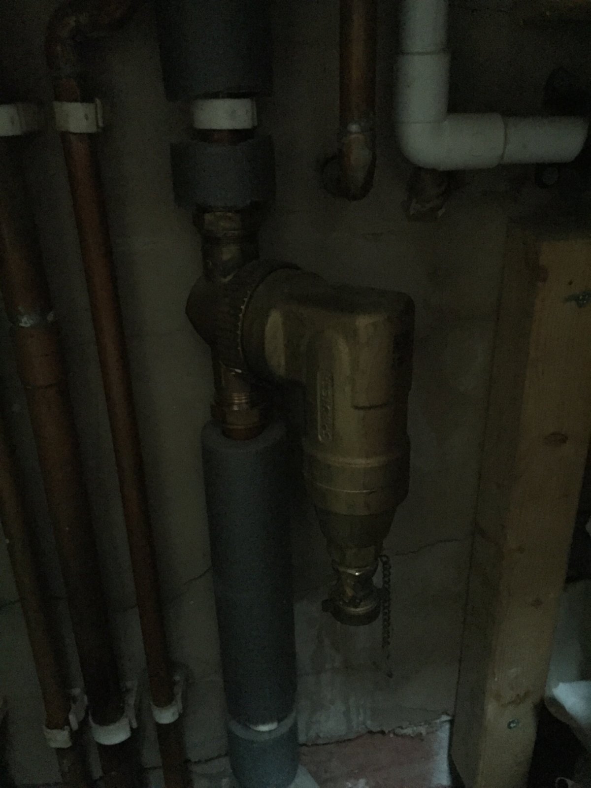

That’s not a pre magnet one the pre magnet one was a dirt separator which caught more than any of their magnet versions do that looks like their first magnet effort (MB1) the magnet is internal and not removable.
Or maybe it's an external magnet version whose magnet (like mine) dropped off by itself in the middle of the night? What a crash that made - I realised what it was only weeks later... the magnet is now tied on with a bit of string. Quality!
Yes i think it has the internal magnet. Seems to be working ok.
