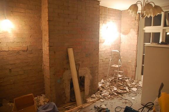

Sorry for the poor photo, I can put a better one up this evening if needed.
I've removed all the plaster/render from my living room walls with the intention to PVA and Dot & dab them.
Question is how clean do the walls need to be prior to this? Do I need to scrub them down with a wet brush? Or worse get a wire brush out?
Brick work is all solid and dry (they're all internal walls)
AS long as they are sound and dust free. Get loose off and then I would clean them down with a wet soft sweeping brush the day before. If they dry very quickly, It might be worth wetting them again before sticking the boards.
They look like they have enough of a key .
anyone else?
I would give them a tidy brush down with a sweeping brush and dab straight on them, do'nt bother with pva. If you are weary of this then do a test piece.
Don't dot & dab any gypsum based plasterboard (& that includes Fireline) around that fire opening unless the fire you install is nothing other than for visual effect. If it’s to be a proper stove with real heat output, you need to do something else; if you regularly expose gypsum (plaster or boards) to more than 50 degrees & it will fail in a very short time.

We're installing a wood stove so around the fire we'll use concrete render to be safe.

Use sand/cement/lime render with heatproof plaster within 300mm either side & 80mm above the stove. Here’s a link to some archive info, not all may be relevant;

Can someone also recommend a good adhesive? I have seen adhesives in spray cans and then there are the powdered stuff you mix yourself but what is the best and who makes it?
Either are good, foam needs strict time keeping or boards will be pushed away from the wall, it is cleaner in some respects and quicker. Dont get the foam on your skin as it stays there until the skin comes off. I would say the plaster board adhesive (wickes and b&q sell it) which you mix up and dab would be far easier for a DIYer.
You are right steve, it's best over a true wall or if the wall is pretty flat and the wall doesnt need to be spot on, it is however fast and isnt hydroscopic.
