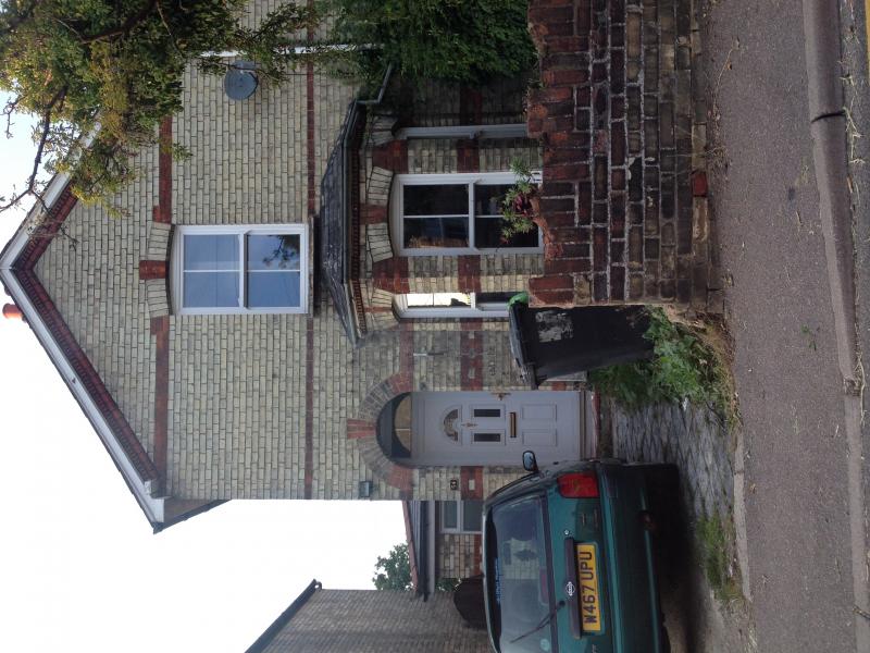

I am looking to clean the brickwork on my Victorian property. They are yellow bricks but covered in dirt and grime. The house has a lime mortar so I don't want to damage this or the brick work. I know not to use a pressure washer or anything that could damage the brick or mortar.
I've read that perhaps a chemical cleaning acid is the best choice. Can anyone recommend how to clean my external brickwork without damaging the mortar or bricks themselves? [/b]
It may seem a stupid question but have you tried cleaning with a hard brush and a decent detergent?
Avoid acids and aggressive cleaners as they are likely to damage the face of the brick and may make the problem worse in the future
It's not a stupid question at all. I haven't tried this no. It has crossed my mind to try but thought I should try seeking advice first.
Any particular detergent to try? I have a stiff wire brush I could use
Don't use a wire brush - you may leave fragments behind which will rust and stain the faces.
Try diluted sugar soap - wear suitable gloves and eye protection
Try to avoid scrubbing along the mortar lines - try diagonal strokes.
If it makes a difference then try with a broomhead - whatever you do test on a small area first!
