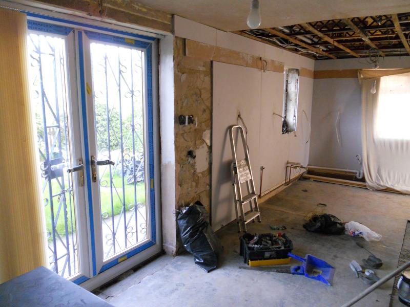

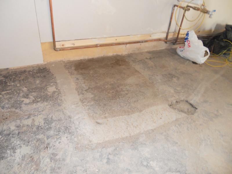

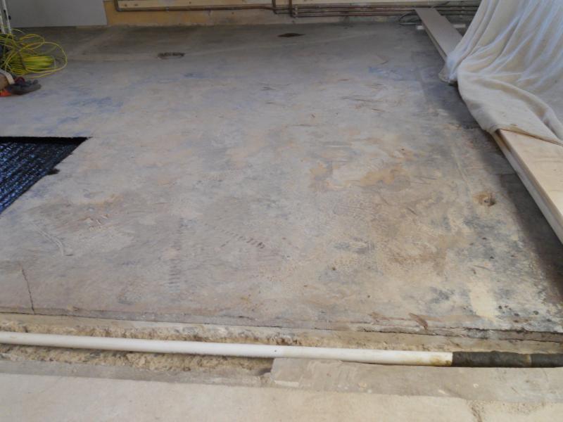

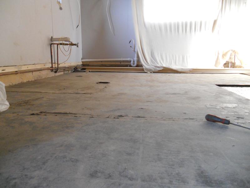

i have had my kitchen dining room replastered throughout leaving dry plaster in places over the floor etc im having my floor tiled throughout 26 square metres approx after some concrete laid in a 2 metre section and self levelling in other places to get the floor flat...im already scraping the dry plaster off the floor to prep the floor etc is there any recomended techniques used besides this to clean prep the sub floor b4 tiling ? cheers again

I see the rooom is L shape, what are the room sizes? Is the slab continuious under where the wall was removed or is it laid as two separate slabs with a joint. You may need an expansion joint & possiby an uncoupling membrane if it’s laid as two separate slabs.
Additionally, what is this 2 metre section, part of a new slab or just filling in? If so how thick is it going to be? Conventional sand/cement screed shouldn’t be laid less than 40-50mm as there is a risk it will delaminate or even break up, you may be better using a suitable SLC or bonded screed. You can’t tile over a new screed until it’s fully dry, allow one day per 1mm thickness.
Regards the SLC, you’d do better to level the whole floor rather than patching, this will provide a continuous tile base of known quality rather than a patchwork of different substrates.

I’m still unsure about the overall integrity of the floor area; if it consists of several different slabs/screeds laid at different times or they are cracked, you may get differential movement in the floor which will crack the tiles if you tile directly onto the screed; this is why I keep asking how the floor is constructed. A flexible SLC over the screed will provide uncoupling to a certain degree but if the overall slab integrity is in any doubt, you would be wise to lay an uncoupling membrane;

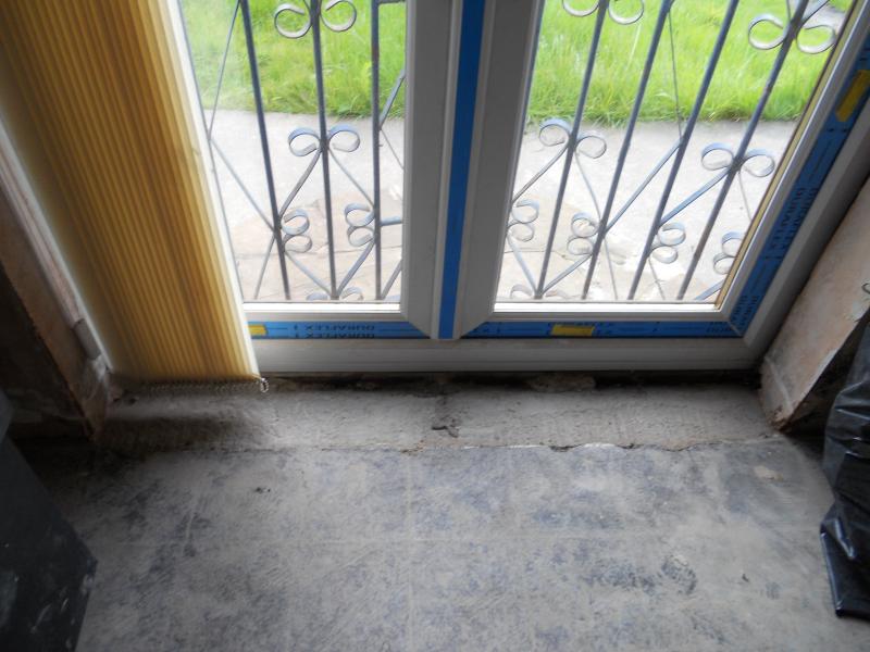

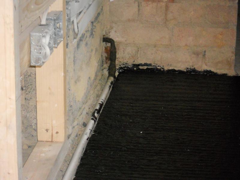

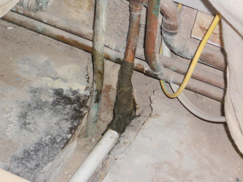

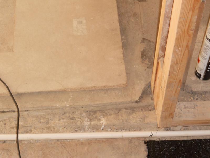

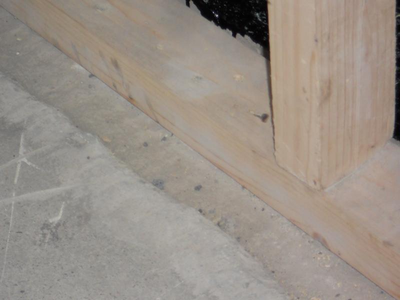

yeah cheers richard im glad you confirm i can use slc to fill the 20mm section of concreting as time is against me so cant wait 28 days or so for a screed to dry out etc...it is part of the existing concrete slab i am filling as ive taken out a brick fireplace and base alongside a staircase breezeblock wall...i will search for my usb cable and try upload images or they might still be on my laptop in files,the floor construction is a concrete slab in kitchen which has a dip init so will need slc and the return l shape 2metres x 1.5 metres approx is also a concrete slab but has a slight ridge from where a dividing wall used to be yrs ago..although the dip in the kitchen needs levelling up to this point so should take most of the ridge out...think ive found my photos richard for you to look at :) the new stood wall is where ive taken the understaircase wall back to...but as i cut a channel out for a new gas pipe the section of flooring formely under the stairs was higher than the kitchen floor so we cut a section out,i then applied some bitumen paint to restore dpm..thats about the extent of it tbh,have a look at all the photos it should explain everything ive tried to get across lol & let me know what you think,

Sorry still can work out the shape of the room from the photos, is it just a square room?

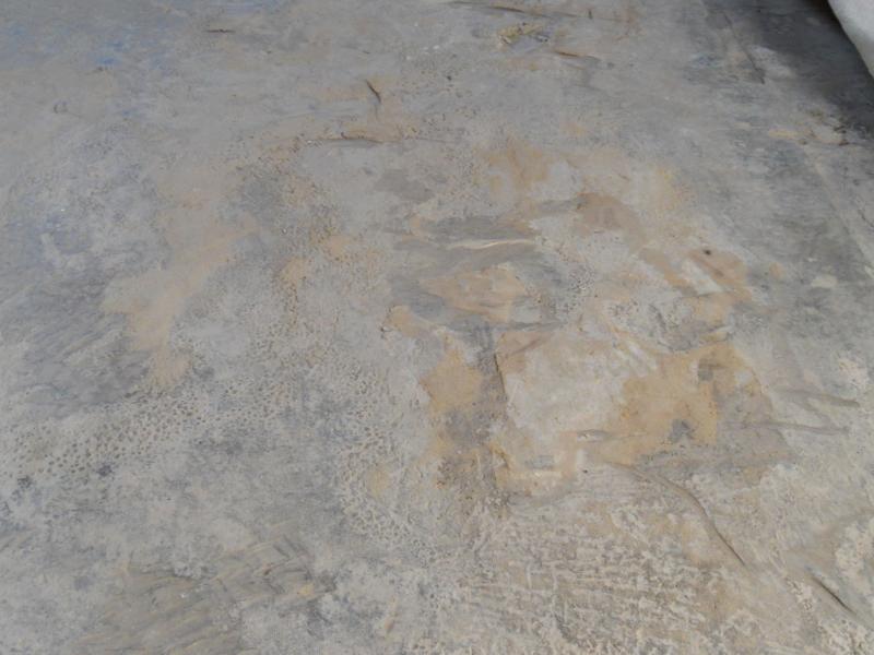

Don’t just expect to pour on the SLC & walk away; it needs some encouragement with a float. It looks a bit raged in places; as I said before, I would advise you go over the lot after filling the 20mm section rather than just patch it.
its an l shaped room richard the main part kitchen/dining room is approx 6 x 2 metres & the other part return leg measures approx 2 x 1.5 metres and is more of an entrance walking area into the main kitchen all open plan though i will try upload more pics of it all to give you a better idea,yeah i have a float to spread it..do i mix 1 bag pour it on floor spread it then do the same with the next bag or do i mix several bags at once ? + is it a 2 man job would i be better with a helper

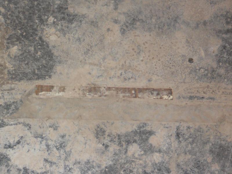

the floor is very ragged in the middle im still scraping the old seems like 2/3mm plywood or something from yrs ago up...nightmare tbh been doing it most of w.e :eek:
