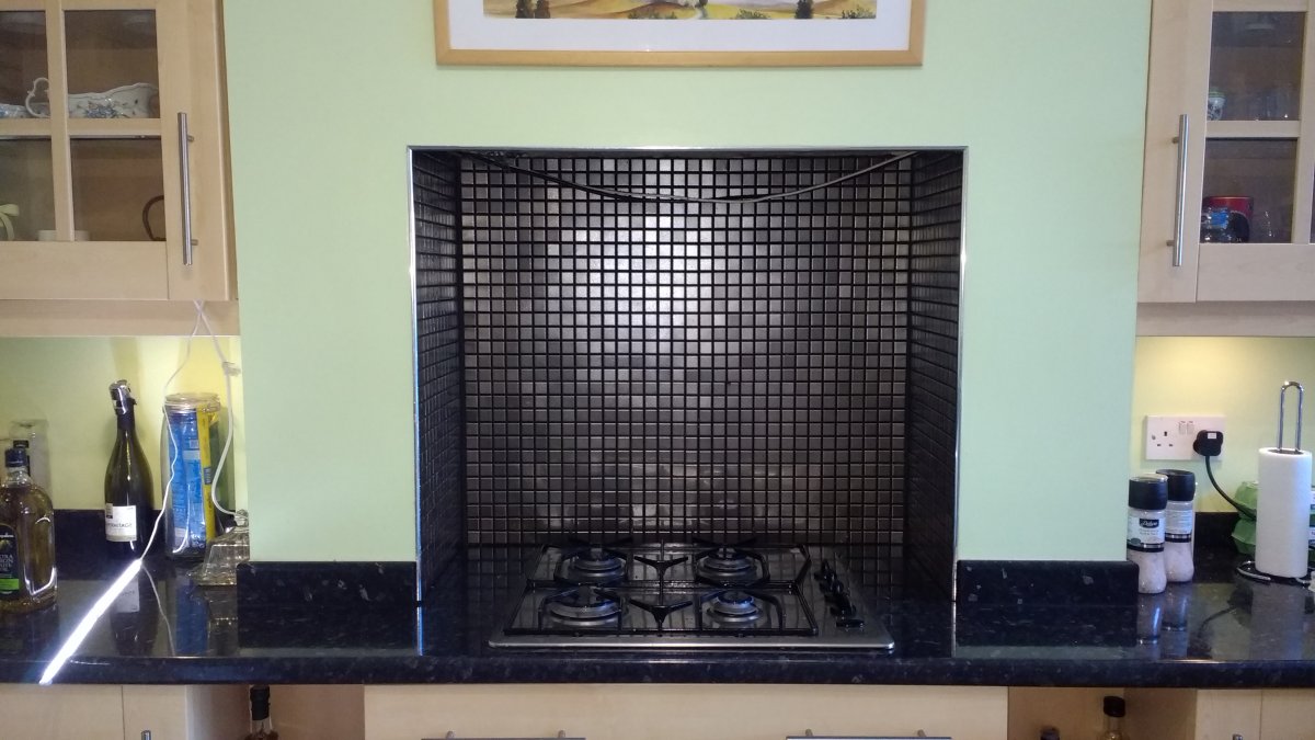

In my kitchen I have a gas hob that was fitted in 2003 along with the works to create the alcove the hob sits in. Its fitted into an old chimney alcove - see the attached photo.
I need to change the hob for a new gas hob and also will be renting out the property thus will need a landlord gas cert.
The existing height inside the alcove is 716mm, 850mm wide, 340mm deep, 140mm gap either side of hob. There is no combustible material on the side or above.
I understand there is a minimum clearance gap of 760mm above a gas hob in the regulations since 2009 but reading the regulations it always seems to says the clearances are to combustible materials. Would this affect me getting a landlord cert as the work was done pre-reg changes and whilst I have less clearances they are to non-combustible materials?
Can anyone offer advice on the above.
I have considered changing the hob to an electric one but there is no suitable electric supply near the hob.

The Gas Check for letting is a snapshot view of the installation.
In spite of what a few gas guys may say, they should give you the Certificate regardless of what they find unless anything is very serious and classed as At Risk or Immediately Dangerous.
Those clearances when to non combustible materials are classed as not meeting the maker's requirements but in most cases are certainly not serious enough to be rated as At Risk so should be noted on the Certificate but nothing more.
There used to be a lesser classification of Not to Current Standards but this now has been withdrawn.

Check the manufacturers installation instructions for your new hob - they may give smaller clearances and they override the regs

Wrong, Tony. The cert should be issued regardless of the severity of issues. I would expect the topp 100 RGI's to know that.
NTCS is there, but there is no REQUIREMENT to inform, and must not be entered on warnong notice. Personally,I always inform on the job sheet/invoice

Are there any signs of distress or scorching to the cabinetry? If not, it will be regarded as Not to current standards (NTCS). Your RGI may or may not record this on the paperwork, but the cert should still be issued. As Tony, says, it is a "snapshot", not a certificate that all is 100%. You will not tnee to alter anything if it is NTCS.
It might be a good idea to check with the RGI that he will issue the LLGSC, regardless of his findings (as he should).
If you post your location, you may find a good RGI here. Someone islikely to repost it in the section for RGIs only
