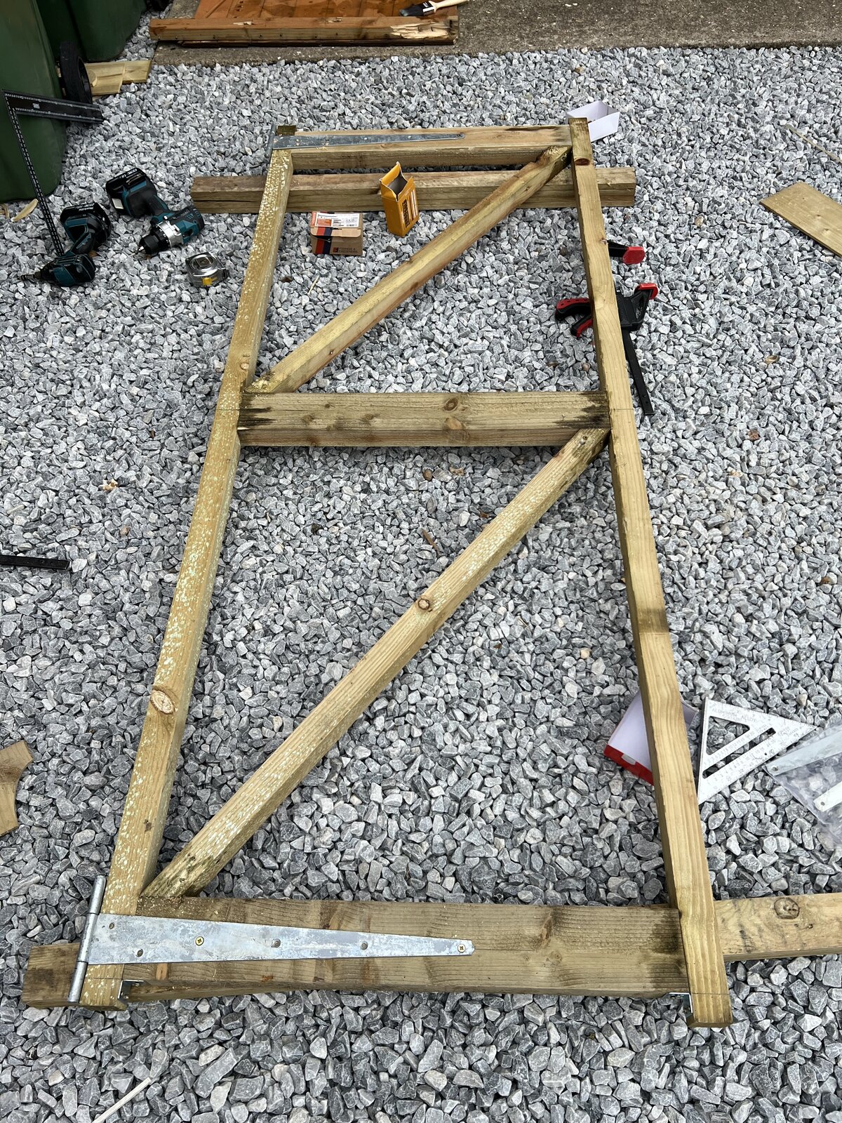

I am building a garden gate using this framing design (apologies for the poor image) and had a couple of questions please.
- I am lining this with featheredge boards (like I did previously). Do I need to fit tee hinges and then cover with the featheredge boards or is there another way to do this?
- what clearance should I have between the gate and frame to allow for expansion/contraction?
Thanks for your help.
If the hinges are outside, you could fit them first then cover with featheredge.
I've never done it, but if I had to do it I would use stainless steel screws coated in grease as they won't be accessible.
Usually garden gates open inwards.
I leave 25mm clearance at the bottom and 10mm at latch side.

Should I also leave 10mm on the hinge side?
There will be a natural gap there, but yes, leave 5-7 mm.
Make sure your screws are on the meaty part of the wood.
keep in mind any cladding you put in front off the pivot point [front face off the gate] may reduce the amount the gate will open if it opens outwards

A bit difficult to see, but what is the angle of those braces?
