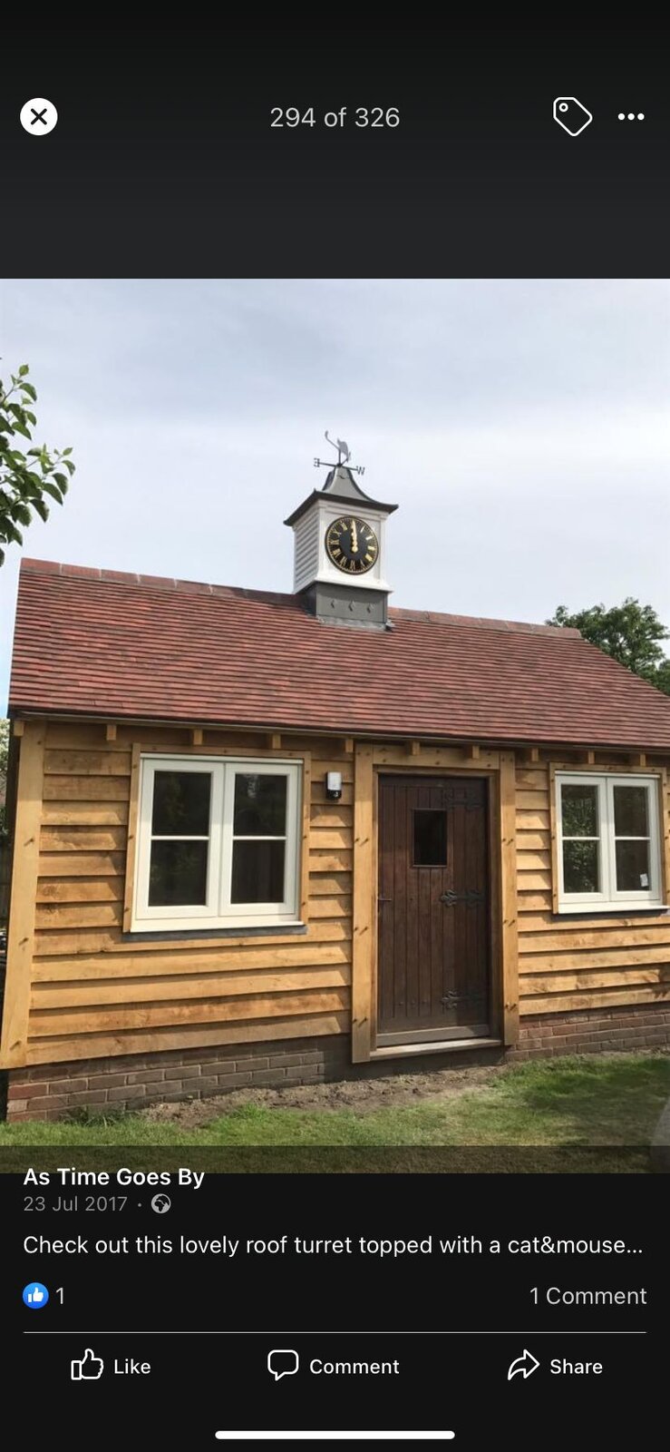

Has anyone fitted a clock tower on a roof before like in the pictures attached?

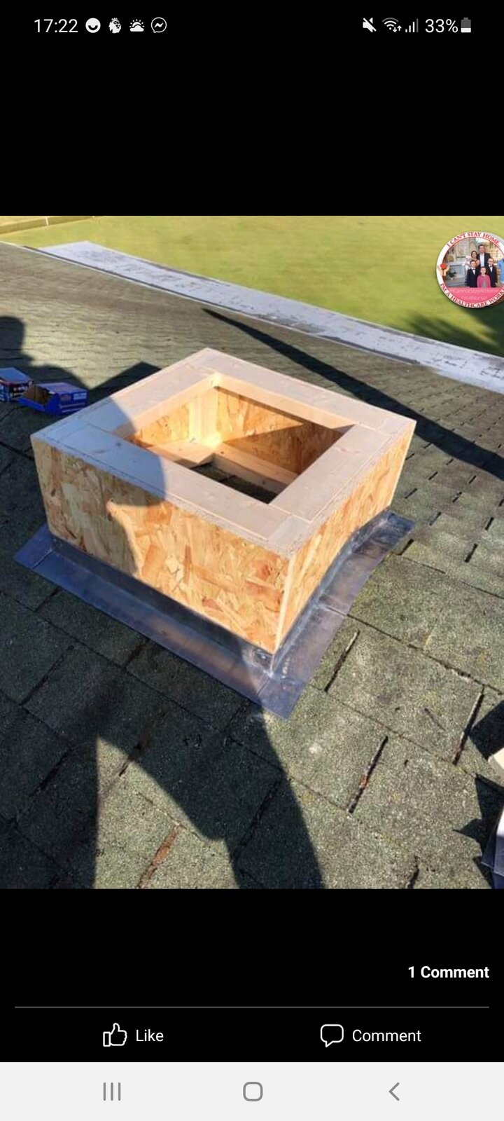

One pictures show a base made on a roof but how is this attached to the roof tiles?

You treat it the same as a faux chimney and it doesn't sit on the tiles either. You'd trim around or prepare the rafters so that they seat the base of the structure footprint and that structure would protrude vertically upwards enough so that it is clear of the roof tiles by 150mm or so. You'd then tile and flash the upstand then add your clock tower later complete with weathering collar that laps over your upstand flashings
