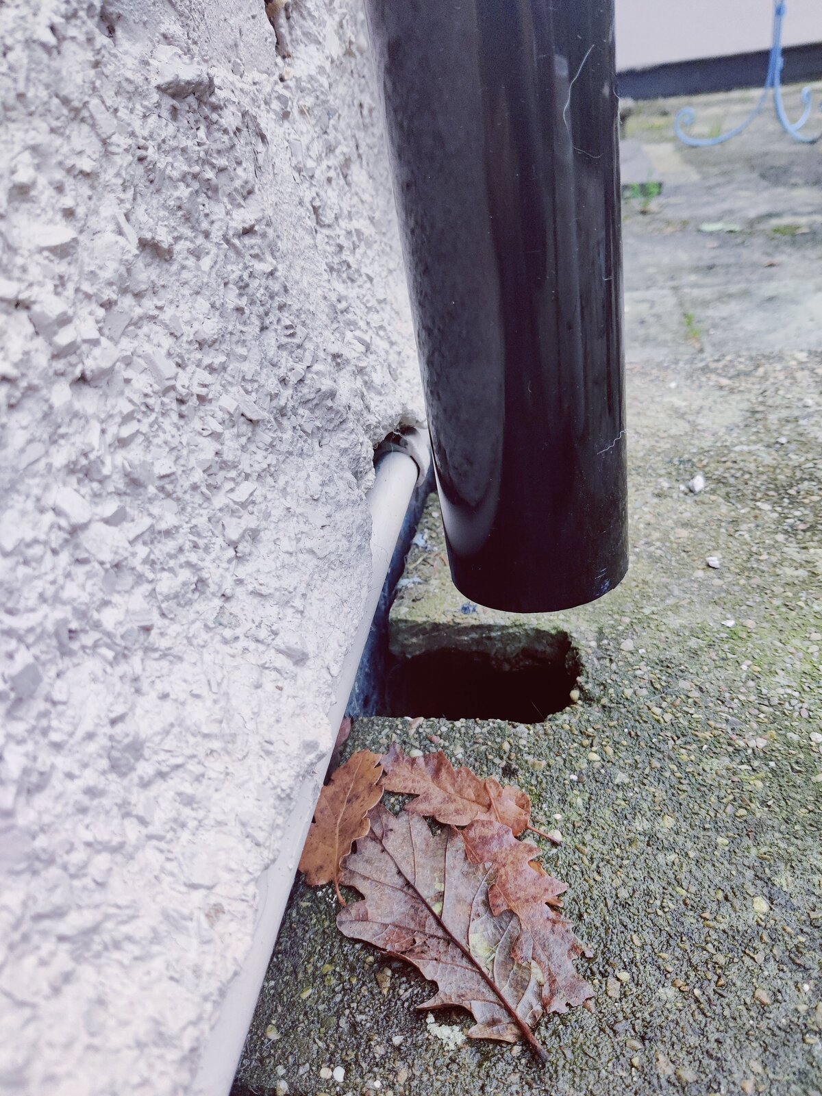

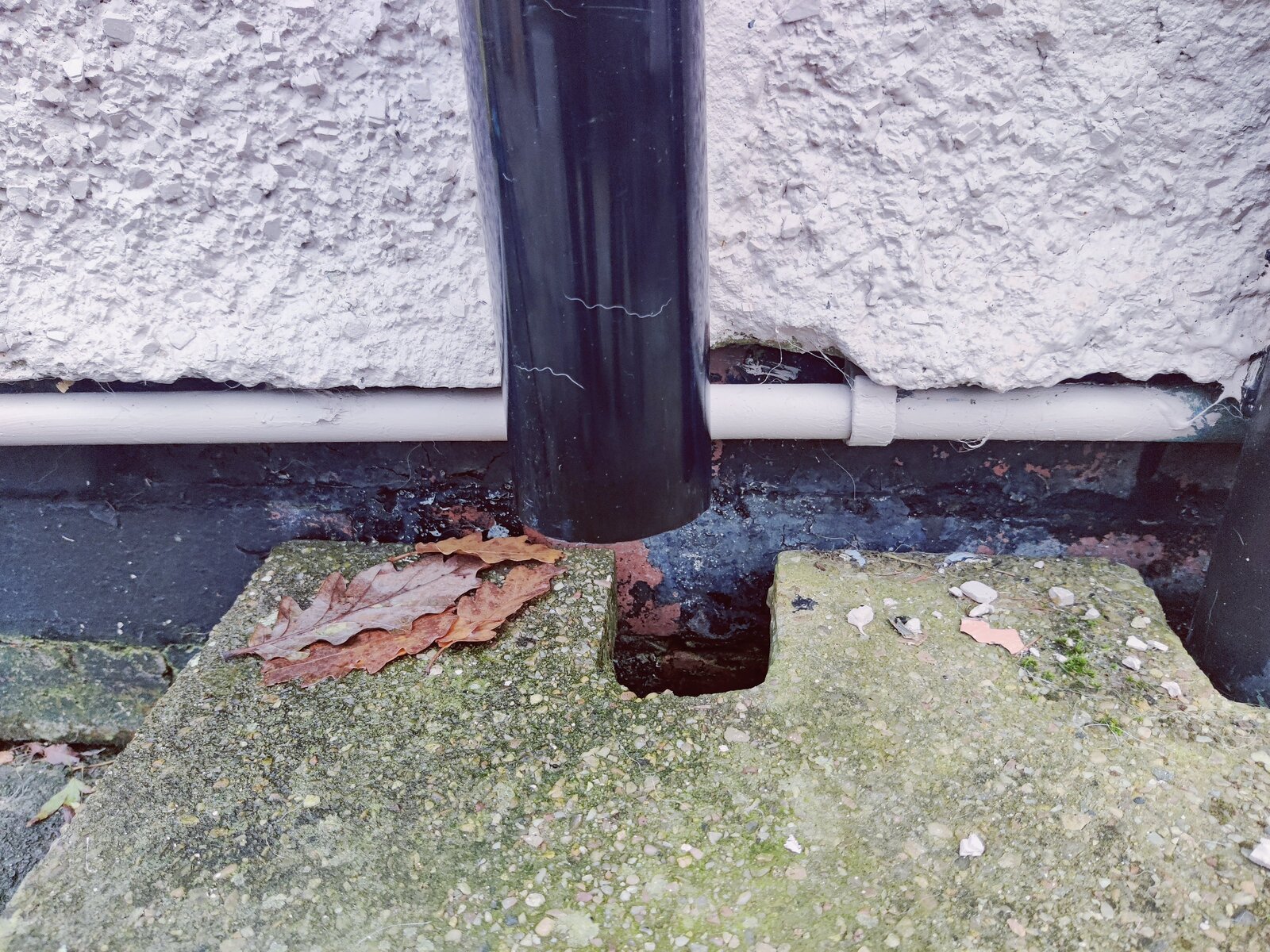

The downpipe from the roof has been reinstated to its (almost) original position but it doesn't quite line up with the drain (and the cover). Is it going to be possible to correct this with standard fittings? The pipe is 70mm.
I thought perhaps there might be a flexible fitting, but I can't find one.
There is another downpipe in to the same drain (out of shot) so I can't just move the cover across.

Would fitting a DP shoe work?
