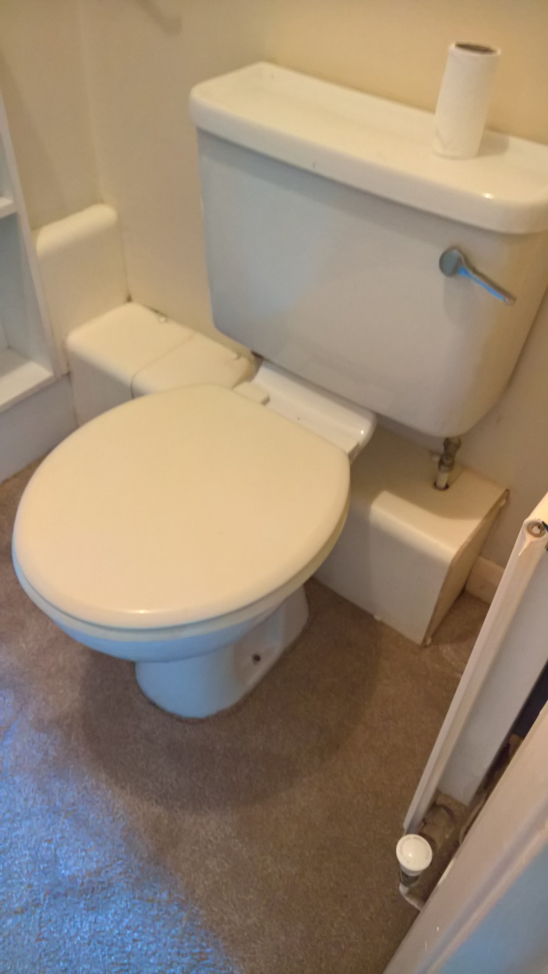

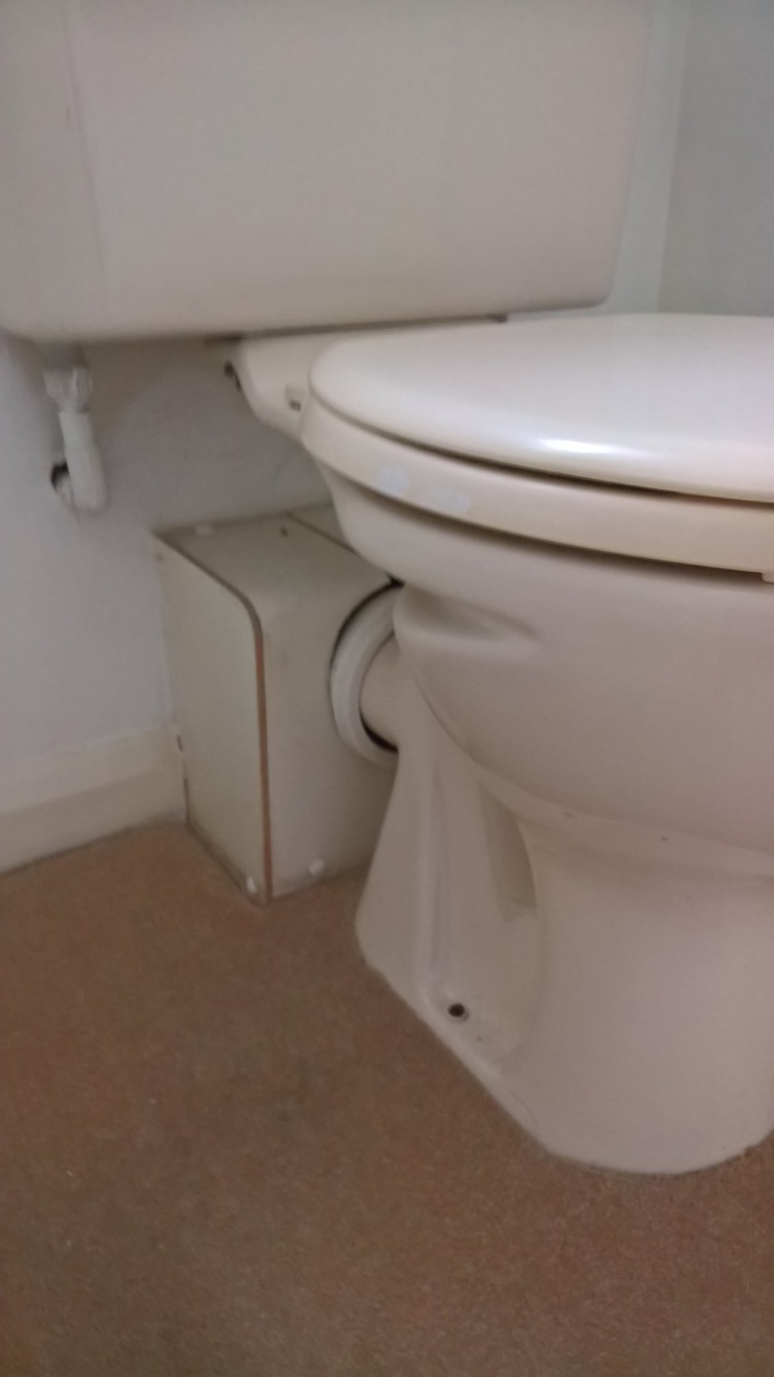

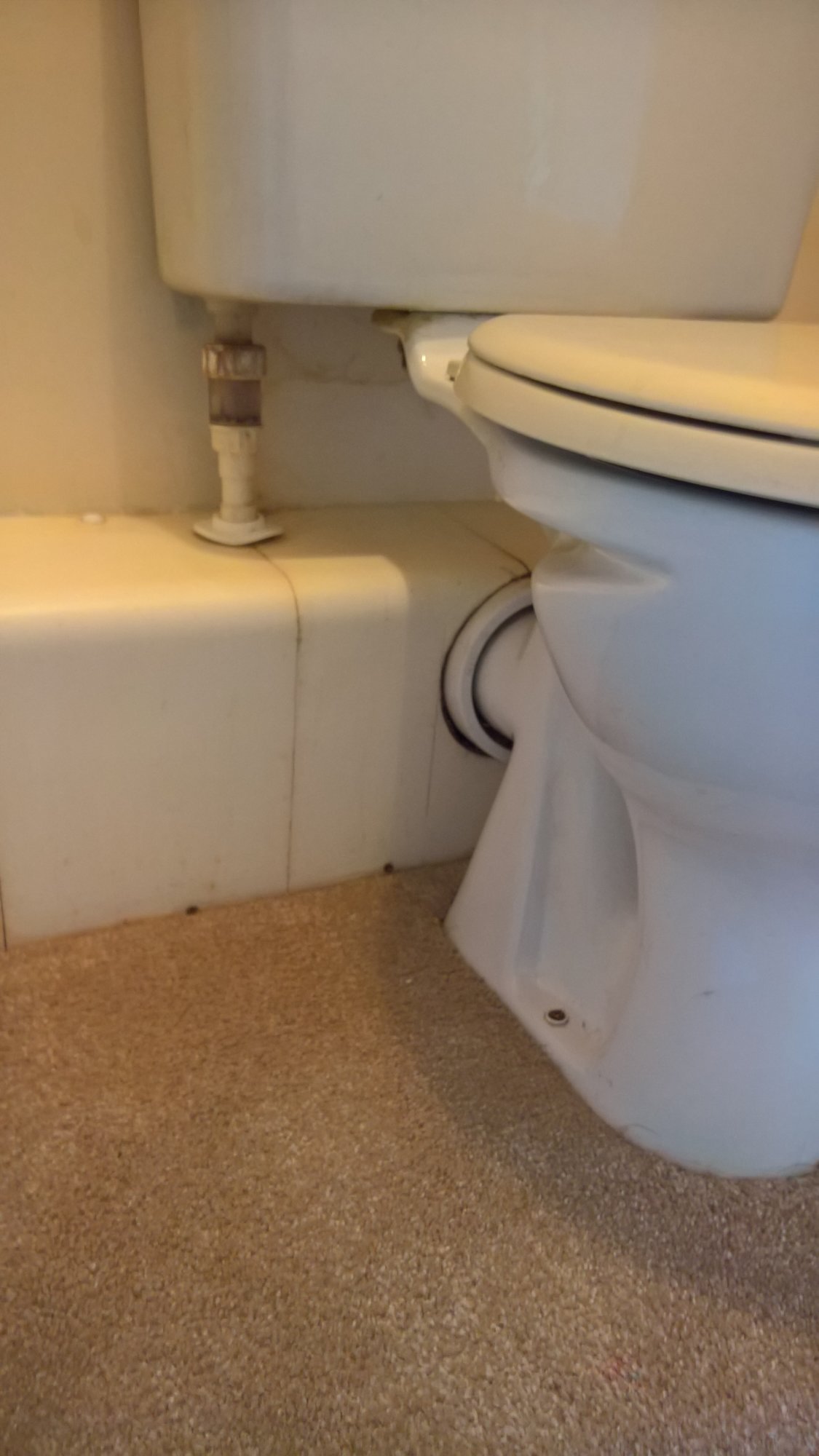

Hi, They won't work though will they as there isn't enough room at the back of the toilets to accommodate the pipework which goes horizontal?
Will on first photo.
For others you'll have to resort to boxing and perhaps put a concealed cistern in a furniture unit with a btw pan... unless you can reroute waste branch to underfloor or exterior!
