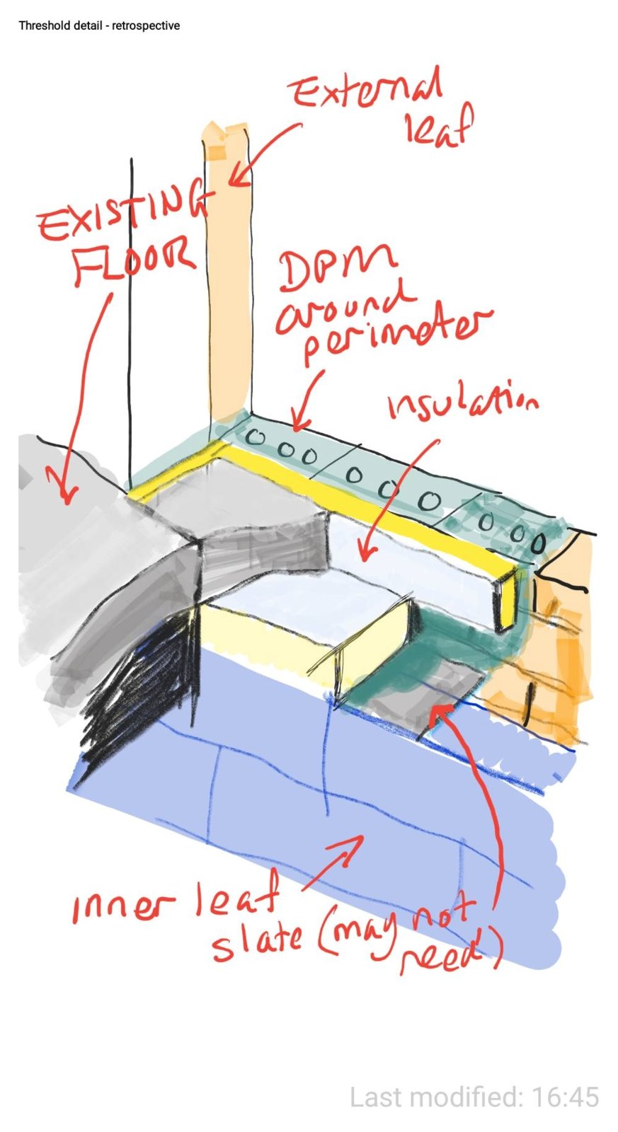

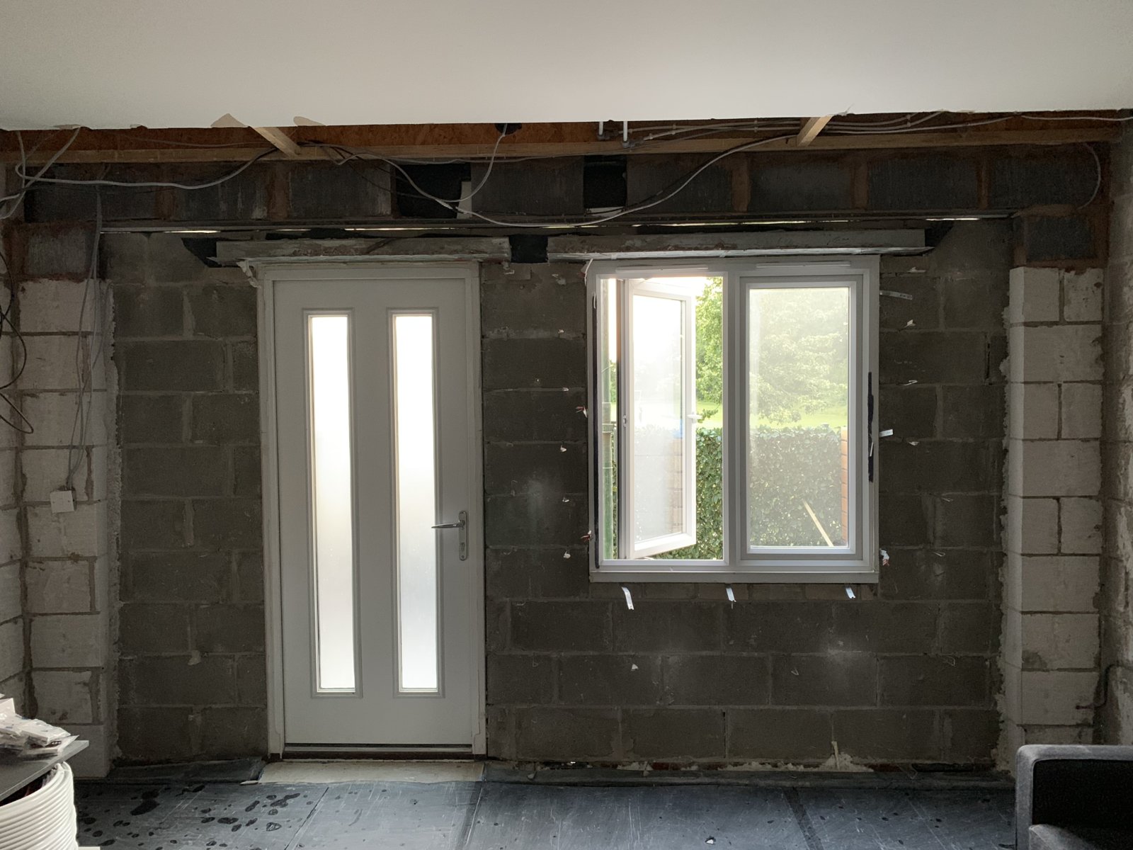

What’s the proper way to close this floor cavity? I’m taking out the outer leaf shortly to fit aluminium sliding doors that will be cill less sitting on the outer leaf. They will be flush with the internal and external floor.
The door frame is only 115m wide so the cavity gap needs closing before UFH and tiling.
Floor is block and beam and screeded over.
