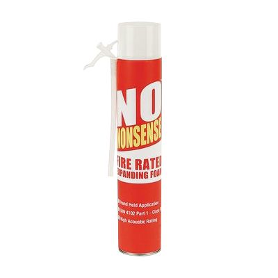

Hi all BC said 'top up cavities and fit closers'
My issues is the gable wall.
The bricks/blocks are rough arsed so cant use the plastic tray with foam attached.
Could use the sock style but cant get them today.
Was wondering about expanding fire - specifically fire rated.
Fire rated and seals against smoke and gas which to me means air tight?
Anyone had experience with it?
TIA
Insulation normally just stops level with top of masonry and battens and membrane cover it, unless somethings changed? You’d only fit cavity closers around windows/doors/internal breaks in the cavity
