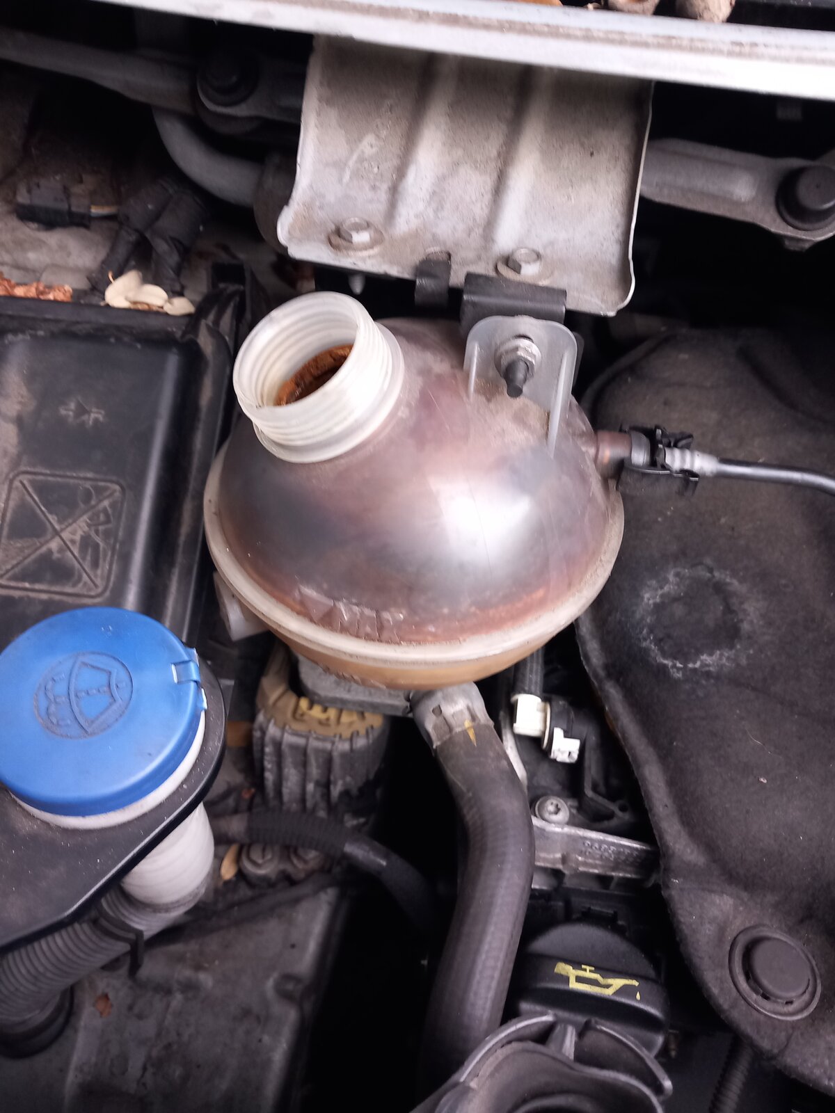

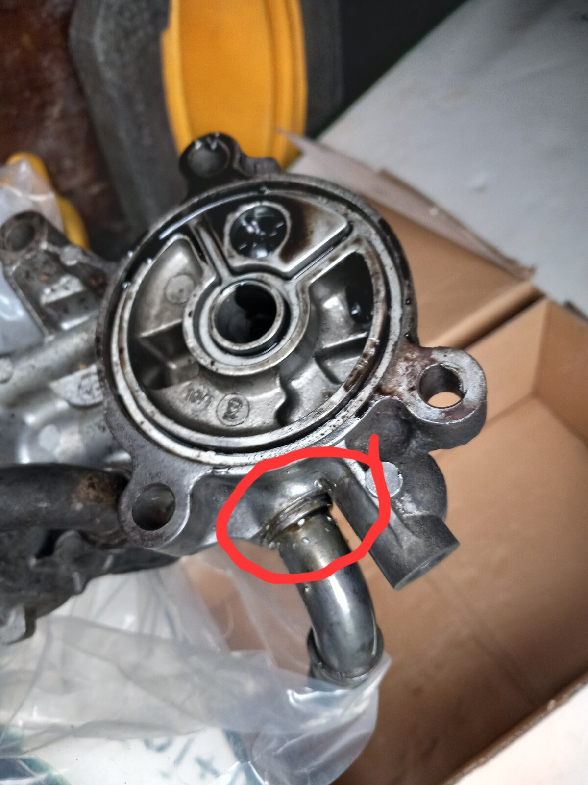

So they changed the clutch then found a leak in pipe in the housing. Changed that but water in the expansion tank keeps dropping. Also there's black foamy gunk in there for cooling and they think someone has added additive like stop leak or is it oil? The water level dropped in the header tank while I worked came back at 2pm and nothing in there. Topped up again and hour later water had dropped again a bit.
Young mechanics. Should I go elsewhere? To my old trusty mechanic.
It's in the mechanics now checking for a leak.
He's asking about the cam belt and water pump.

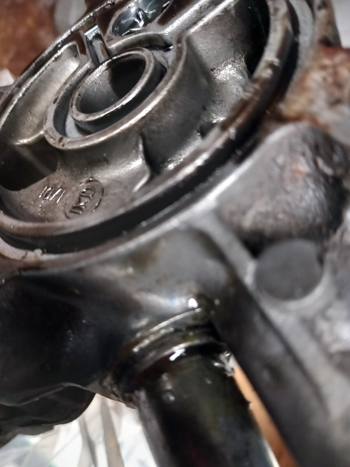

Are we looking at part of a liquid cooled EGR system? That could explain black gunge in the header tank.
As for the Peugeot van, if the timing belt has that sort of mileage, it is on borrowed time for sure!

I'm off to pick it up. They're saying water hasn't dropped this time in expansion tank. They did a test on the headgasket and there was some yellowish in it but it was inconclusive that headgasket was definitely leaking.
I dunno if it's a liquid cooled egr system.. it's a 2litre peugeot expert 2013. I can dm you the reg if u want?
I haven't got the money to buy a newish van only £1000 left in bank Account.
To be honest with you, I can’t actually identify those parts but maybe it’s part of the EGR system or maybe an oil cooler.
