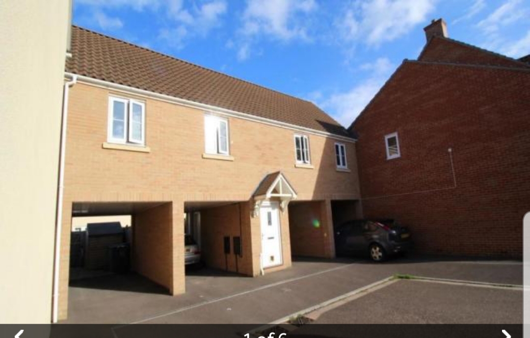

I live in a coach house (or FOG as also known), built in 2010 by Barratt Homes. It has 4 carports beneath.
I am considering upgrading to a larger aquarium, either 240 or 325ltr but I am very anxious about the weight on the floor (currently have a 185ltr plus 2 smaller tanks). Weight of a 250 tank is around 500 lbs and 325 tank is about 700lbs. Plus the stand etc etc. The 250 tank is a little over 3ft in length, the 325 is just over 4ft.
Part of me thinks the floor must be pretty robust as it supports the whole weight of the house above it, but still....
Basically : the builder cannot give me any information about construction or materials used. (Lost the plans, apparently). If you stand in the carport and look up, all that can be seen is what looks like a white plastic covering. From inside, the only area not covered in carpet or laminate is in the hall cupboards: you can see there what appears to be concrete.
Recommended placement for a tank between about 55 and 125 gallons is next to a load bearing wall, perpendicular to joists to spread the weight as evenly as possible. Problem is, I have absolutely no idea whatsoever whether I (a) have joists or not, (b) where they run if there are any, and (c) what would be above them in terms of the subfloor. So I don't know if I'd be spreading the weight, or not.

Yes, the carports are ground level. Please see the attached picture.
No, unfortunately not. The two areas where the floor seems to be concrete are in storage cupboards in the hall. I would be putting the tank in the lounge. I have no idea at all what is under the laminate floor in that room. Would joists have been used for this type of thing? If so would they span the length of the property, so running over the carports for support, or the width, so effectively open space? Something else totally different?? Just concrete? No clue.
I've tried the builder. I've tried the local council. I've waded through the property covenant in case that said something.
Re picture of the property, the lounge is to the right of the front door and stairs leading up into the house (ie the two partly in the shade). The two windows on the left of the door are the bedrooms.
At the moment, the 185ltr is placed in the corner formed by the wall where the stairs are, and the external wall where the window nearest to the front door on the right is.
This is where any new, larger tank will need to be placed.
As you can see the house is supported by the carports, ie the four brick walls so the floor must be pretty robust as it supports the whole weight of the property?

Your floor is almost certainly block and beam
domestic floors are usually designed on a live load of up to 1.5Kn/M2
bear in mind that calculations are to do with deflection rather than simply when the floor will collapse!
loads at midpoint -ie in the middle of the room will create far more deflection than against the side of a room which is close to the end of the beams.
I would think it will be fine, just dont call me if you end up in the car park below!
not as such: the the brickwork is supporting the weight of the house -and that is sitting on steel beams.

All of the FOG units Ive built have had concrete plank floors, the planks being 1200wide x 200deep and running from back to front
