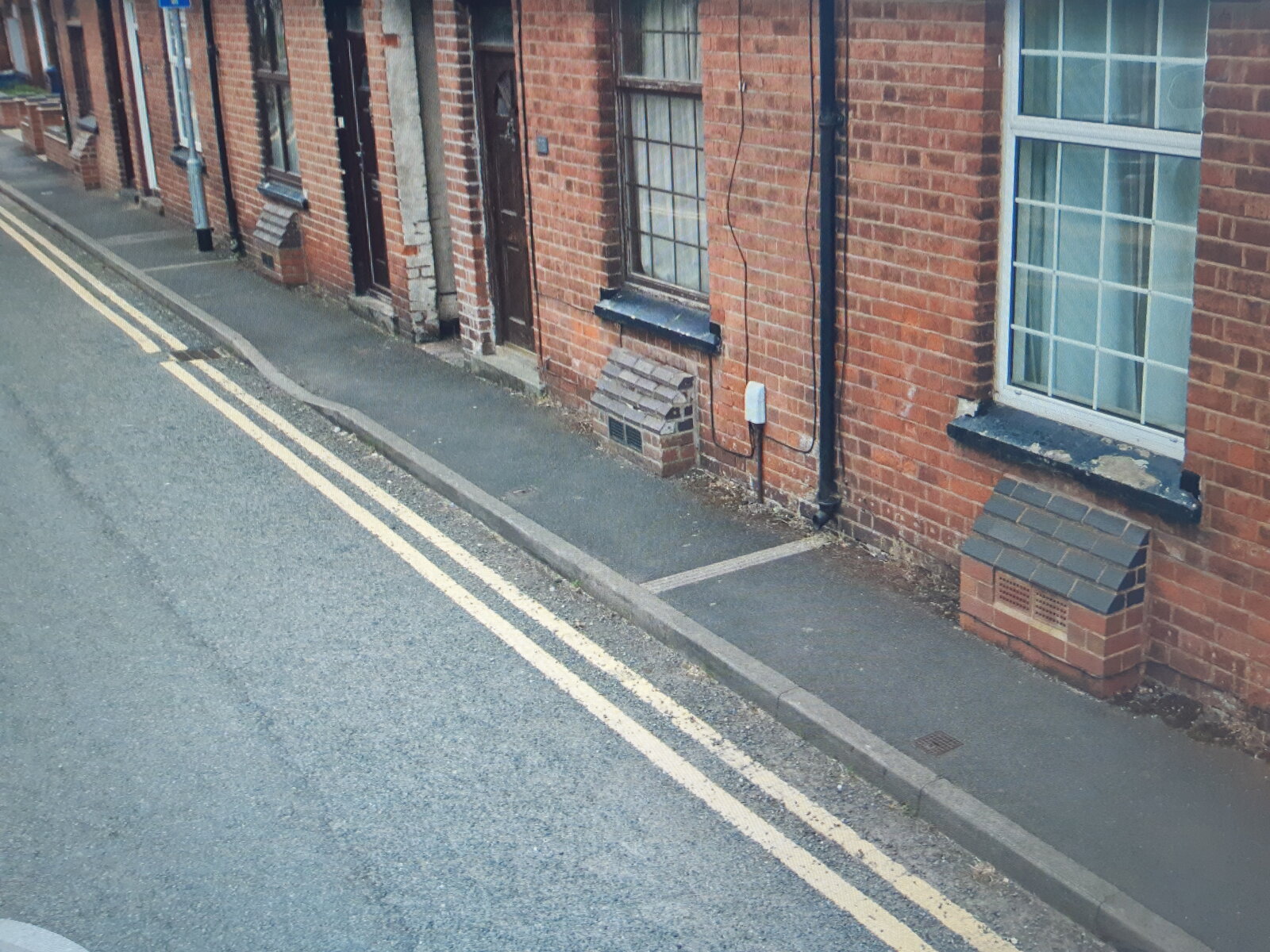

Cellars/basements are inherently damp spaces. All the ventilation in the world won't change that. The best remedies I've seen are those that have a dedicated brick structure covering them with airbricks built in etc. The 'roof' was built using reducing plinth blue bricks.

A brick structure covering the chute entrance you mean?

This looks like a good solution thank you. We actually still get coal delivered through the hole as we have an original fire in the living room so this has given me the idea of just building a small brick structure with the hole still in and then placing the cover on that, so we can put the airbricks in that structure.
